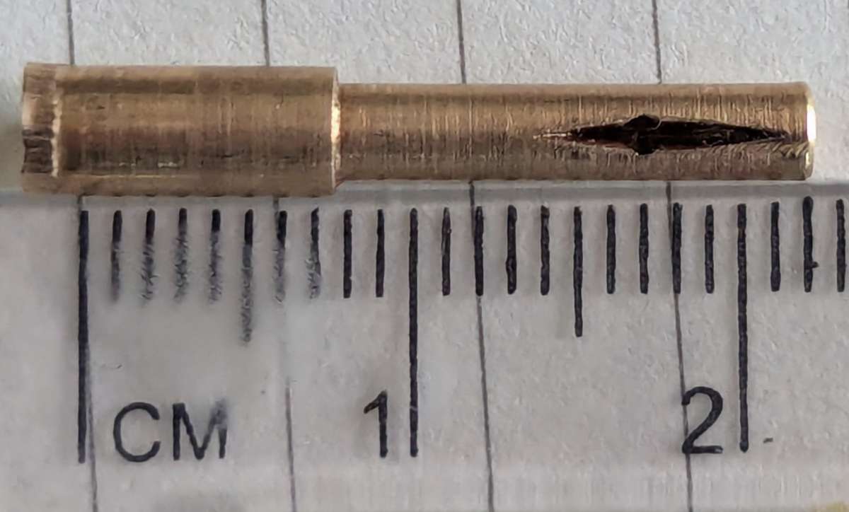

      I’m trying to replace a spray bar in an SC 108 glow pug engine. Most of the job is pretty staightforward, but then there’s a boat-shaped, or cat eye-shaped slit centred around a cross-drilled hole that I can’t easily replicate. I tryed whittling down a dremel cut-off disk, but that doesn’t produce the desired result. How are these slits produced? Is there a way of acheiving the same results at home?

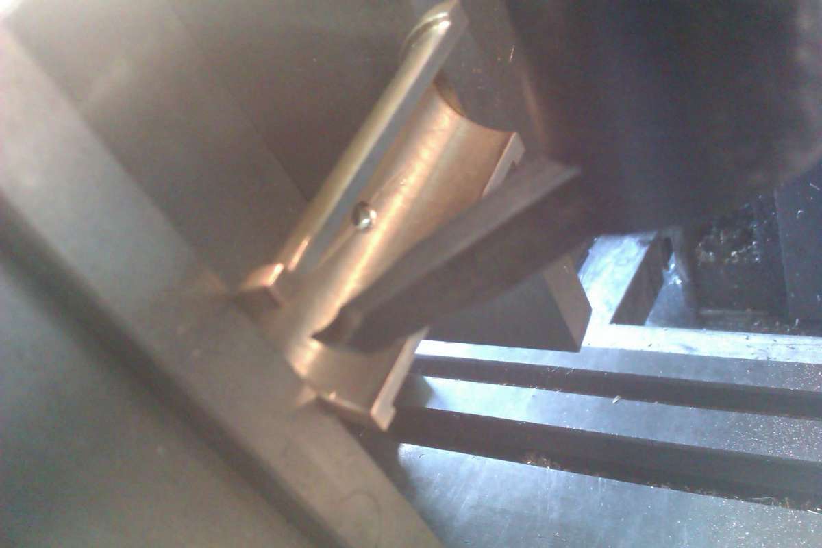

        Before you machine the spraybar, you could cross drill a hole in a bit of bar, deform the bar to close the hole up and then machine the bar to the spraybar drawing – OR
        Use a very sharp Swiss file and file across the bar. If the “eye” is longitudinal along the spraybar, make up a boring bar and use a piece of HSS or hardened silver steel with a sharp angled point on it, support the spraybar in the lathe crosswise to the boring bar etc etc.
        #748772

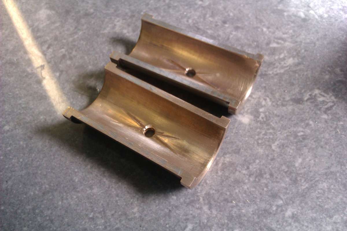

          As Speedy says a sharply pointed tool held at right angles in a bar and then use that as a cutter. Not my best photos but similar type slots in a bearing
          IMAG2622
          IMAG2624

            In retrospect, a picture might have been helpful – the narrowest diameter of the spraybar is 3mm, with a 1.2mm hole through. The ‘fuel control rod’ which is co-axial with the rotating throttle barrel pulls from left to right as the throttle opens, finishing about the centre (where the hole is) as full throttle. I don’t really understand the ‘theory of operation’ of this slit – the part to the right of the hole seems redundant as it’s never exposed.
            I wonder whether I could just chain drill some holes of diminishing sizes and join them up?

                    Nope, it really is the original spraybar! I can vouch for it as I’ve owned it from new. I misunderstood how it fitted in the carb, which was completely seized up after a decade of neglect – hence it’s missing the flange at the left hand end. Oops.
                    How would a single round cross drilled hole work with the sliding fuel control rod? It seems like that would just give an on-off control to the fuel, rather than steadily increasing the amount of fuel as the carb opened? I can see a row of holes perhaps working, each one allowing a bit more fuel in as it’s exposed?

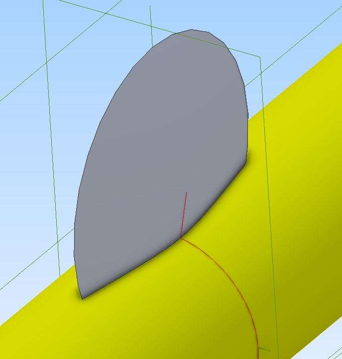

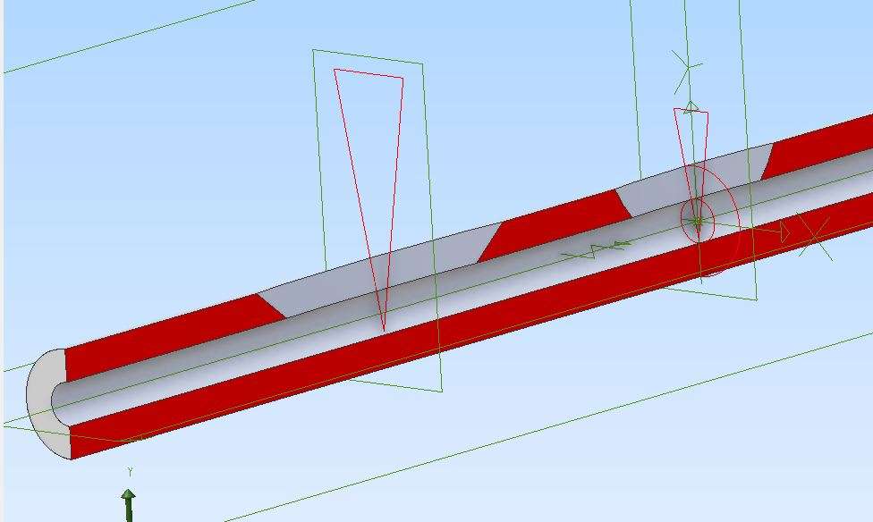

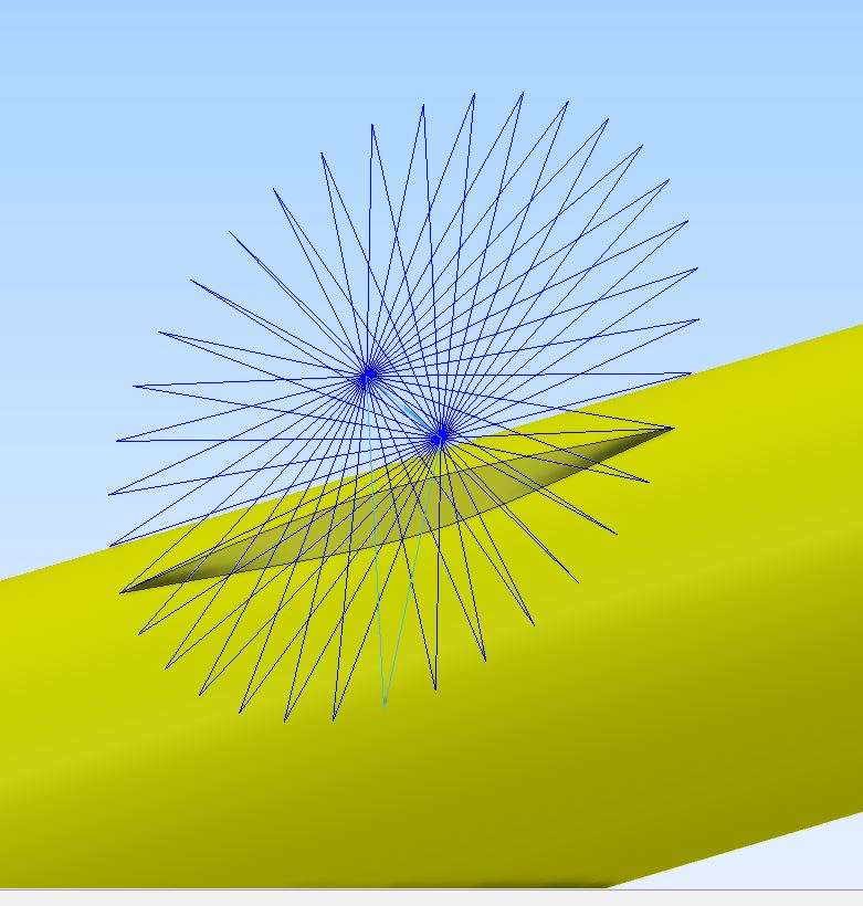

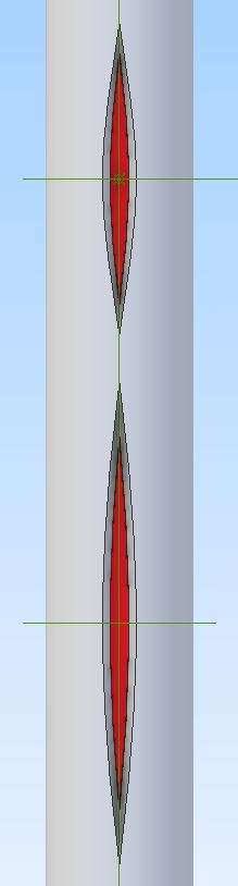

                          Just modeled it in cad and for the size of the part you are looking along the lines that Michael suggested but it needs to be quite a sharp Vee profile so probably best to turn one from silver steel and cut a few teeth in it.
                          This is 3mm dia with the cats eye cut
                          cat1
                          The rotated triangular profile that cut it
                          cat2
                          And in solid

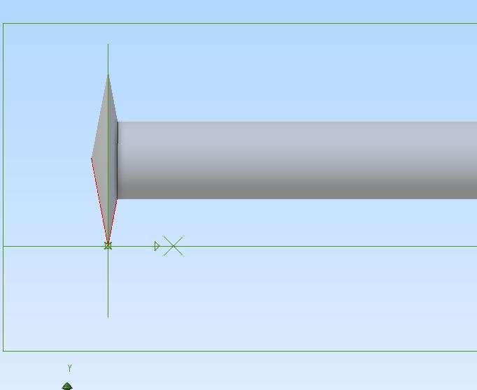

                          cat3
                          Which can be developed into a tool about 6mm dia head and 20deg included angle, shown in section. Shank needs to be a bit smaller than I show or at least necked down just above the business end.

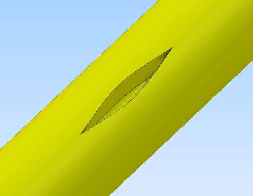

                                  It probably needs to be a lot smaller than 14mm dia, not for clearance but to get the width/length combination about right.
                                  If the shank on the Busch ones is 1/8″ then you probably want the 070.
                                  Cross section of holes produced by 7mm and 14mm cutters, the 7mm slot is 6mm long and about what it is in the photo, the 14mm slot is 10mm long.
                                  slots
                                  I have coloured the inside of the tube so the hole is easier to see, changing the included angle will alter the width relative to the length.
                                  cat5
