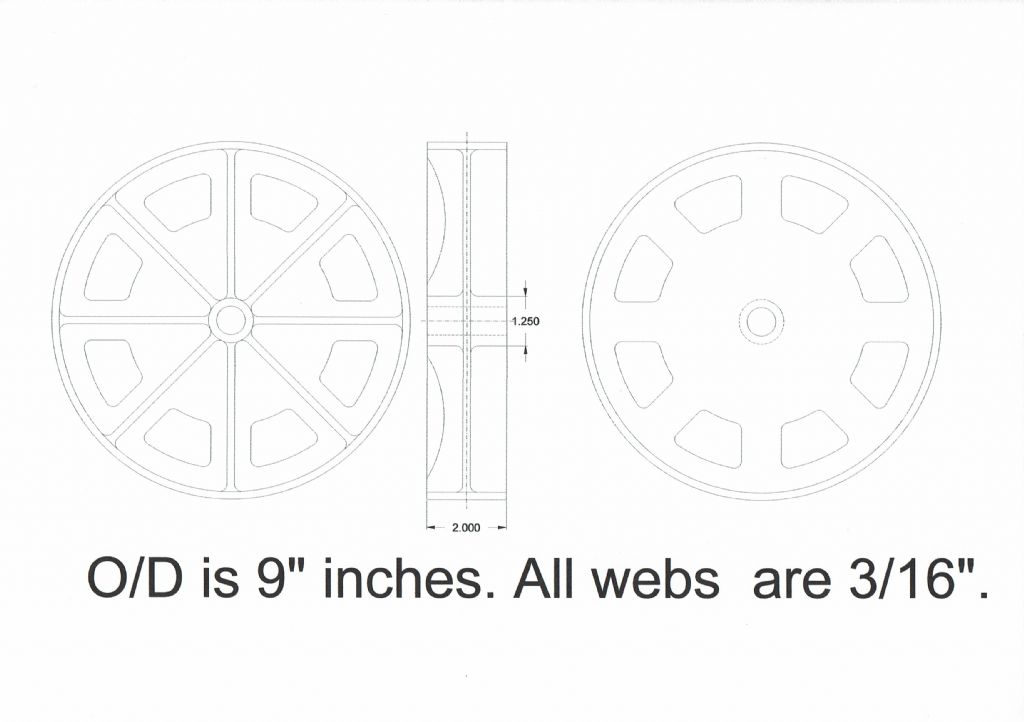

      At some time I will need to make a pattern for C.I castings. Now I realise that my question is a 'how long is a piece of string' type but I'm wondering if it will be possible.
      The casting is 9" inches dia with 8 off webs around a 1 1/4" dia centre.
      The webs need to be 3/16" thick. Will that work or do I need to look at fabrication?
      Brian

          3/16" should be OK in iron, have you got a sketch of the actual part ?

            If the webs are cast they will have to have a draft angle for withdrawing the pattern, they cannot be parallel.
            Paul.

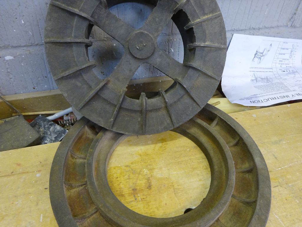

                  In the mean time I have just dusted these off which I think are similar to what you describe, they are the two parts that make up the winding drum for a 2" Superba Ploughing engine and are about 12" dia. The webs are all cleanly cast with a very slight draft angle and I would say 5/32" thick on average.
                  The alternative would be to get them laser cut or mill them yourself from steel sheet and stick them together a bit like the one at the bottom of this page

                    Those casting look very good Jason. Many thanks for your time on this.
                    I've managed to do a rough drawing of my project which is a hind wheel for a Fowell-Box patent traction engine (when I finish my Burrell-Boydell).
                    I made one of these some years ago and still have all my hand done drawings but I want to make this new one in 1 1/2 inch scale.

                      Its amazing how much information is in a drawing. At first I imagined something like the cooling fins on an air cooled petrol engine. (it is said that a drawing is worth 1000 words).

                        Looks to be something that can be cast but finding a foundry to do a good job of it will be more of a challenge.
