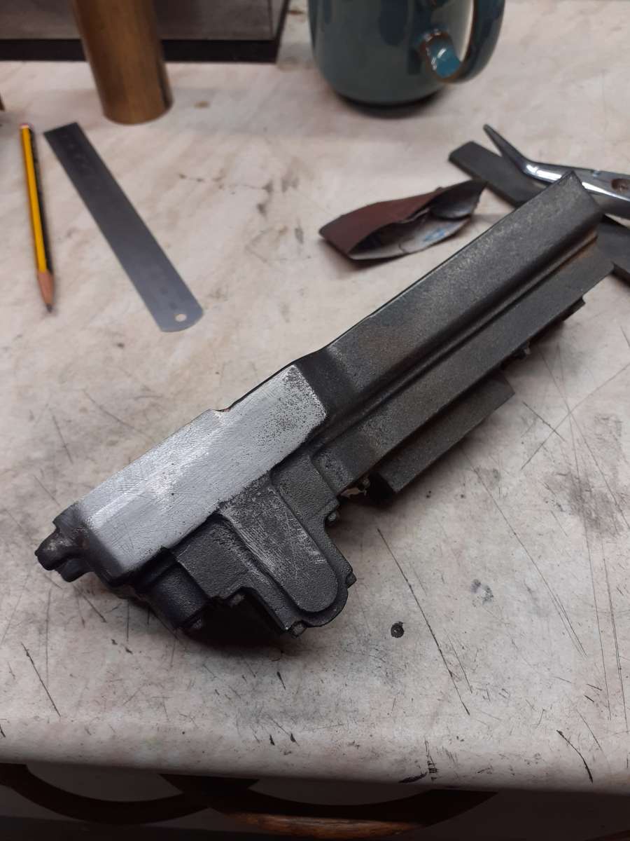

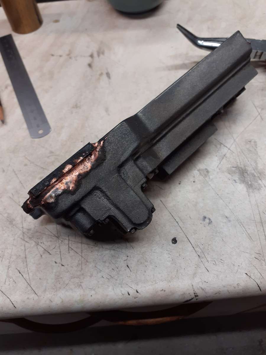

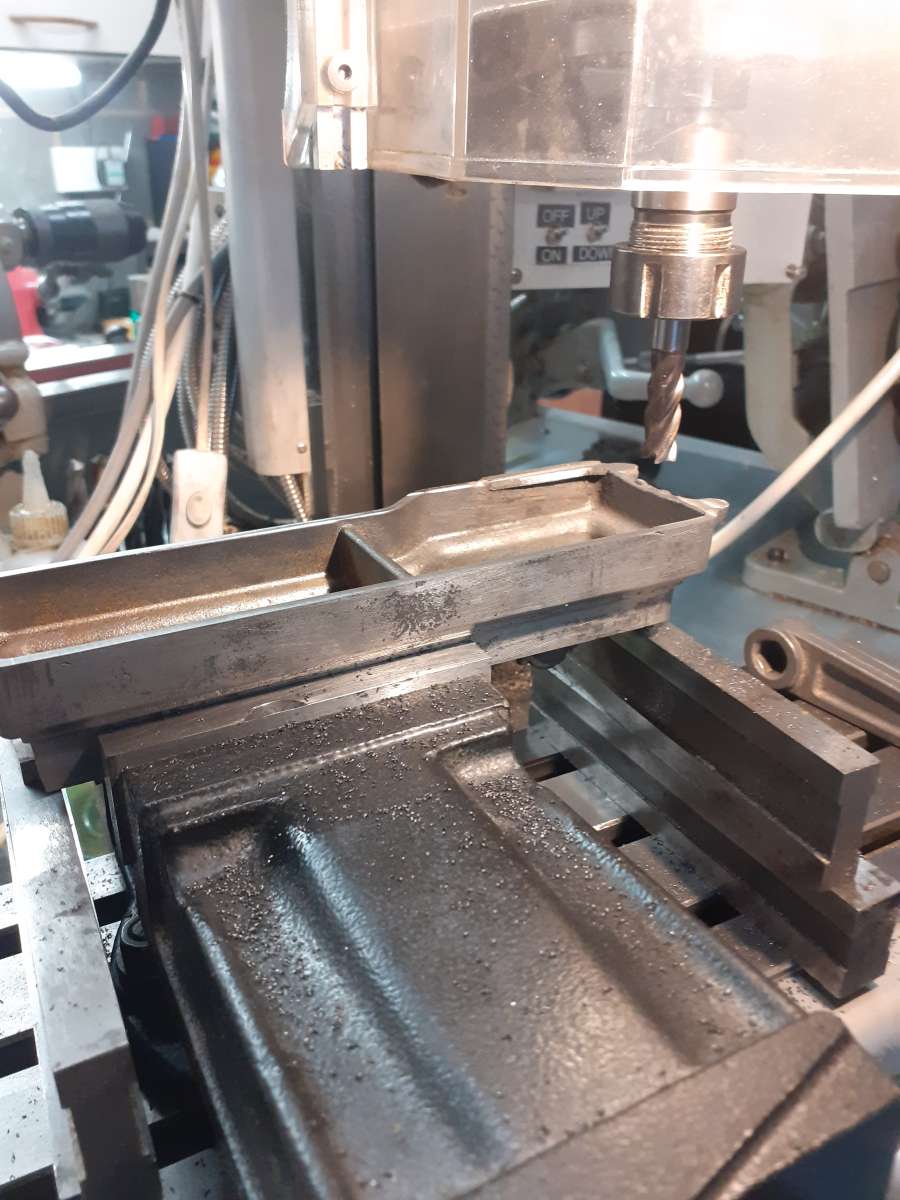

                hi I have repaired a casting which came with metal missing and had no problem inserting a piece and machining it after so it was not visible after painting. I cleaned up the area flat on the mill, machined a piece to fit with a small overhang each side and plus metal on top so it could be finnished to size after brazing.

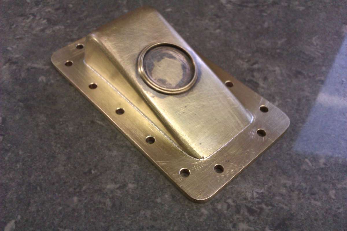

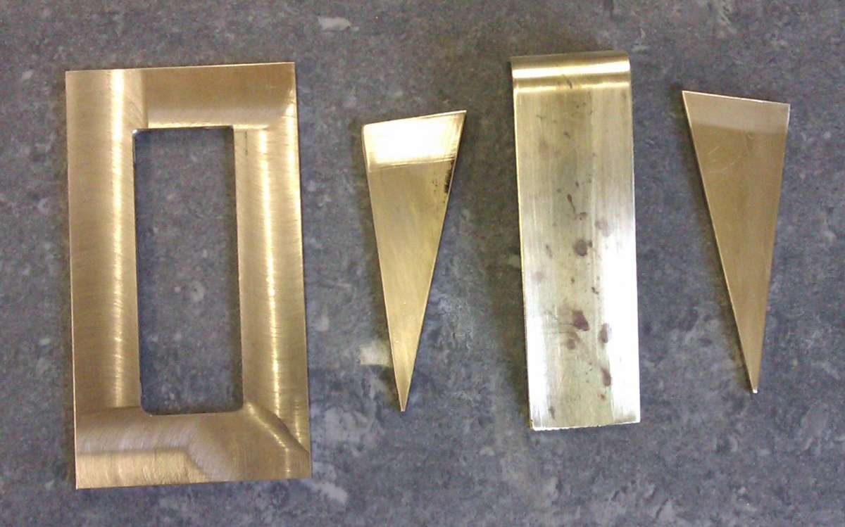

                                #718212
                                  I found a photo, it’s only a “box” with a flange around it. rather than faff about with the replacement castings I’d send them back and either cut from solid CI or fabricate it from bronze or brass. easy to silver solder and no rust issues. Bit like this which is the same sort of size
