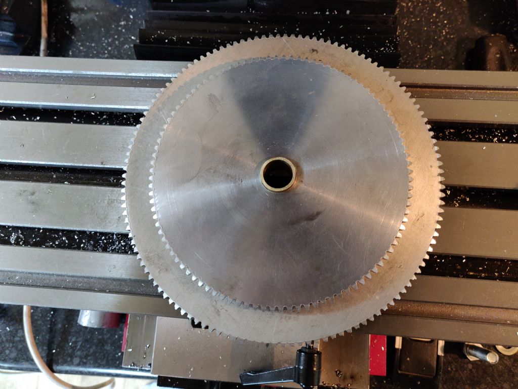

      I have set myself the task of making a 127/135 compound gear for my Boxford and am considering material selection. I think the existing change gears are cast iron and I have been advised that SG(GGG40) would be suitable. Two questions before I order: can anyone suggest a more economical alternative (some grade of steel plate maybe?) and if it is to be SG what are my chances of getting two 3/8" thick gears out of 1" of round given that I don't have a bandsaw or powered hacksaw?

          Changewheels shouldn't be under a lot of stress so you can use tufnol sheet, maybe with a nice brass hub. Delrin is another possibility, or some reinforced plastic and of course aluminium.
          Steel, ordinary mild type is best avoided as it will be far more wearing on your cutter and will be noisy in use, especially a large one.
          Is your leadscrew metric? As far as I remember the 127/135 combination is to do imperial gears on a metric lathe. 100/127 is the normal set for imperial lathes.

                            Hi William I made my 100/127 conversion wheel from Aluminium with a brass bush in the centre

                              Thanks for all the replies, all very helpful, the gears are to do imperial on a metric leadscrew Boxford CUD. I do have one of the 54/64 gears from that ebay seller, works ok and nice guy but I have become somewhat obsessed with the whole business of gear trains and am determined to make my own 135/127. I have been using NthreadP to test different combinations and 127/135 it has to be. Aluminium looks nice but v expensive, Delrin looks good for first attempt, I can get enough for three or four blanks for the price of two in cast iron. Still a long way from cutting though as I haven't decided how to do the indexing yet, CNC, or some kind of home brew mechanical. How did you do yours Micky?

                                With sound advice from Brian Woods, I made a pair of gears from Aluminium ,just for the experience.
                                They worked out perfectly, now all I need is to find a use for them !!

                                  I made an Arduino indexer as described in MEW 249. There was a thread about slight changes to get the package working **LINK** . I then used the Arduino code from the home model engine machinists forum **LINK** . Well worth the read and probably the easiest way to index a 127 gear.
