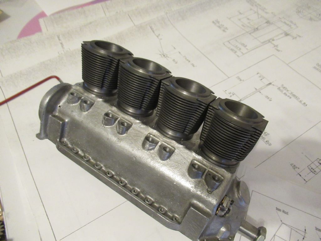

      I have been machining a 2'' round piece of cast iron into a finned barrel for an engine I am making.
      Going between lathe and mill I have managed to produce a large amount of swarf and everything is covered in black dust, including me.
      Not enjoying it and I have another three to do.
      Will all this dust be a problem, do I need to strip down my equipment and wash everything off when I finish barrel no4.

                                                    Well finally finished my barrels , I was going to machine a spare but got fed up with the black mess.
                                                    May regret that decision later down the line .
                                                    Have spent the last two days cleaning my mill/lathe , to be fair the most of the dust was external and
                                                    the slideways were still clean but at least I feel better now and the machines are all readjusted .
                                                    #414267
                                                      Hope you made the rings before you cleaned up.
                                                      Cylinders look very good.
