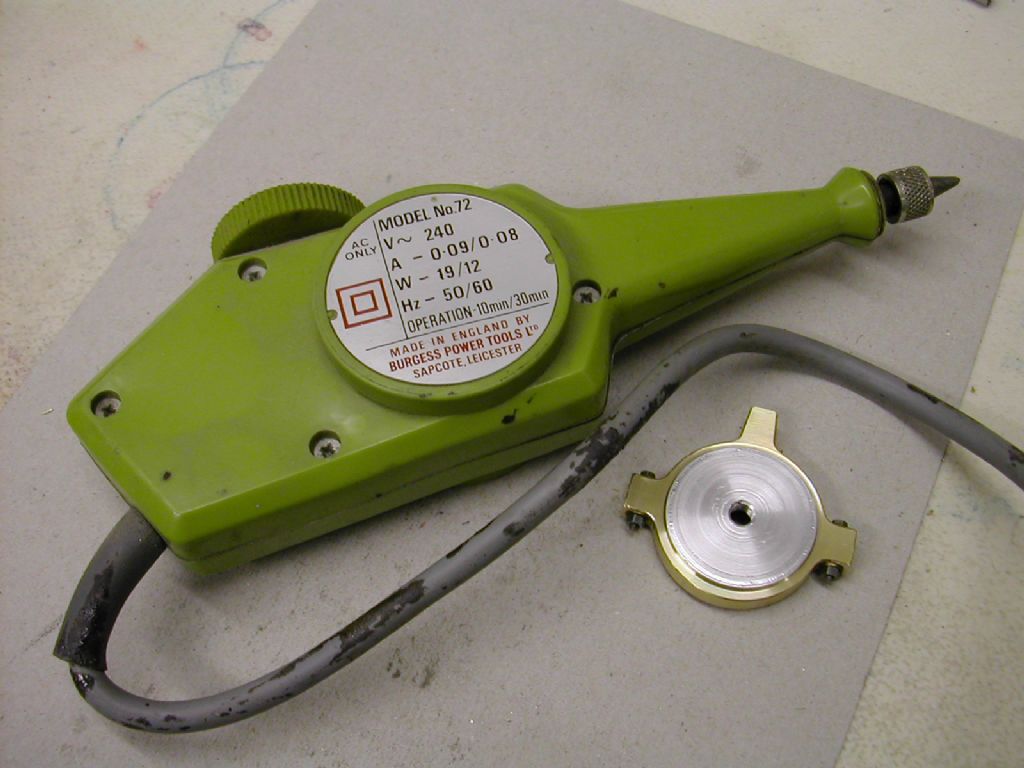

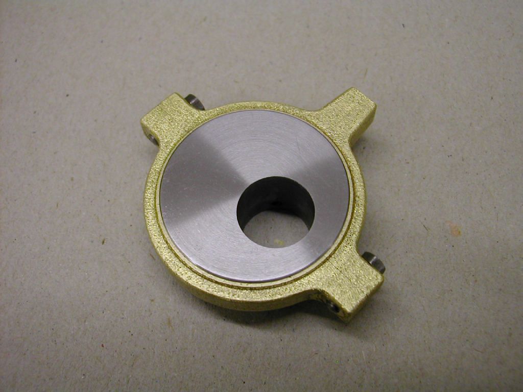

                If you must then the old Wolf engraving tools can be quite good at adding back texture in the larger scales or even holding a dot punch in your fingers and doing similar manually has worked for me. On fabricated work that I want to look like it was cast I tend to file off the external corners and then just run the side of a Dremel grinding point over the flat surfaces more to make them a little uneven than to add texture. I also do this to castings to reduce the texture left by the sand.
                I've not found blasting to add texture to smooth areas, at least not enough to replicate a coarse cast one. Grit or bead blasting on aluminium tends to give more a die cast finish than sand cast, I use it to give a uniform finish after tooling marks have been removed with emery which leaves directional marks.
                #609471
                  This is a grit blasted steel cylinder fabrication, done to clean up after soldering more to texture but it only leaves a fine surface texture more like 180g abrasive than sand would leave on a casting and once painted won't show. Iron would come up with the same sort of finish
                  This is bead blasted aluminium, just a nice satin finish that is quite uniform again if you painted it you would not know it had been done.
                  This post of mine shows the effect of the Dremel and that is on a 1/2 scale model not a small one.

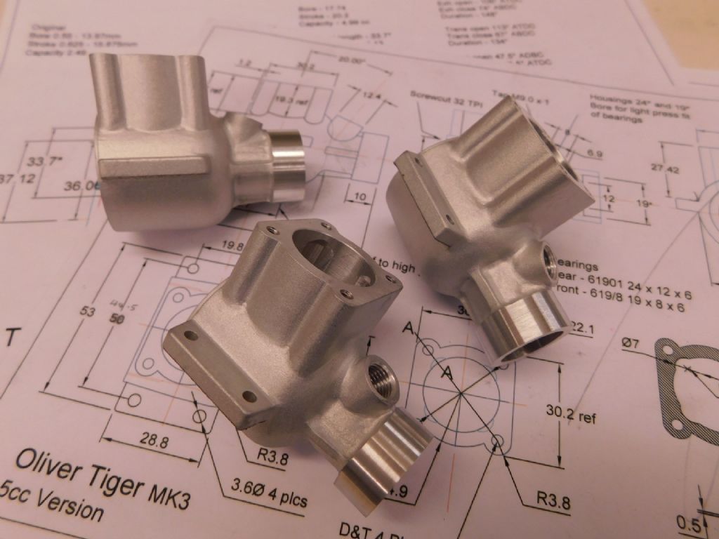

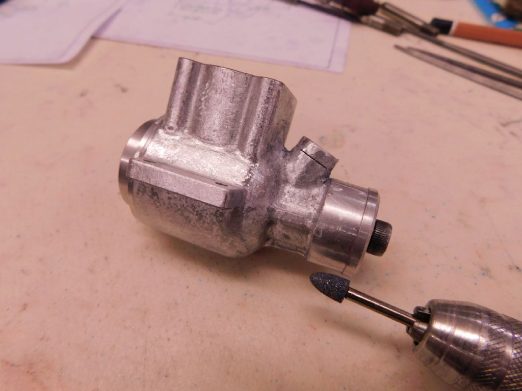

                      I used a mounted stone point at slow speed to achieve the effect on this aluminium crankcase
                      It could be painted over I guess but I chose to bead blast it to achieve the kind of impression of the original I was hoping for. This was not a casting but machined from solid but the effect would be similar.

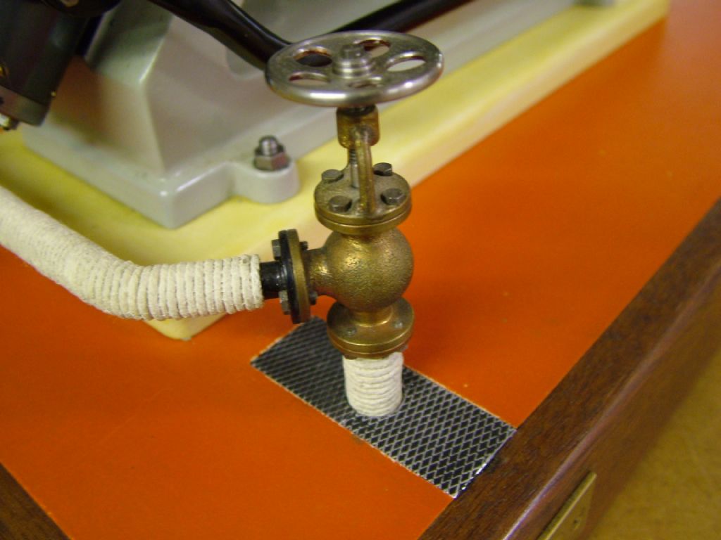

                      I have also used an engraver to dimple the surface of bronze to give a cast impression
                      The tool needs to be blunt, not a sharp point for the best effect. Here's another example on a home made valve body.
