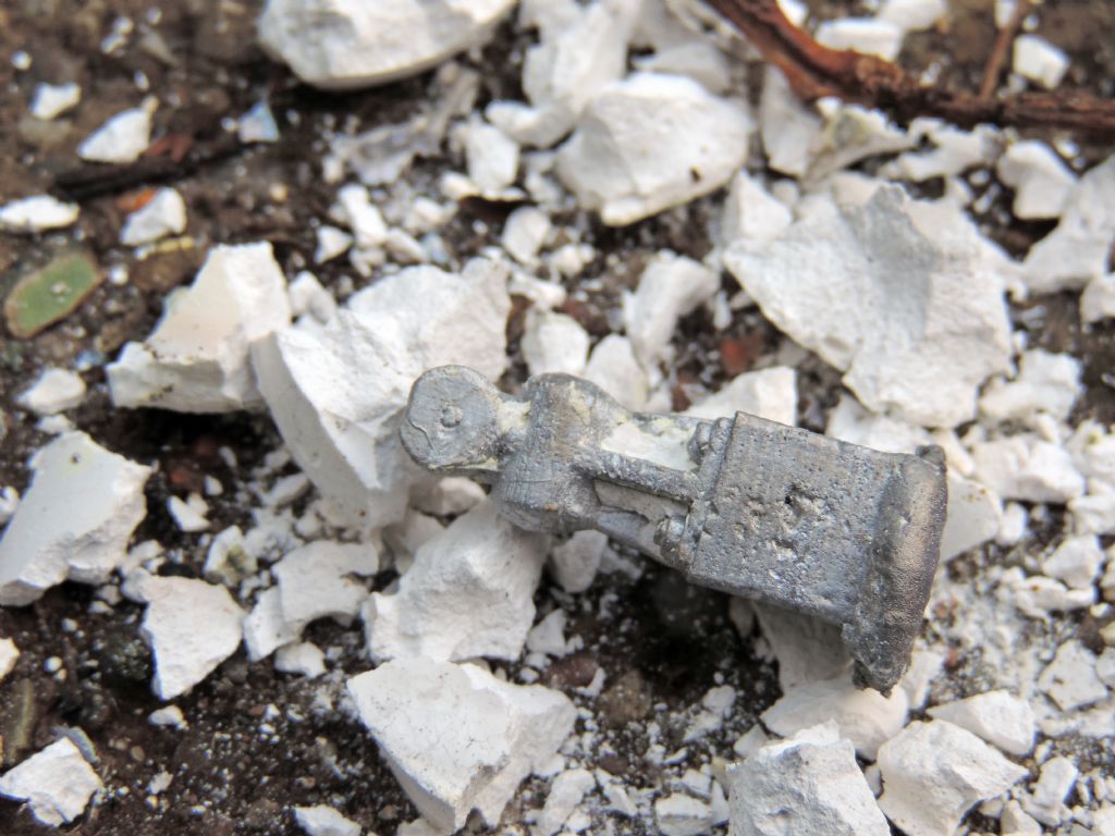

                            I've done 'lost PLA casting using a very fine layer height (just one or two thousandths of an inch).
                            I found that using borax as a flux to cover the melt massively reduces zinc oxide fumes -you don't want to lose zinc content anyway.
                            First try – contaminated with aluminium foil:
                            Next batch of lost PLA castings
                            1 thou layer height print:
                            Lost PLA casting straight from the mould abut 1 1/4" tall:
