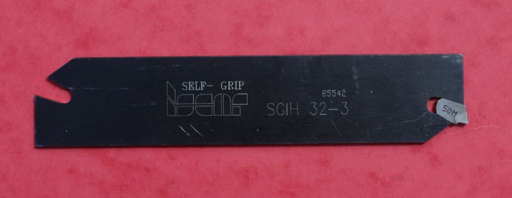

                              Rod – I think you might have the wrong end of the stick. I am not contemplating case hardening the tip holder / blade as that part has already been dealt with by ISCAR:

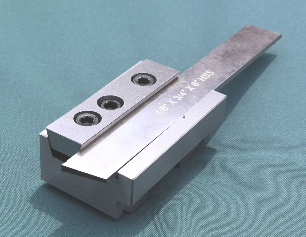

                              The part that I am making is the holder that will grip the above blade / tip holder. Something similar to this:

                                      Neil – Thanks but I take no credit. The block illustrated is my WARCO supplied holder. Sadly it does not have the capacity for the 32mm wide Iscar blade hence my reason for making one. When finished it will have a 14mm square x 70mm long bar to the rear which will be gripped in my rear mounted tool post. I'll post results when completed.
