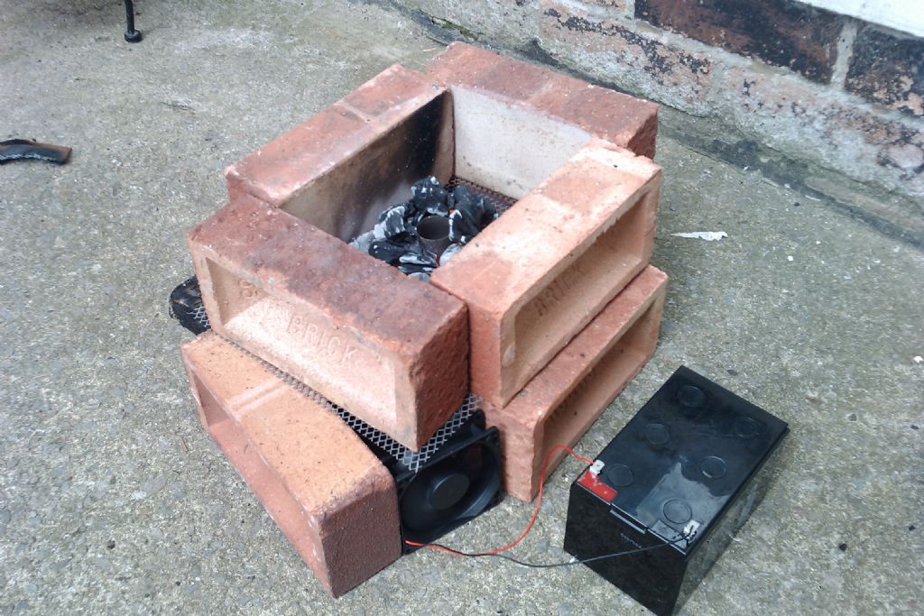

      Hi all,
      I have a gear I bought from HPC I would like to harden, and some hardening powder obtained from eBay here: http://cgi.ebay.co.uk/ws/eBayISAPI.dll?ViewItem&item=330577934005
      Before I attempted hardening my gear I thought I would test the whole process on something less important. First thing to hand was a washer, not zinc plated just plain old mild steel, tested and cleaned with a file, confirmed soft. (Also tried on a mild steel bracket I had laying about, same result)
      So I heated it up with a MAPP gas torch, started with heating till it was red, (have subsequently tried up to orange in colour), dunked it in the compound, let cool, heated again, quenched, repeated three times, still as soft as a mars bar.
      Everywhere I read suggest the process is dead easy, finish can’t be touched by a file, temperatures aren’t that critical, it’s even in black and white in the “Hardening, Tempering & Heat Treatment” book by Tubal Cain.
      What am I doing wrong, are mild steel washers un-hardenable ?

                                        Just tried washer No2 in a little container with enough powder to coat it, and blow torched it for 5 minutes or so. Result was no different unfortunately Suspect I didn’t get it/keep it hot enough. Off tomorrow to buy some BBQ Charcoal I think, will report back.

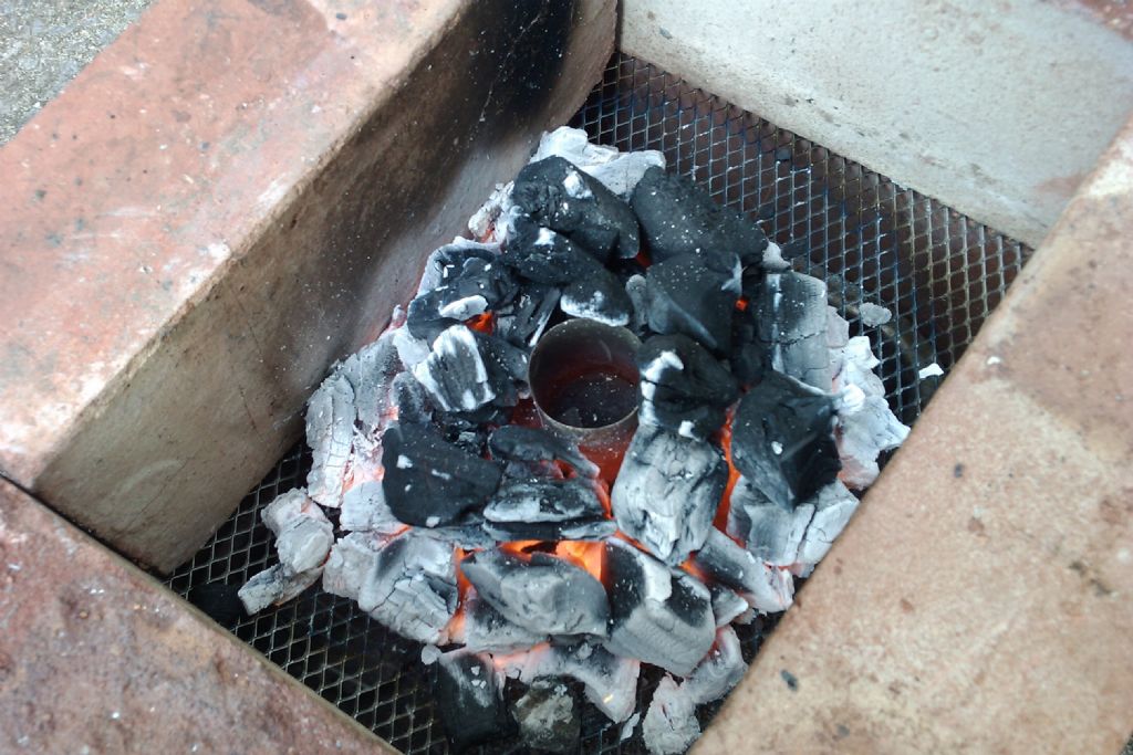

                                                    Phoned Blackgates and a very nice lady went and checked the case hardening compound, and she confirmed it is the type that sticks, duly ordered ! 11GBP plus VAT plus P+P for 400g. Thanks AndyP.
                                                    Meanwhile after buying some of the worse BBQ briquettes I have even seen from Pound Stretchers (you know the saying “There’s no smoke without fire” will if it comes from Pound Stretchers there is a very strong chance there will be and lots of it), I am back on track. Got 8 bricks, a little steel mesh and an 80mm computer fan keeping my washer just toasty. Going to try for an hour and see.
                                                    Cam.
                                                    Edited By C W on 29/06/2011 16:10:03
                                                    #71030
                                                    C W
                                                      @cw29454
                                                      In progress
