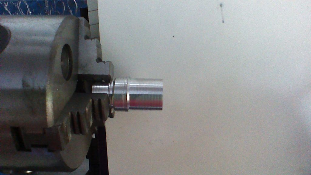

      I recently bought a used mini lathe on ebay, but when trying to turn a piece of aluminium under powerfeed, I found that the carriage was slipping. At first I thought the leadscrew was bent, but I don't think so. Today I engaged the half nuts and held my hand on the lever to feel for reaction, but I discovered that the pinion gear was actually slipping on the rack (hope I'm using the correct terms). I cannot figure out what can cause this. Below is a photo of the piece of aluminium I tried to turn.

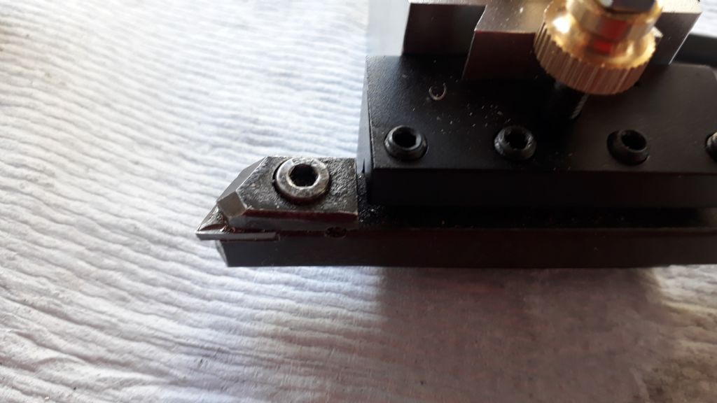

            Finally, your lathe tool looks odd, can you take a photo that shows clearly how it is arranged, I suspect it might be one reason for poor finish? If it's struggling to cut for any reason it can force the halfnuts or gear banjo out of engagement.

              It looks like a right hand insert tool mounted upside down. It looks really odd like that.

                It does, indeed, look as if the tool is upside down.
                Apologies and respect, in advance, Charlene, if that's not the case. But, worth
                pointing out.

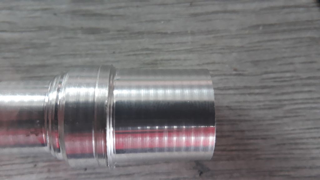

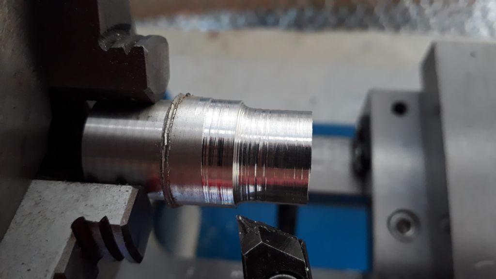

                                Hi Ron, my apologies. It's just the way I'm trying to explain it. I realise the drive comes from the leadscrew.
                                I have seen some improvement now by loosening the gears a bit, cleaning the leadscrew even more and making sure everything is rigid.
                                Hopefully the finish I'm getting is clear enough in the photo. My original thinking was that the leadscrew is also bent and I still think so. It also looks like it a bit when it is turning.

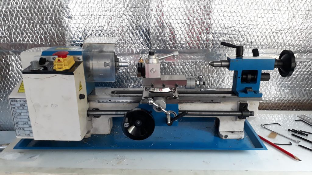

                                O by the way, I am trying to find out what lathe it is because there was nothing on the front cover when I got it.

                                  Post a picture of the whole lathe on here. Someone will surely identify it.

                                    Hi Charlene, well done some progress. If you can post a picture of the lathe I,m sure we can work out the make and hopefully the model.

                                          Ah, I see your tool is not the more usual type we see on mini lathes.

                                          If you feed using the handwheel, then the backlash is taken up and you won't notice any problems.
                                          The finish in that last shot looks OK reasonable. What depth of cut and speed are you using?

                                          Take a photo of the whole machine for us to try and we will ID it!

                                              The lathe below. Seems like about 12" between centres, if I measured correctly.
                                              Maginification of the finish I'm getting:
                                              #371101
                                              Enough!
                                                @enough
                                                Looks like a bowed leadscrew. I can only repeat what I suggested before.
