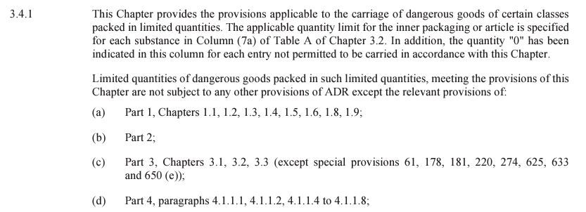

                I'm afraid that's not a correct interpretation of the regulations. You have inferred something (not unreasonably) from the wording of 4.1.1.5, but the regulations are prescriptive and must therefore be interpreted explicitly.
                Packing Instructions (inclusive of P001) are contained in Paragraph 4.1.4.1.
                Paragraph 3.4.1 states:
                09-12-22
                Ergo, compliance with paragraph 4.1.4.1 and thus the packing instructions is explicitly stated as not being required.
                LQ wouldn't make any sense if it did require compliance with packing instructions, because then UN approved packagings would be required for retail products, which would massively drive up cost and complexity in the supply chain…
                Which is the exact problem which the LQ rules were included to avoid.

                  I think we are arquing the same thing. I've never suggested that approved or tested packaging was required. P001 requires inner and outer packaging which is basically what 4.1.1.5 says. If P001 requires approved packaging that is my mistake.
                  Robert.
