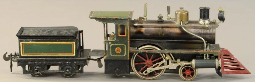

                      Hi Alan
                      If your loco has the same valve gear as the one in this photo I found on liveauctioneers.com you may find the naming of parts to be a problem as it doesn't resemble full-size practice but appears to use a slotted rod like John Turner's "Caledonia" to rock its expansion link.
                      Carette Stork Leg
                      I would suggest testing the operation of the safety valve before testing the boiler. If you fill it completely it should start to release water long before reaching boiling. Mark Horovitz says in "A Passion for Steam" and online that his oscillating example runs at 10 psi. Perhaps you could contact the person who posted this video on YouTube earlier this year to find if he can give any advice?
                      Brian G
                      Edited By Brian G on 28/10/2020 11:39:04
