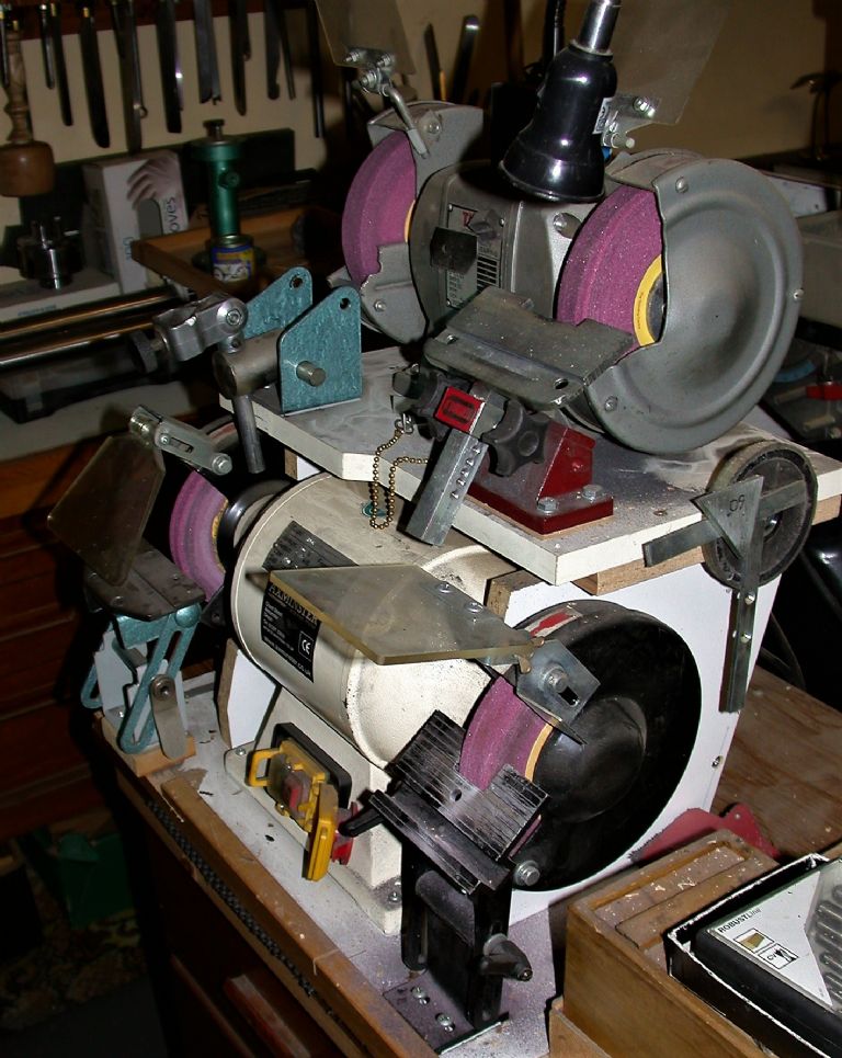

                Get another grinder for green grit and mount them like this to save space. (Yes these 2 both have pink wheels, coarse and fine and the lower grinder is a 1400 rpm oldie) These are for woodturning tool sharpening on the front of the wheel.

                  Thanks for comments.
                  @Robbo & Baz,
                  This is perhaps the best idea. Issues related to space were causing most concerns. It is important for stones of top grinder not to allign with your eyes, just in case…
                  Just try not to buy too many similar machines because even if now space is still there it is not difficult to stuff up workshop to the point that some other machines might no longer be feasible.

                      Posted by Robbo on 26/03/2018 22:09:12:
                      Now that is an arragement I really like – why did I not think of it! With the addition of whetstone wheel for joinery tools and wire brush and mop wheel my grinding alcove is a bit congested and this is an excellent solution. Will make a nice welding project to do a suitable steel frame.

                            Posted by John Paton 1 on 27/03/2018 09:22:11:
                            This one made out of 18mm melamine faced chipboard reinforced with oak fillets and left over from a kitchen construction was intended as a prototype to test the feasibility of the idea. So there are some bare edges where it has been adjusted (ie bits sawn off). However it works so well that a "proper" one has never been made.
                            It has been in use for 15 years + and is plenty rigid enough for the weight of the top grinder and the light loads imposed when sharpening tools.  As it is for sharpening turning chisels very little metal is removed so mess is minimal.

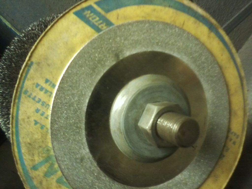

                                          It is rather diamond what is being destroyed by hot steel and not steel being affected by diamond. Diamond grinding discs used to be expensive (now thanks to Chinese this got changed), so reckless use leading to accelerated wear was discouraged.
                                          At lower speeds problem is not as great.
                                          Martin
                                          #348062
                                          mark costello 1
                                            @markcostello1
                                            This is a cheap diamond wheel sold as a tile cutting wheel from Harbor Freight. Just twinned along side a silicone carbide bench grinder wheel.diamond wheel
