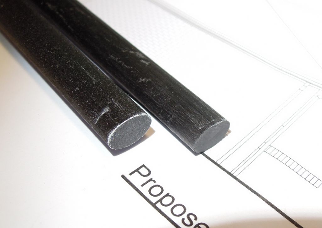

                                  I'm surprised (unless I've missed it !) that no one has suggested the use of elliptical CF pultrusions. Much more aerodynamic and stiffer in the more important plane
                                  I bought a couple about 4 years ago for a project that is taking a little while to get going.
                                  #636688
                                    Funnily enough, Gerry … I haven’t seen that profile on sale for a few years now
                                    Otherwise I would probably have bought some !!
                                    … Do you know of a current source ?

                                          gerry madden
                                            @gerrymadden53711
                                            Hi Michael,
                                            Mine came from this place…
                                            **LINK**
                                            …and a cursory glance suggests they might be significantly cheaper now !
                                            Gerry
                                            ..sorry the link isnt right. The company was Rock West Composites in the USA.
                                            Edited By gerry madden on 08/03/2023 13:27:27
                                            #636705
                                              Many thanks, Gerry yes
                                              Edit: __ but unfortunately, your link appears to be to this thread
                                              [ you beat me to it … Thanks again ]
                                              https://www.rockwestcomposites.com/shop/rods-shapes/carbon-fiber-elliptical-pultruded-solid-rod
                                              although I suspect the cost of shipping might be prohibitive sad
                                              Edited By Michael Gilligan on 08/03/2023 13:28:45
