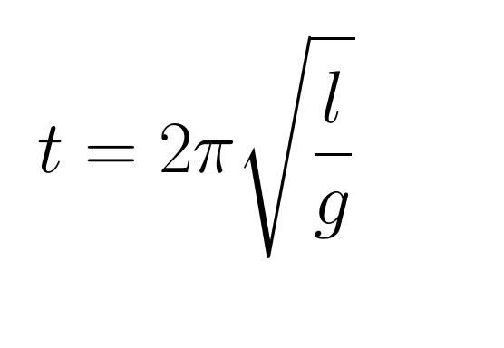

          Everybody is right.
          The formula for period of a pendulum making small swings is:
          Where l is the length of the pendulum, and g is the acceleration due to gravity. No mention of mass in the equation, therefore confirmed the weight of the bob doesn't alter the period.
          But in a practical clock the bob has another vital purpose – it stores energy, keeping the pendulum going between ticks despite air resistance. It also helps keep the path straight rather than an ellipse, while its inertia reduces the effect of vibration.
          At the extreme, a pendulum clock fitted without a bob tends to stop because the impulse can't store enough energy in the rod alone.  Conversely, the impulse may not be strong enough to keep an excessively heavy bob going, or demand too much power of the clock for good timekeeping. So, although any bob between not too small and not too big will work, for any particular clock there'll be an optimum bob weight, and it's worth keeping close to it because it improves running.
          My only working clock so far was made of Meccano and it only had crude involute gears. All self-respecting clock experts should know that clocks can be made from a construction toy. But they're not wrong to be critical of them! Meccano clocks don't work well: difficult to adjust, poor timekeepers, and hard to keep going. A successful mechanical clock is a fight with friction, and a well-made gear train makes life much easier. Clock-makers believe cycloidal gears to be lower friction than involute. Not convinced myself; I think it would be hard to tell the difference between equally well-made clock wheels of either tooth form. I expect an expert will explain shortly why I'm wrong. Again!

            I'm afraid SoD is incorrect. The formula he quotes is for a simple pendulum, the model of which explicitly assumes a weightless cord/rod and zero friction, neither of which is realistic.
            Once the pedulum rod has mass then, as Duncan says, the equations get more involved and include mass. That's why a compound pendulum is also known as a physical pendulum.
            Alan states that an expert said his clock wouldn't run due to involute gearing, which is plainly wrong. So why believe other experts when they say pendulum mass doesn't matter?

              Dave's formula is correct for a pendulum where all the mass can be assumed to be concentrated at the CoG of the bob. Real pendulums have distributed mass, some of which is in the rod above the bob; and the whole thing has a moment of inertia around its CoG (which is not the same as the CoG of the rod). The complete formula is:
              T = 2 pi sqrt{frac{I} {mgL}}
              where I is the MoI of the whole thing about the pivot, L is the distance from the pivot to the CoG of the whole, and m the total mass. If you add mass to the pendulum above the CoG of the bob, the CoG moves up and the pendulum will speed up slightly.
              If you make a pendulum to a design that used a steel rod but using CF instead, it is very much lighter than the steel, so will contribute much less to the MoI and because its mass above the bob is much less the clock will run slow for the same bob mass and rod length, so you may have to make the rod shorter.
              For accurate calculation you ideally have to include each component of the pendulum and compute the "radius of gyration" and mass. This is easily done with a spreadsheet though it's tedious to make sure you have all the components. Then Excel can use its solver to find the exact length to give the period you want. For most purposes the answer is the same as the simple formula, but for example the pendulum on the replica "RAS" clocks being built by a BHI team, which uses a gridiron pendulum with a relatively small bob, the spreadsheet is quite elaborate.
