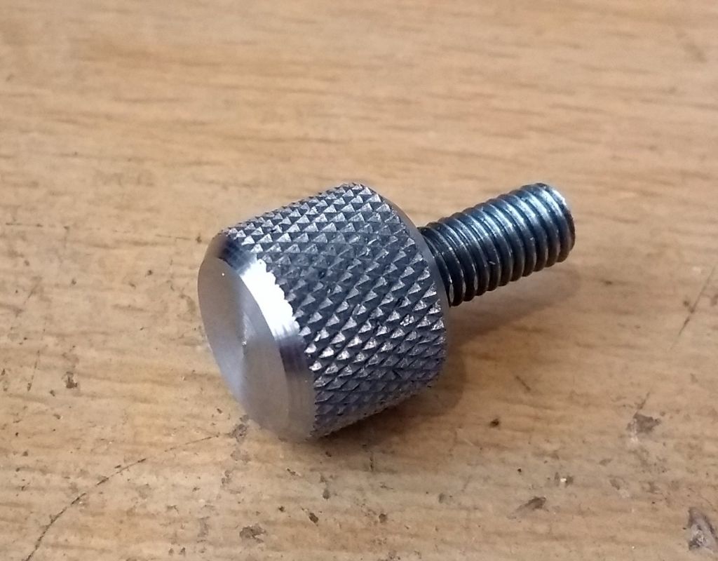

        Curiously enough i just made an M5 thumbscrew in random stainless from an old inkjet.
        Lovely steel to work, so probably 303.
        Occurs to me that such things are a great practice piece, turning, facing, 45 degree bevelling knurling and threading all on a tiny bit of metal.
