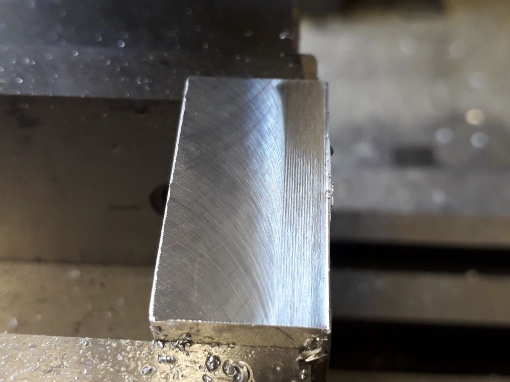

      My fly cutter. I get a really great finish with this one. 100_0823 (small).jpg
      Is that an 8mm square shank?
      Been looking for one just like that so could fit my present flycutters.
      May I ask where from?
      Edited By Peter Spink on 10/05/2020 19:38:23

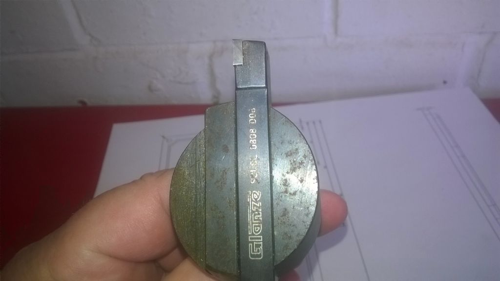

        Peter,
        JB Cutting tools do a "button" insert holder in 8mm. It uses an 8mm diameter insert. If you want a larger radius, you'd have to get a larger tool and grind it down. Or a carbide end mill might do the trick, too.
        JB tool 8mm shank
        By the by, I bought a box of 10 CCGT polished inserts at last year's Doncaster show (from the JB stand) ostensibly for machining aluminium, but just lately I've been using them more and more on steel. Once I got the speeds (high) and feeds (low for my lathe),right, the finish was really good. Incidentally, I use a righthand insert tool in my flycutter with good results. Not that I use it very often.

            Peter Spink
              @peterspink21088
              Posted by John Hinkley on 10/05/2020 21:35:06:
              Peter,
              JB tool 8mm shank
              Perfect John,
              Many thanks
              Peter
              #470786
                Michael, no, the lines are what the stepover leaves at the edge of the diameter of the cut so size of tool would not matter. Totally impractical but would give straight marks on the surface.
                Peter, those plain shank flycutters are usually 1/2" or 12mm shank so that tool looks to be 6mm sq
                John, how do you get on with aright hand tool when I put one in my flycutter it would need to run in reverse and it also puts the insert off of the radial line so you end up with negative rake.
                Left
                Right
                Left lined up well
                Right not lined up

                    Peter Spink
                      @peterspink21088
                      Posted by JasonB on 11/05/2020 07:00:12:
                      Left
                      Jason thanks for pointing that out – my flycutter takes 1/4" square toolbits (slot is about 8mm) so I would need a 6mm toolholder and shim it to get the cutting edge on the centre line. I don't think the CCGT button inserts are robust enough generally for interrupted cuts but maybe OK for a very fine finishing cut on Ally?

                        My fly cutter. I get a really great finish with this one. 100_0823 (small).jpgSorry if I misled folks. After I finished cutting, I laid a sheet of 400 grit on a piece of glass and dragged the items once over the length of the sheet, that was all that was needed to remove the cutting marks.
                        Obviously RPM and feed rates will affect the finish, but being a complete novice I usually try new ideas on a bit of scrap first in order to find what gives me the best results. I thought of using this tool because I am not too good at grinding HSS tooling and a good friend had recommended a fair radius for fly cutting. The parts shown were for my fibre optic clock, the subject of a build thread in the clock section.
                        Dek.

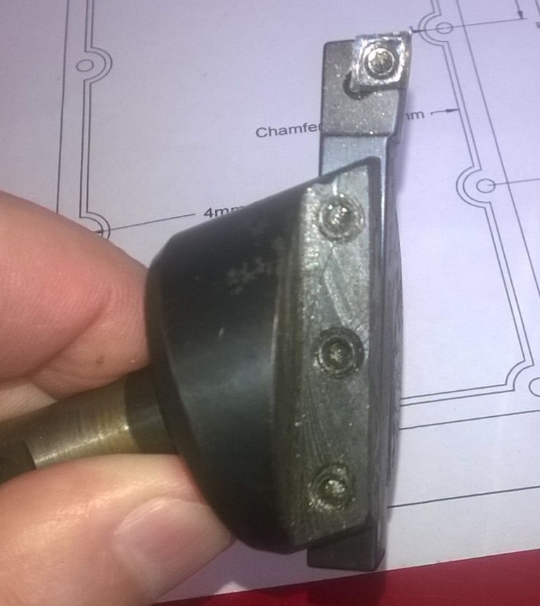

                        John Hinkley
                          @johnhinkley26699
                          Jason,
                          I'm afraid I got my lefts and rights mixed up! This is my set up:
                          As you can see, it uses an 8mm LEFThanded tool holder, which puts ithe cutting edge, as near as dammit, on the centreline. Good enough for my purposes, anyway. An HSS tool of the same width would have similar alignment, unless ground with a distinct offset. Maybe my flycutter has the toolholding groove machined in a different position (it's a commercially made item).
                          As you can see below, it's fitted with a polished tip, but can't remember when I last used it!
                          Hope that's cleared up any confusion.

                                #470893
                                  Posted by magpie on 11/05/2020 08:58:24:
                                  It’s fine. Dek. … I was only having a bit of fun.

                                                Dr_GMJN
                                                  @dr_gmjn
                                                  I should have posted this here I guess, just to say what I did as a result of the advice given (it's also in another thread). I got a selection of 4 types of insert from Cutwel. Ordered 16:30 yesterday, arrived this morning. DCMT, DCGT, 0.2mm and 0.8mm nose radius, some for cast iron, some for non-ferrous and others for steel. There was an online chat thing, so I was able to confirm I was getting the best inserts for my tools and what I wanted to do:
                                                  So the small fly cutter holder arrived today. I put my Sandvik 8mm left hand tool holder in it, fitted with a DCMT 070208 insert for steel, and had a go at fly cutting for the first time. Must say I was really happy with the results, finally a bit of progress. Workpiece was the same mild steel I've been using for the vice clamps. I went up to 0.5 mm cut depth with no issues.
                                                  The only slight problem was vibration due to the tool holder being long. I ground it down a bit and that resolved that. The grub screws in the holder appear to be made of cheese, so having got the tool well and truly stuck, I spent a good 30 minutes drilling them out and replacing with caphead screws, which was fun.
                                                  Missed the postman due to work, so the milling cutter test will have to wait, but in the meantime, for the 10V castings, what do folks recommend for facing: milling or fly cutting? I did get some DCMT070208 inserts for iron too.
                                                  Thanks.
                                                  As an addendum to this, I'm a bit unsure as to feed rates and spindle speeds. Pretty much everything within reason worked without any complaint from the machine. I got the impression I might have been running at too high an rpm though, becasue the chips appear to be blued by heat.
                                                  Still, I faced my remaining vice blocks, and got much better surface finish than milling, and parallel over 25mm x 40mm to within 0.0006" according to a my micrometer, over an average of 5 measurements. Sorry to mix units!
