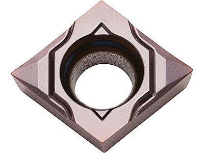

                      These are my main inserts for my Myford lathe and what I turn. This little insert is quite amazing. It does outer turn, fits my small boring bars, and will cut everything from Al to bearing races, including Ti. Technically it is a stainless steel grade,CCGT060202MP-CK-PR1425 ccgt-mp-ck-pr1425.jpg

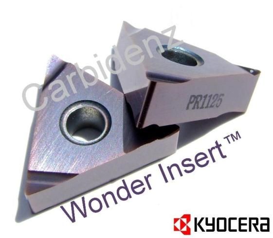

                      My other mainstay turning insert is the TNGG160402R-S PR1125 (Wonder Insert) called a Wonder insert by the NZ seller. It really is just that. Like the other little insert, it will cut all materials including bearing races, and Ti. I mainly just get the R0.2mm inserts, as I often need a fairly sharp corner for so many things. The seller I buy from also does sell single inserts as well, so very helpful to the model market. I find that the smaller radius has less tool pressure loading. As long as the feedrate is 25% of the tool radius, it will give a very good surface finish..

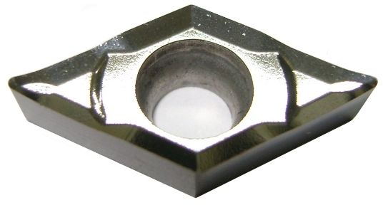

                      For the DCMT11 holder I use these, they are an AL specific turning insert, but as long as the feedrate is not too high, cut steel very well also. Just awesome with plastics, as they are very sharp.

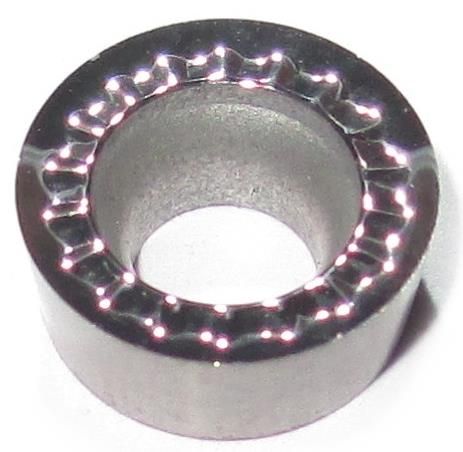

                      The last surprise was this 8mm( R4) button turning insert. I thought that it will chatter like no tomorrow and give a poor surface finish. But it comes up looking like a mirror. This I used on the bearing holder for the sensitive drill adaptor. Works really well on Al, not yet tried on steels yet.
