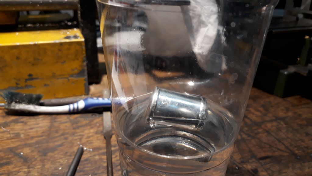

                                          I made a tinplate float 26mm diameter and 30mm long many years ago. The material was the thinnest plate that the local model/hobby shop had, maybe 0.2mm. The ends were spun in the lathe and the body was rolled around a former. It was soldered up with the minimum possible solder to keep the weight down. The finished item weighs 6.5g and floats reasonably in alkylate fuel (I think the density is similar to pump petrol).
                                          It never worked due to my inability to make a suitable valve at the time. I decided to use an overflow system for my model SU type carb as this would have needed an even smaller float and valve.

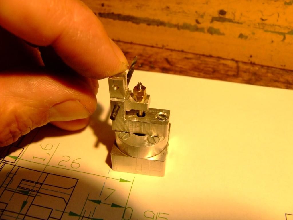

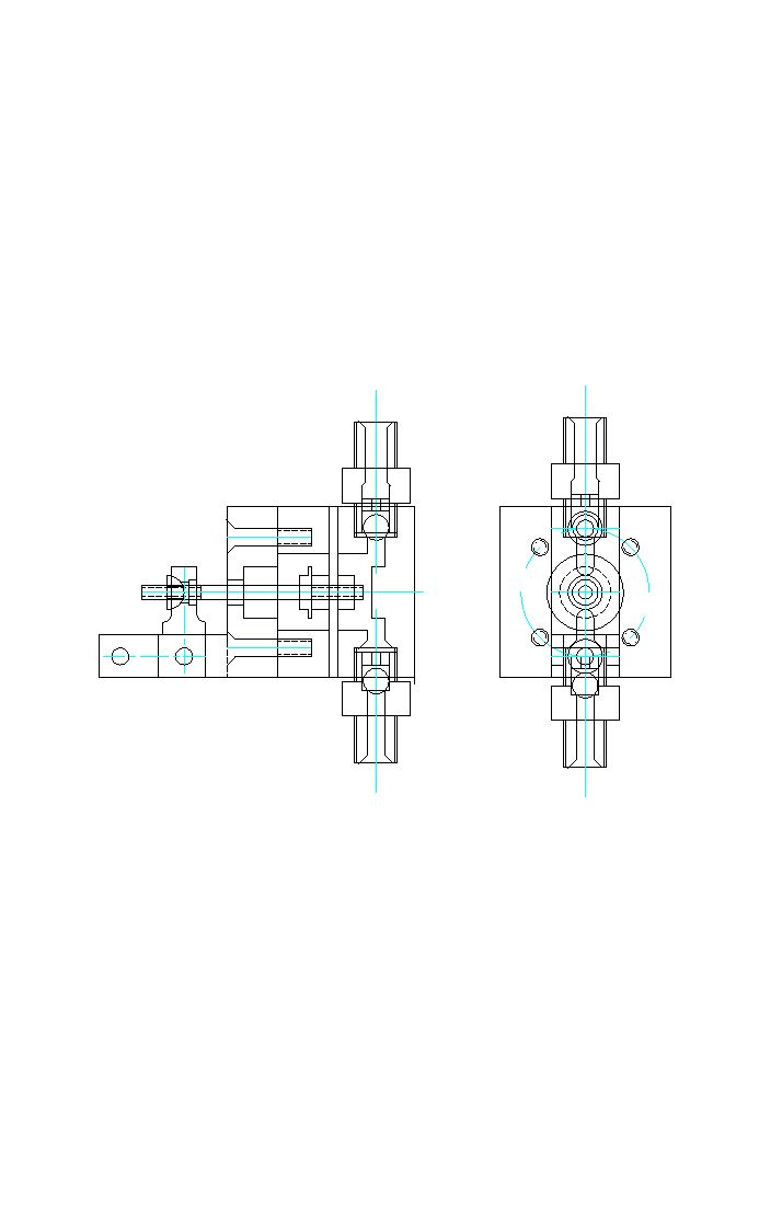

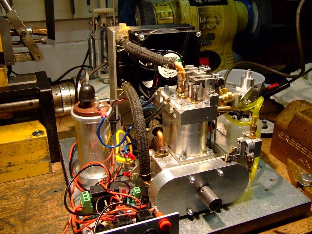

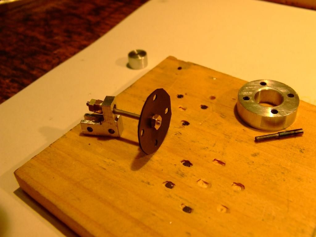

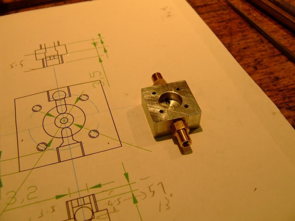

                                                The fuel pump started out as a piece of 20mm square aluminium. I have also built a larger 25mm version but the delivery was too much for this engine. The diaphragm is cut from 1mm Viton sheet using the clamping ring as a punch guide. I decided to use a ball and socket at the rocker end of the pull rod so it would stop pumping against a closed outlet (needed for another application). It is driven by an eccentric mounted on the camshaft drive gear. The inlet and outlet are gravity ball valves with 3mm stainless steel balls. Tiny cross shaped pieces limit the movement to 0.5mm.
