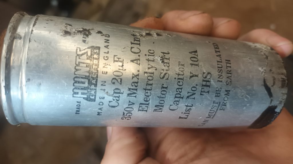

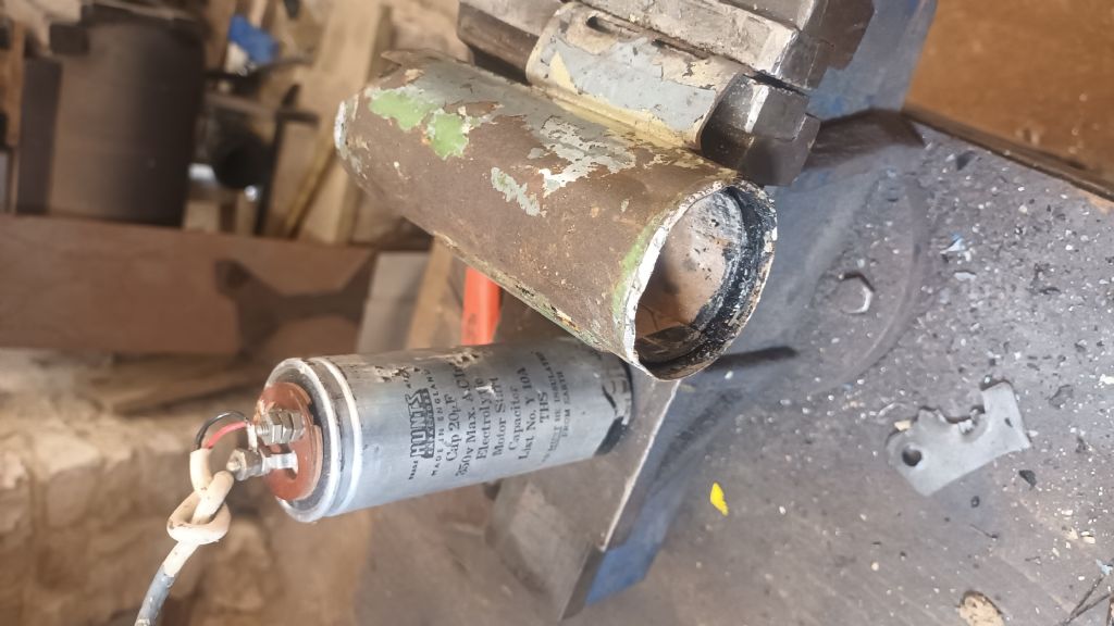

      Update no 2:
      It turns out the capacitor was sealed inside a can. It's actually 20uF so with my 200uF I'm guessing the windings won't last long. I'll get another ordered.

        @noelshelley55608
        AH ! The bit that shouldn't get hot is the motor ! Noel

          @robertatkinson2
          As long as the centrifugal switch is working and the motor is not getting hot the bigger capacitor may not be a problem. It is mainly purpose is to provide a phase shift. The current depends on both the capacitor and the winding.
          The motor manufacturer will fitt the smallest capacitor possoble to reduce costs. I'd be more concerned if it was a run capacitor.

            Posted by Robert Atkinson 2 on 16/09/2023 13:08:08:
            Robert.
            Sounds good. I may just let it be for a while and see what happens
