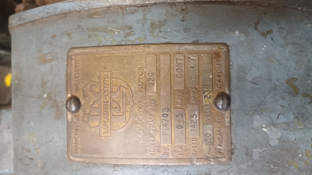

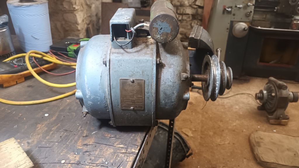

        I picked up a motor at a local auction. Its a single phase 0.5hp induction motor. It doesn't self start but runs fine if I give the output a spin. I'm assuming the starter capacitor is faulty. Could someone push me in the direction of a suitable replacement (size and type).
        Thanks
        Colin

            Posted by noel shelley on 10/09/2023 15:43:04:
            IF your luck is in and you look VERY carefully you should find the value of the one you have stampted on the tin tube, on the end and painted over ! Note that the voltage may well be 400V. It is possible with the right meter to check the value it currently is ! Or has the centrifugal switch failed ? Good Luck Noel.
            I had a good look but couldn't see any trace of markings. The plate is stamped 230V and it runs well on the domestic mains once started. What makes you think it could be 400V? Thanks Colin

              For a 1/2 hp motor the generic start capacitor recommendations from several sources range from 150 to 250 µF. That said exact value doesn't usually matter too much unless you are starting a significant load.
              I'd try 200 µF.
              Give that large numbers of aged single phase motors are still starting just fine 50 or more years after they were made you hafta wonder how close the current values of capacitance are to the brand new figures.
              Clive

                  If it were mine, I'd try 100uF 260vac. Make sure it's a Motor Start Capacitor. Many sources, this example is Farnell. Until reliability is proven by not going bang after several stop starts, assume the capacitor might go pop! Although far from spectacular exploding capacitors sometimes spray hot chemicals about. Eye protection, gloves and old clothes.

                            Thanks everyone. I'm going to have a look at the centrifugal switch first and if that looks OK I'm going to go for a 400v 200uf and see what happens!!

                                                Quick update: I've just connected a 450V 200uF and it runs like a dream. Thanks for all your input. Cheers Colin

                                                      I'm pretty sure I can hear the centrifugal switch disconnecting it shorty after starting. I only know about centrifugal switches thanks to this thread!!!!
