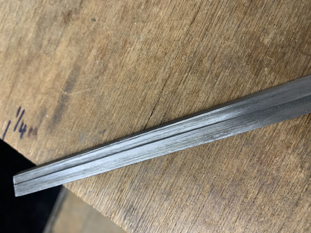

              Posted by petro1head on 20/02/2023 15:46:49:
              Removed the top slide and that seems Nice and flat.
              I have ordered a New Cross slide screw and nut from Warco. I also asked about gib strip but it seems they don’t do them now.
              Looking at the existing gib stop it looks very worn (see photo below). So it looks like I will have to figure out how to make a new one. Does it have to be steel or could i use somit else?
              Edited By petro1head on 20/02/2023 15:56:45
              That is horrific. Is that on the sliding surface? If so there must be something horribly horribly wrong to do that to a gib strip. You need to check the cause of that before it does it again to your remachined surface. Did you do the checks with a feeler gauge per the video posted above?
              Or was that groove in the gib strip machined in there at the factory for the ends of the gib adjusting screws to locate on, on the non-sliding side of the gib strip?

                  Posted by Hopper on 20/02/2023 22:47:45:
                  Yes i did check and it was fine
                  The grove was on the mating side. Again i have checked the dove tail and it feels ok

                    #634421
                    Hopper
                      @hopper
                      Good stuff. One step at a time.
                      Hard to see how that groove could have been worn in place like that. Maybe it left the factory like it? QC can be a bit hit and miss over there. It will have to improve things with a full smooth face bearing on the dovetail!

                                      Hopper
                                        @hopper
                                        Problem would have been that shonky gib strip. Keep your old screw and nut for spares if the new one ever wears out.
