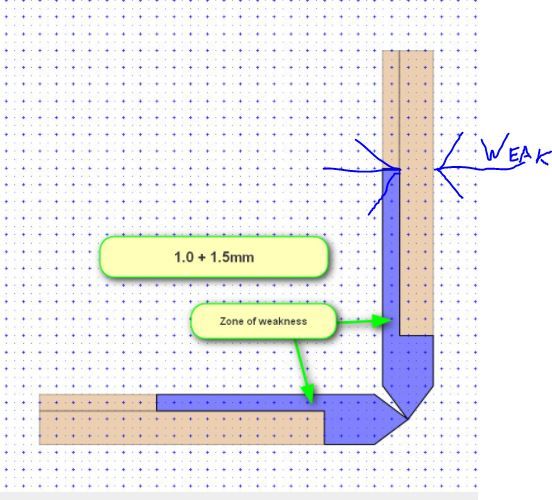

Can you make the core from one layer each of 1.0mm and 1.5mm which with the other items would give the total you desire.
Or if you want to make sure the structure is balanced then two of the 1.0mm with something 0.5mm in the middle of the sandwich.
Hmm… 1.0 +1.5mm isn't completely impossible, but it would mean fundamental changes to other parts of the design. Moreover if the product went into production the unwanted added complexity would add unwelcome cost.
So, yes, if all else fails… I'll guess I'll have to have another think about it but it would be must better to get two layers of mill board of the correct thickness!
J
Can you enlighten us about the fundamental changes that having an unbalanced 1+1.5 laminate would cause? In your stack up:
0.15 – Protective film (minimum)
0.05 – adhesive (guess)
1.50 – Gemimi Mill Board
You make no mention of anything “in the middle”, and by your numbers it would add up to 2.9, just inside your sweet spot for thickness.
If you make it to production then presumably you’ll make an order for the right thickness of custom board, so no complexity there.
Oh crumbs… I really, don't want to get into the intricacies of the actual design…
[I'm going to regret this!]
OK, yes if one of the layers was 1.0 instead of 1.5, then my stack would now become 2.95mm thick instead of 3.45mm thick… and yes, that would be an ideal thickness.

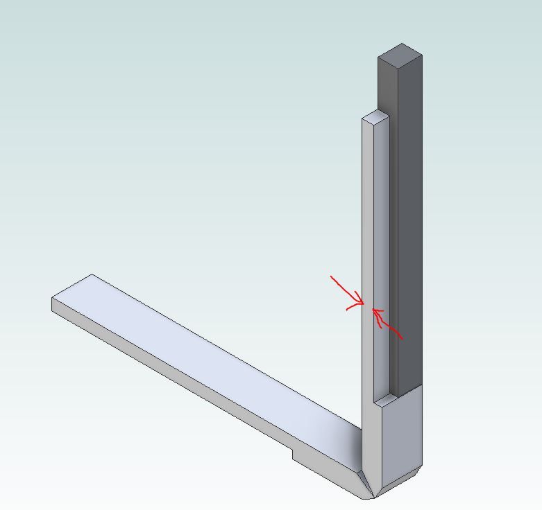

However My problem is that:
A) To keep the number of different part designs down, the embedded plastic parts have to have rotational symmetry (i.e. the same design of part needs to work upside down)
B) Thinning the plastic connector down to 1mm from 1.5mm may weaken it too much and permit too much flexing – I'm not sure yet.
C) I would have to change my CAD models… and my problem is that my freebie license of my CAD software (SolidWorks) has now expired and so making the change would be expensive & time-consuming.
D) Finally, a potentially greater problem is that I have already got my plastic parts (in blue) 3D printed!
So as I have conceded, if all else fails then could re-do design, however all things considered, it would be VERY much easier at this point to just get some more c.1300 micron Millboard!
J
PS Please don't even try to understand what is really going on in my diagram, because what I have drawn is only a schematic and does not represent anything like the complexity of what is really going on at the pointy ends!
