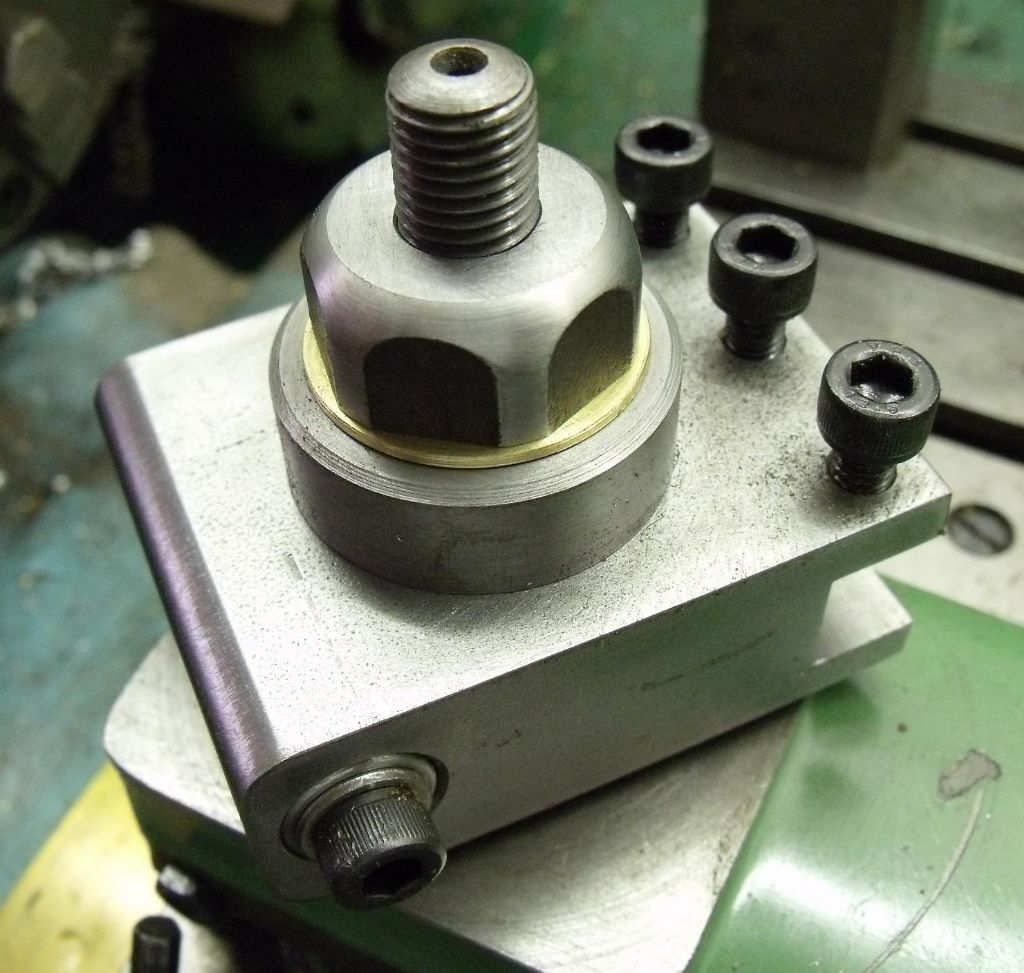

                                          Hi Felis,
                                          I have an S7 and have made both front and rear tool posts for it ! Pictures below.
                                          This is my front toolpost, it is a Norman Patent one, designed to take a maximum of a 1/2" tool bit and will raise up to allow a 3/8" tool bit to be used.
                                          This is a view from the other side showing the clamping screw.

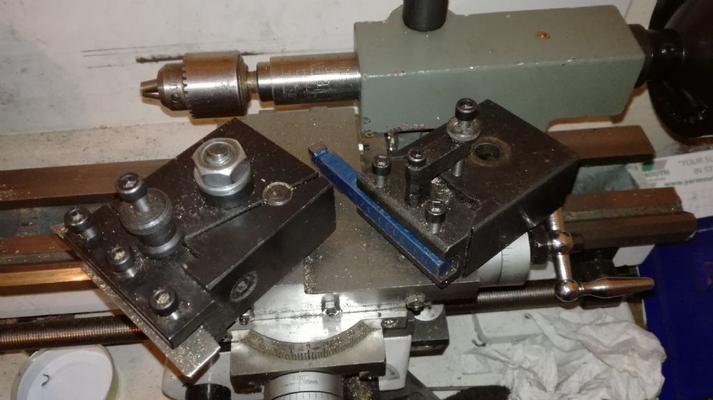

                                          And this is the rear tool post set up for parting. That blade is a 200 mm long by 12 mm by 2 mm thick Hss one out of China. The post was designed to accept any of the 52 mm bore tool holders. I've since added a 25 mm thick block that sits flat on the top slide, after having been warned that the parting force, particularly if the blade jams, could break out the rear slot.
