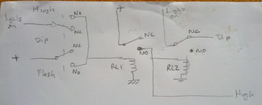

      Hi Tim,
      I did not post this earlier as it does require the headlight switch to be able to carry the full dipped current. But if it can then this should do it without having a relay permanently on.
      When the stalk is pulled or pushed RL1 turns on and powers the high beam, it also powers RL2 which disconnects the dipped.

        Adrian:
        I think – on first glance – your version and mine are the same in practice.
        The headlamps switch was designed by Joe Lucas, in about 1925, to work without any relay assistance, and sometimes had to feed a fog lamp or other extras as well. So, it is well able to do the business. And with a pair of LED 'bulbs' in the headlamps, the current is less than half what it was in the good old days. In fact, with headlamps and side lamps and brake lamps (twice as many of each type than when new) the current now is below the output of the dynamo. Progress indeed.
        Thanks for your suggestions – Regards, Tim

                  How about this minor change to my version?
                  The lower relay is fed from the Green (always on) supply. Change this feed to Blue (headlamps on). Then it is only feeding the relay when the headlamps are on, and I'm not likely to leave the car parked in that state.
                  I think …
                  Regards, Tim

                    I have got it ! It is embarrassingly easy.
                    I am still away working so I hope my rough sketch is clear.
                    The feed "lights" obviously comes from a suitable fused battery supply.
                    The"IGN" feed is also fused and is fed from whichever IGN switch feed you want – I would use the accessory position. You need to ensure the IGN feed can supply the full current for the high beams.

                        The relay circuit is right though, the key being that both relays operate together – like a double pole relay – in this case achieved by simply paralleling both coils. The stalk either latches to select high beam when the light switch is on, or momentarily selects high beam flash even when the light switch is off. Whenever the high beams are on, the dipped beams are disabled
                        The two power feeds can come from wherever you feel comfortable, risk-wise. If the IGN switch cannot supply all the high beam current, feed only the high beam relay coil from the IGN switch but the actual high beam relay common terminal from a high current source.
                        Edited By John Doe 2 on 19/11/2022 18:18:22

                            Back home from work now, so here is a slightly better diagram, showing the switches more clearly. Black dot = normally closed terminal, empty dot = normally open.
                            Each light has an individual fuse, so only one at a time would blow, leaving at least one other illuminated.
                            Both relay coils are de-powered when the dipped beams are selected: the relay coils are only powered when the high beams are selected.
                            The two lighting +VE supplies are up to you where you take them from.
                            I would take the flash control from the IGN accessory position – you might be waiting for your son/daughter/wife to emerge from where you are picking them up with your engine stopped, but listening to the radio.
