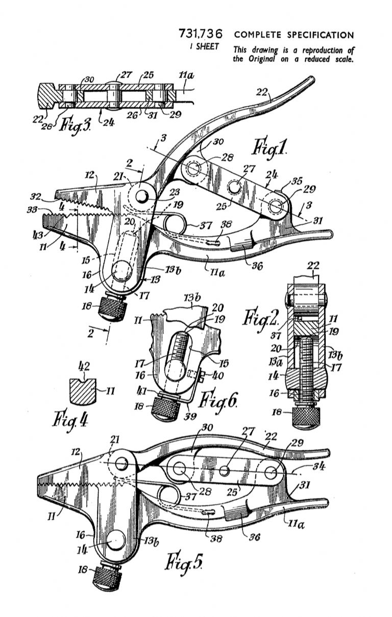

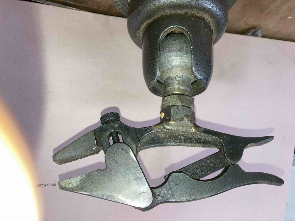

      Here's one from way back. I've had it a while and mounted as it is on a ball swivel it's very handy.
      It carries UK Patent Nos 776142 and 731736. The tool itself proffesses to be a SPEETOG Plier Clamp and the swiveling base is marked as SPENKLIN Miniclamp manufactured in Horsham Sussex. Fully adjustable via the knurled thumb screw. The Pliers itself is welded onto the ball swivel spigot in a very neat fasion so unless the marriage was carried out by our workshop which is where I acquired it I would suggest that it was manufactured as a complete unit by SPENKLIN.
      Googling Spenklin shows a number of the bases with different devices attached and the pliers as a separate unit can be seen here:-
      **LINK**
      I'm sure if you keep your eyes open for Speetog Plier Clamp on eBay one will come up eventually.
      regards Martin

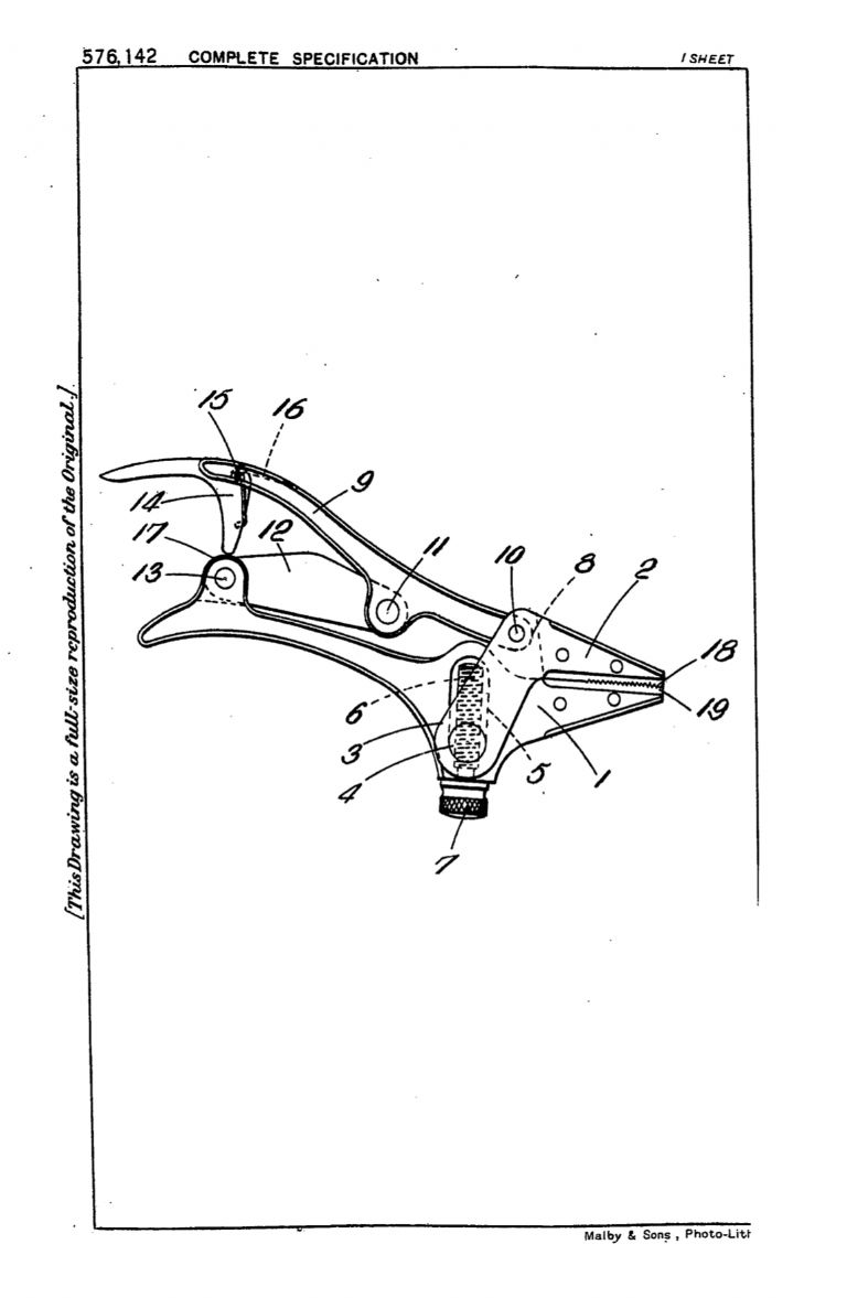

        Posted by Martin Kyte on 27/05/2021 12:09:17:
        Forgive me, Martin … but I think the first patent number should read 576142 not 776142
        Edited By Michael Gilligan on 27/05/2021 13:27:21

            @Martin Kyte – Self-evidently the jaws are closing around a pivot point and as such will not close in a TRUE parallel fashion, (with the result that by definition as you tighten the thing up, either one or the other end of the jaws will be more compressed than the other end). Interesting design, though.
                So what? It's a pliers not a precision collet chuck. I defy anyone to close a toolmakers clamp so that it has exactly even pressure both ends of the jaws. The best milling vices hold work tighter at the bottom than the top. However there will be a position in the swinng that is correct and if the tool has been made correctly it will close to parallel. The pivot point is the adjustable bit rather than the swing of the jaws so unlike the mole wrench the jaws stay parallel in the closed position throughout the range of opening. Who cares what the angle is when it's not holding the workpiece. Not done any measurement of error due to moving the pivot point but by eye its not discernable. Solid works it yourself if you want to find out but there will be slop on the pivot by neccessity in any case.
                Michael. You are right it's a 5 not a 7. The stamping is a little obscured.

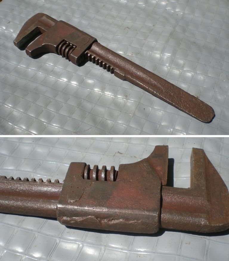

                                      I didn't realise you could still get things like my King Dick spanner.
                                      This one from Facom https://uk.rs-online.com/web/p/wrenches/8764945
                                      Facom spanner similar to King Dick
                                      Edited By jaCK Hobson on 28/05/2021 12:48:40

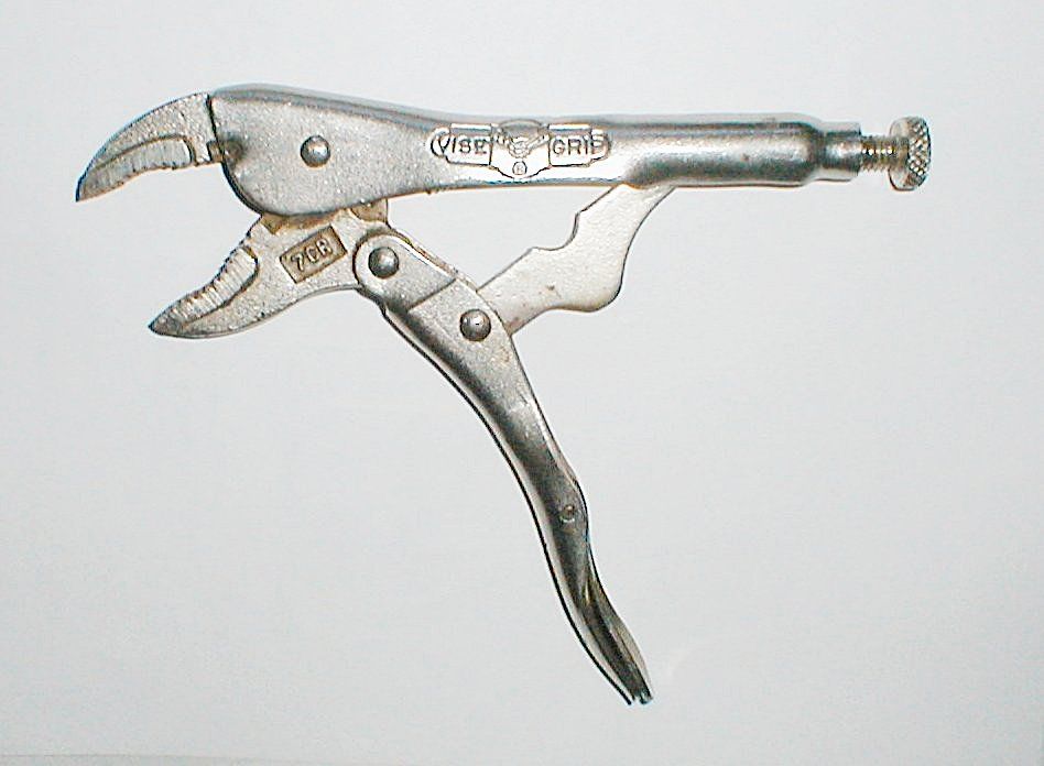

                                        > Why do you think the Mole grips will cope better than the Stanley 85-610.
                                        I am saying that in the event that something important start to bend out of place, that the locking mechanism in the Stanley 85-610 looks like it doesn't has much adjustment as Mole grips.
                                        Are you seriously questioning this?
                                        It's just that it seems to me to be a self-evident truth, because ALL the opening and shutting in Mole grips comes from the position of one adjustable screw, whereas in the 85-610 the bulk of the adjustment come from the screw near the jaw, and there is no adjustment screw at the far end of it.
                                        I think that your self evident truth is not (true that is).
                                        On the mole grip the adjustment screw is not responsible for all the opening and shutting. The linkage is responsible for the bulk of the opening and shutting. The adjuster sets the end point for the linkage.
                                        If you look closely, you will see that the screw adjust on the mole grips is where a fixed pivot is on the spanner, and the fixed jaw pivot on the mole grips is where the adjuster is on the spanner. The adjustment on the spanner is adequate for the maximum designed opening of the spanners jaws.
                                        I don't know if you have ever taken an adjustable spanner to pieces, but the Jaw has a solid stop on the max opening, and the rack just drops off the end on the close side. This stops the moving jaw falling out when opened, and the massive fixed jaw stops it from falling out on the closed side. If you bend the linkage such that it wont close as far – presumably by being an unsympathetic ape – then the jaw will pass the worm further, until it hits the fixed side. I have mole grip which no longer fully shut – not because of bent linkages, but because the end of the screw has worn and it no longer presses the end point pivot far enough forwards to close the jaws fully. One day Ill fix them with a blob of weld, but the spanner does not suffer from that failure mode (as far as I can determine – i do not own one)
                                        Remember also it is a spanner, not a clamp. Turns out that Makita also make one:model B-65470 Locking Adjustable Wrench.
                                          I had an expensive mole grip and a cheap one. The threaded hole is formed from the single sheet of the handle being formed into a cylinder. On the cheap one, if you clamped really hard then the cylinder expanded and the screw slipped. On the expensive one, the join was welded where the cheap one was not. A blob of weld on the cheap one transformed it.
                                          #547646
                                          Mick B1
                                            @mickb1
                                            Posted by jaCK Hobson on 29/05/2021 08:25:12:
                                            Posted by Dave S on 28/05/2021 13:25:29:
                                            It's right to look for a welded adjustment sleeve. I saw a cheap unbranded one in a filling station shop window about 20 or 25 years ago. It had the adjustment screw thread tapped in a welded sleeve. I bought it. It's the only one I still have, and I think it's at least as good as any others I've ever used.
