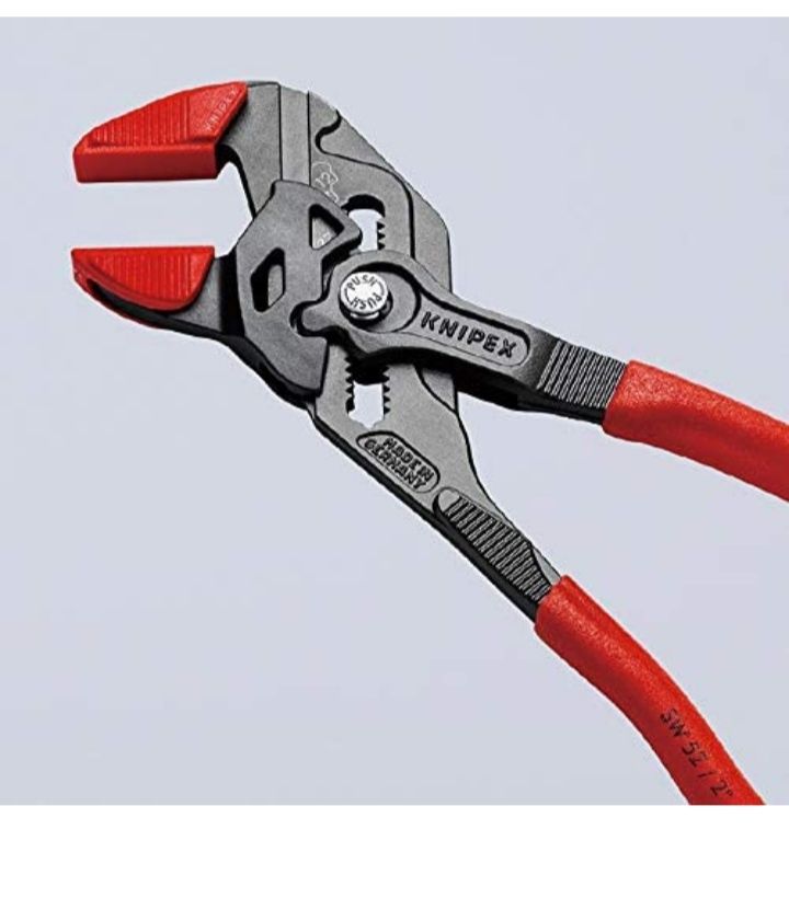

        Michael, they are incredibly useful, wouldn't want to be without them now I've owned them.
        If you ever consider buying any, the 180mm size are probably the best all round, the bigger sizes are a bit less natural to manipulate the size adjust.
        The updated 180mm size in black finish also have the ability to fit removable plastic Jaws, useful for chrome bathroom fittings etc.

          Yes, those Knipex "Plier Wrench" things do look extremely useful. If you push them to the limit, what breaks first? Are they as strong as an conventional adjustable spanner?
          Are the steps roughly the right size? i.e. If your nut is an odd size do you ever find that the handles are either too widely or too narrowly spaced?
          However for me I want something that will robustly clamp onto a part when I release my hands.
          i.e. Sometimes it's about stopping a hidden nut from turning at the other end of a bolt you are turning. And at other times it's about literally using the the tool as a precision vice to hold a part (using a larger vice to hold the base).

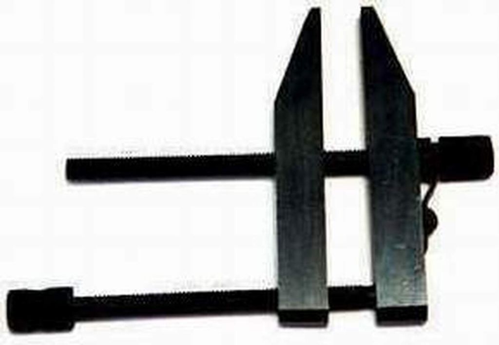

            That's two completely different jobs, requiring completely different tools. Trying to do both with one will inevitably lead to compromises that make it less than ideal for either. No wonder the tool you are looking for "has not been invented yet".
            For your first scenario, if you absolutely can't use a proper spanner, and can't bring yourself to use Mole Grips AKA Vice Grips in a pinch, you need a locking wrench like below. Combines a shifting spanner with a Mole Grip locking handle mechanism. The jaw stays parallel (withing the necessary working clearances of a shifting spanner jaw) and it clamps on tight.The Vice Grip action acts on the adjusting screw, not the jaw directly.
            Then for your second scenario, holding small parts firm while work is performed on them, perhaps while itself being held in a larger bench vice etc, the correct tool is a toolmaker's clamp. They come in a wide variety of sizes and styles, some with one leg extended longer to clamp in a bench vice, others with one screw only so access to the other side is open.
            You are wasting your time searching for a magical unicorn tool that will do both these functions well. Use the right tool for the right job. Obviously the locking wrench could be used to hold small parts but the tapered handle profile will not clamp well in a vice. And the toolmaker's clamp could be clamped on to a nut but needs more access space than the proper spanner for the job.

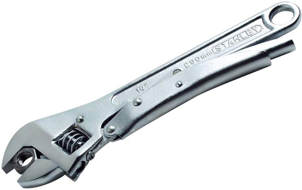

                          @Hopper – I'm going to ignore your comments that in your opinion the two completely different jobs, MUST require completely different tools.
                          At first blush it looks like that Stanley tool could be the holy grail!
                          Unforunately the build quality is not great and it seems that it is quite easy to destroy them.
                          Other makes seem to be available, e.g.:
                          – "Craftsman Extreme Grip 10" Adjustable Wrench" RRP £98.00(!)
                          https://www.homeloft.uk/products/craftsman-extreme-grip-10-adjustable-wrench
                          Makita B-65470 Locking Adjustable Wrench
                          https://www.amazon.co.uk/B-65470-Locking-Adjustable-Wrench-250mm/dp/B085DZWPL7
                          They all look pretty similar. It looks like they are being made under license. I am tempted to buy one but the design does look rather weak to me. It would be interesting to know what fails first under load… but I'll have a think.

                                  I can report that the comments about the Stanley tool are unfounded. I have had and used one of these for some years now and can’t imagine that they would “be quite easy to destroy”. I think to do so would require a level of clumsyness that I find difficult to imagine exists among this group.
                                  Build quality is in the eye of the beholder, try one they really do work.

                                        I have to say that the Stanley mole type spanner is extremely handy and sometimes gives you a spare hand when working on plumbing jobs. Whilst I would not like to exert a huge torque on it it is more than adequate for its job.
                                        It is not a bench vice and could not replace one but it has a place in the toolbox.

                                                Yes I I have used the spanner on very tight nuts. The technique is to wind the jaws in as tight as possible on the thumb screw with the locking mechanism open then apply the locking action, this removes any play that may have been there. I have never used it as a small piece work holding device but it has occurred to me in the past(before this thread started) that it gripped nuts firmly. Typically I use it as a third hand (typically on the underside of a chassis) where it grips a nut and can be left to its own devices whilst I have at the bolt head with two hands. I was recommended the tool by a fellow vintage motorist and I found mine on Amazon by its reference number which is embossed on the handle.
