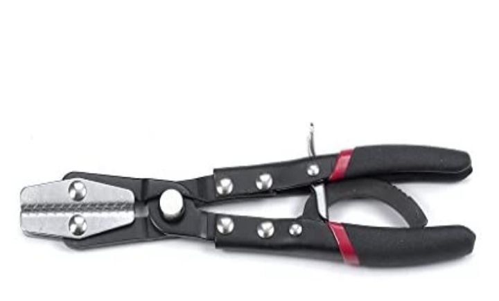

      It is possible to buy pliers that have genuinely parallel jaws which can be locked like a pair of Mole self-grip pliers?
      i.e. I am looking for a fusion between:
      A)
      and
      B)
      I want completely parallel sides so as not to damage the part.
      The nearest I could find was this:
      But firstly, I don't want that cumbersome sticking out leg (although if pushed I suppose I could cut it off!)…
      …but more importantly, the jaws rotating towards each other rather than moving in parallel towards each other.

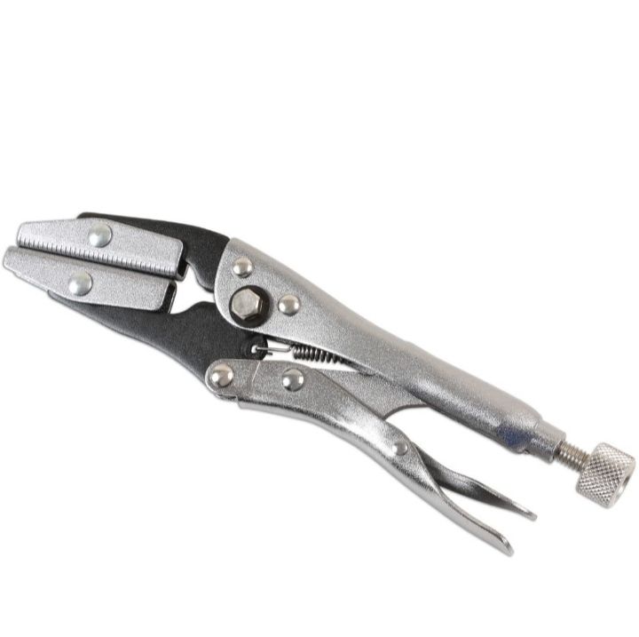

                  I have a couple of parallel jawed pliers that lock onto the item being gripped. They are called Speetog plier clamps and they look like this;
                  The screw on top closes the jaw and determined the amount of holding force.
                  They don't appear to be made any more but sometimes turn up on ebay etc.

                    I've had a CK Parallel-Grip Perfect for many years which does have true parallel jaw movement but only a sliding sleeve to set size relying on friction to hold it in place. Grip is decent but not as good as the real thing. Appears to be discontinued.
                    The Stahlwille 65622250 in the misterworker link from DC31k has the same pivot geometry so should be properly parallel.
                    Geodore do a similar one as type 137 P with, apparently the same pivot arrangment. Looks to be a bit more expensive than the Stahlwille.
                    The one in the Cromwell link isn't parallel grip.
                    The general give-away for parallel action is three visible pivots arranged in a triangle. One on the handle, one on the jaw and one on the body. There is a forth pivot hidden inside that just peeks into view when fully open.
                    The ordinary, arcuate opening type only have two visible pivots. One on the handle and one on the body, both passing through the jaw forging.

                        I may well be incorrect, but I am pretty sure that none of the products linked to involve genuinely parallel jaw movement.
                        My original image A) does have genuinely parallel jaw movement because it has FOUR pivot points when are arranged parallel to each other in a rectangular/square design.
                        All the other product seem to have jaws in fact rotating around a pivot point. Although the impact may be subtle, at different degrees of jaw opening there amount of pressure on the part will be different at one end of the part compared to the other end of the part.
                        Either way, in order to minimise damage to the part I would like flat, not toothed jaws.
                        And I need it to clamp shut rather than lock in whatever position you got it to – if that makes any sense.
                        EDIT: Wait, the STAHLWILLE 65622250 seems to have a hidden fourth pivot point!
                        Here is the parallelogram
                        It's a clever design right enough! Although there seems to be an unnecessarily large number of layers of metal going on, so I wonder how strong it is in practice.
                        Either way I just don't like those teeth. But maybe one could get soft jaws for it. (Or yes, build if I have to!)

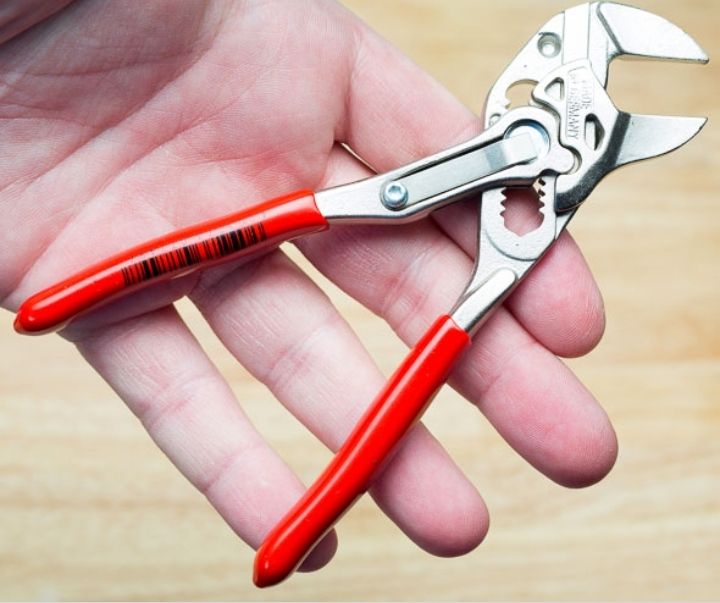

                                  Without knowing what they're for it's hard to know what is suitable, when you're asking for very specific tools, you should give the very specific use so people can understand what you're trying to do.
                                  These two pictures sound like what you are describing.
                                  Also knipex pliers wrench close completely parallel, and the jaw force is magnified ten fold from how hard you squeeze the handles, they're like a hand held vice, I use them for squeezing things together.

                                          @Pete – It seems I wasn't clear enough. Like I say, the problem with all plier that have freely hinged jaw faces is that it is almost impossible to apply the same pressure to both end of the jaws at the same time. Indeed the ONLY way that you could achieve this would be to insert a part EXACTLY between the two hinges.
                                          i.e. You have to locate a part at Position A.
                                          For a small part this is horrible, because it is surrounded by over-hanging jaws.
                                          i.e. If you locate a small part at Position B, the jaws just pivot and are no longer parallel.
                                          The only possible option to hold a small part at the end of the jaws (e.g. imaging a small 1x1x1cm cube) where you can easily work on them, would be to insert and part of identical with at the opposite end (i.e. Position C).

                                                  I have a pair of these truly parallel closing pliers which as I previously said, increase the jaw pressure ten fold from how hard the handles are squeezed, I use them for straightening sheet metal edges, holding things, squeezing things together, they're basically a hand held press.
                                                  Google image
                                                  #543601
                                                    Those look quite tidy, Pete yes
                                                    … is there much slop on the moving jaw ?
                                                    Ref. https://www.knipex.com/products/pipe-wrenches-and-water-pump-pliers/pliers-wrenches-pliers-and-a-wrench-in-a-single-tool/pliers-wrenchespliers-and-wrench-single-tool/8603125
                                                    Edited By Michael Gilligan on 06/05/2021 23:17:10
                                                    #543604
                                                    Pete.
                                                      @pete-2
                                                      Michael, there's no excessive slop imo, as soon as you put pressure on the Jaws there's no movement, I'm not sure how to embed youtube videos on here, but these have been reviewed a lot, I'd highly recommend taking a look at a video to get a better idea.
