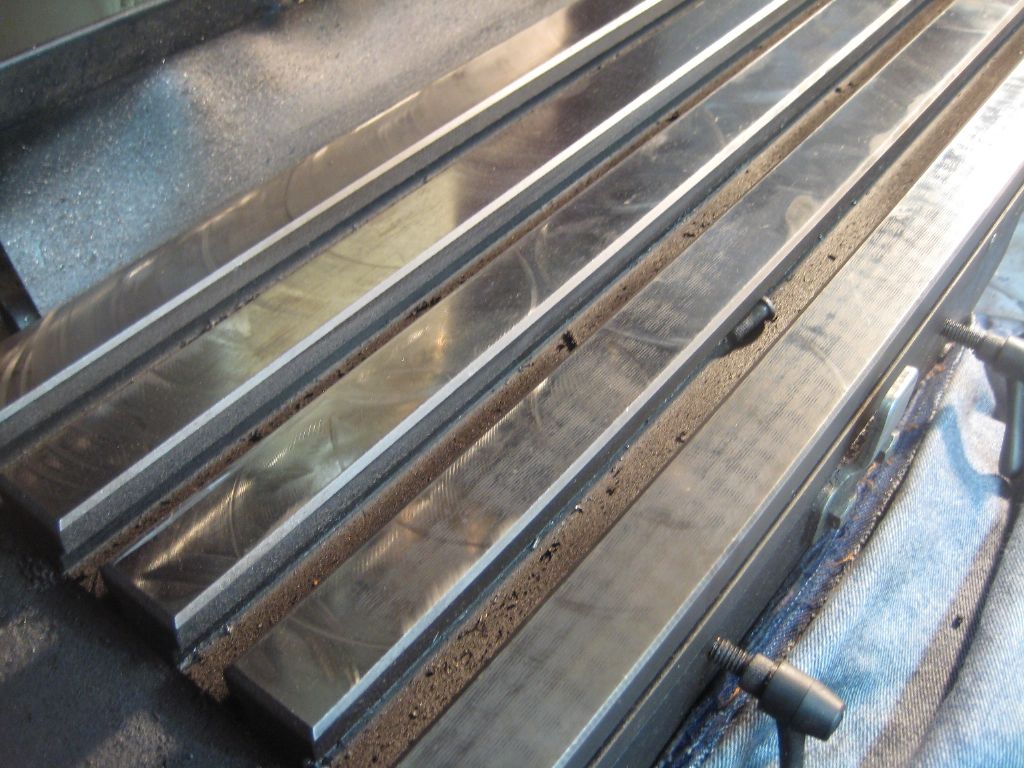

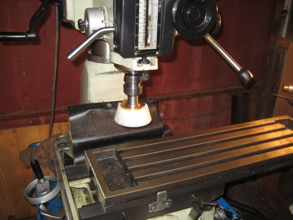

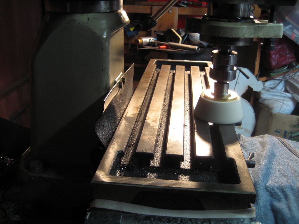

                          I have a Taiwanese mill/drill.  A fortnight ago I found to my great dismay
                          that I had a dip in the table.  I put a straight edge across the table and at
                          the deepest the dip measured just over 0.03mm
                          I removed the X axis leadscrew, made an arbour to fit an ER collet, put a
                          cup wheel in, let the mill run for three quarters of an hour to warm it up and
                          then ground the top flat.

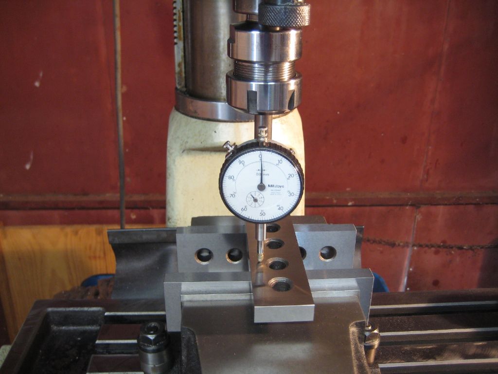

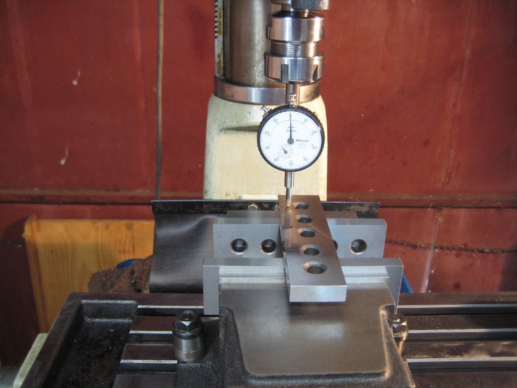

                          Once I put the vice back on, I checked the back jaw with a DTI and it read
                          zero from top to bottom.  Then I checked for bottom of the vice with a DI and it
                          too was zero from back to front.

                            Sorry, it took a little while to work out how to add photos.  Now I know.For an explanation, see my previous post.
