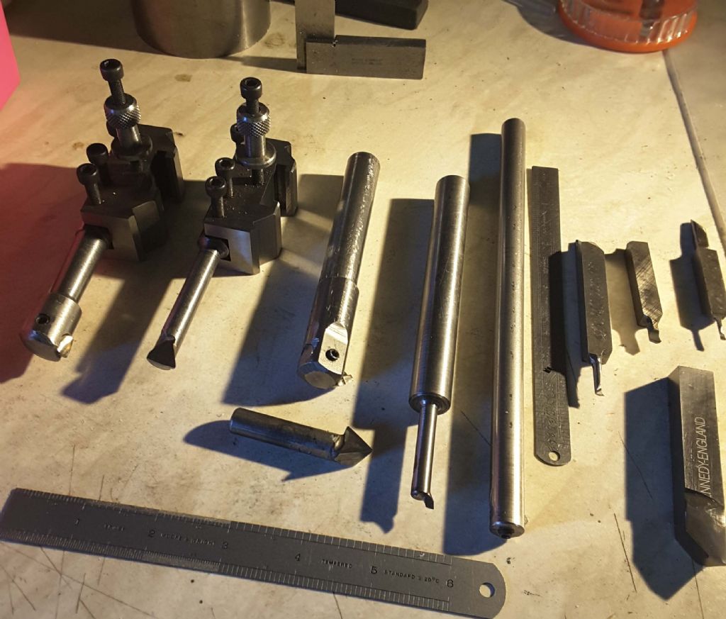

                What sort of boring tools are you making. I got a load of excellent HSS ones off ebay that were made by Deckel and mostly unused,they work brilliantly. Many people make similar using silver steel and then hardened.

                  I make my boring tools shanks from silver steel, turned down to the appropriate diameters, then cross drilling at the end at a suitable angle, normally circa 45 degrees to then fit and silver solder an old hss centre drill protruding through the hole. finally grind down the hss centre drill to the form you need. Silver soldering will not affect the hardness of the hss.

                    Some boring tools all are made by myself. Some are silver steel, some are high speed steel with grub screws, some have carbide tips silver soldered in place and some are made from solid high speed steel.
