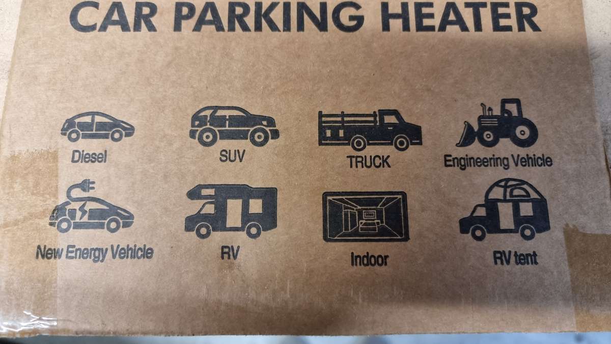

                                      MAIB don’t think they are a good idea on boats.
                                      https://assets.publishing.service.gov.uk/media/5f85ac6c8fa8f561ce5417d7/2020-SB2-Diversion.pdf
                                      A particular issue, even without failures, is the silencers on the vehicle ones are not gas tight by design (condensate drain hole I think) so they leak cardon monoxide.
                                      These heaters are not designed or approved for heating buildings. The cheap chinese ones probably have no valid approval for anything.

                                        Steviegtr
                                          @steviegtr
                                          Hi Robert, you are spot on. The guys I spoke to said most of the ones were replacements for the expensive to repair webasto etc. They said they use the exhaust from the existing heaters. They throw the supplied ones away. My friend did exactly the same. He had a Fairline Phantom 46. He was fed up with the heater failing & costing a arm & leg to fix. The marina he was in changed it for a Chinese cheapy. They also used the existing silencer setup from the old unit. So for once i do agree with you there.
                                          There was a company who build Motorhomes & they did a full review of them The only thing they knocked them on was the alloy housing inside the heater was a bit rough cast. They also noted the Ebersp & wabasto units had a waterproof connection to the ecu inside , the chinese ones just had a standard plug & skt arrangement.
                                          I can honestly say that I have been 100% satisfied for the little cost & how frugal it is. Especially as now i can get my Kerosene for £1 per litre. I just bought 50 litres. Which I am hoping will last all winter.
                                          Picture from side of packing box.
                                          Steve.
                                          20231201_231402[1]

                                                Use of the ‘Chinese heaters’ on a boat is quite different to the potential use in a workshop.  On a boat the heater will almost certainly have to be inboard whereas with a workshop the heater can be mounted externally and have just the hot air feed into the workshop and the return feed from the workshop.   Any combustion related issues are therefore completely decoupled from the workshop environment.  On this basis as a workshop heater, in a reasonably well insulated workshop, they work well with the air recirculated and most importantly relatively moisture free.   There is an example of an externally mounted heater on my blog.  I have also posted a design for a humidity monitor which could be used for turning on a heater or dehumidifier when dew point is reached.

                                                  Robert Atkinson 2
                                                    @robertatkinson2
                                                    While using a better exhaust and external mounting certainly help, they do not automatically make them safe. I’m not sure wrapping the air duct in bubblewrap, even on the inlet side, is a good idea. Rock or glass wool would be better.
                                                    A specific and potentially fatal failure on all this type of heater if cracking of the combustion chamber wall / heat exchanger. This allows toxic fumes into the airside. There have been several fatalities on aircraft due to this failure mode. Poor materials and quality control make failure more likely.  If anyone wonders why I am so concerned about this, I lost a relative due to CO from a incorrectly installed (DIY) heater. It is only a matter of ime before one of these causes a death. The cheap chinese e-bike and e-scooters have shown the danger of shoddy goods.
                                                    If you must use one of these heaters:
                                                    BUY AND USE a mains powered CARBON MONOXIDE ALARM.
