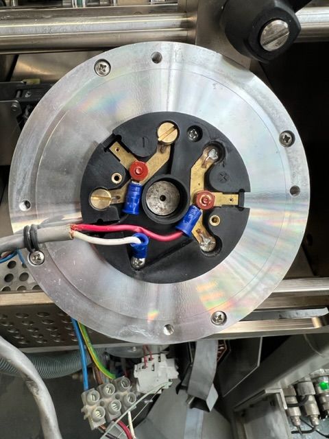

        I have a need for a motor like this one
        its dc 50v
        it needs to fit in a smallish space hence its build (like a pancake)

            Sorry for got to say its about 7 inches diameter and the alloy bit is about 3.5 inches long
            its a fairly powerful motor but i have no specs at all
            its fused by a 15 amp so I’m guessing it draws about 8-10 in use so 500 watts or so

              3 phase so probably designed for soft start. Variable speed fan application perhaps.

                3 Phase, where did that come from?
                Looks like a high torque DC motor, possibly a stacked printed armature as it has face commutator?

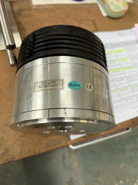

                        I've had a brief look, but can't find anything immediately similar.
                        4 pole DC high torque is a starting point, but I guess you need to look at the speed as well, unless you can tell from the driving circuitry whether it's a normal 4 pole, or some sort of a servo/stepper motor..
                        There might be similar stuff, but not the same, on AliExpress, though the CE marking and RoHs do look in the correct format for EU rather than China Export.
                        What's it from and what's the problem with it?

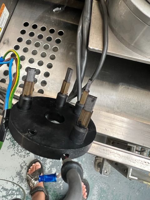

                          3-phase. My mistake. I saw 3 brushes but now I look again there are 4.

                            Hairy pete
                            it is off a longford

                              That’s the type but surely there must be a cheaper replacement

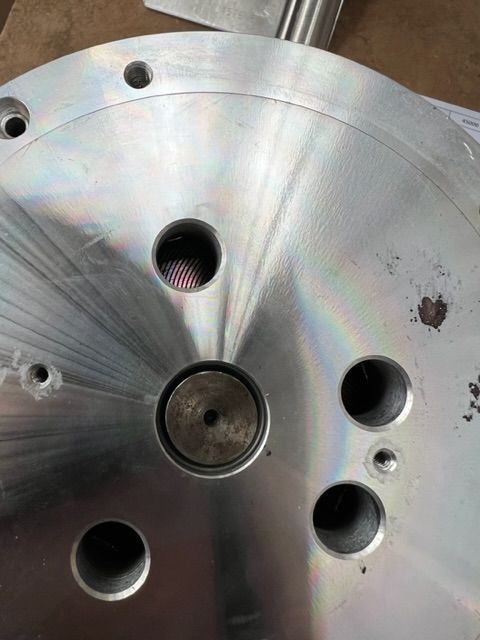

                                      Well it was blowing the fuse (15 amp) resistance between the leads was only 1 ohm on removing the brushes a strong smell of burnt windings..
                                      i may strip it down next week just for a look but I don’t think these types can be rewound/repaired economically
                                      in this machine it has to start for a preset time (sheets delivered) usually about 1 second then stop for perhaps 2 seconds then restart and do that for 12 hours a day…perhaps a better way would have been a induction motor running continuously via a clutch and brake
