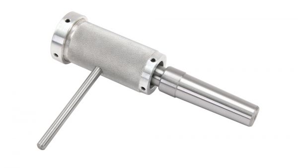

                      Paul Lousick
                        @paullousick59116
                        Use a sliding die holder in the tailstock especially on small threads in soft material that are too weak to pull the tailstock along. If the die does not travel with the cut it will just remove all of the metal down to the minor thread diameter and ruin hours of work. (don't ask how I know and what I said)
                        If the lathe is strugling to turn, do it manually by locking the chuck and turning the die holder by hand, backing off regularly to break the swarf.
                        Paul.
