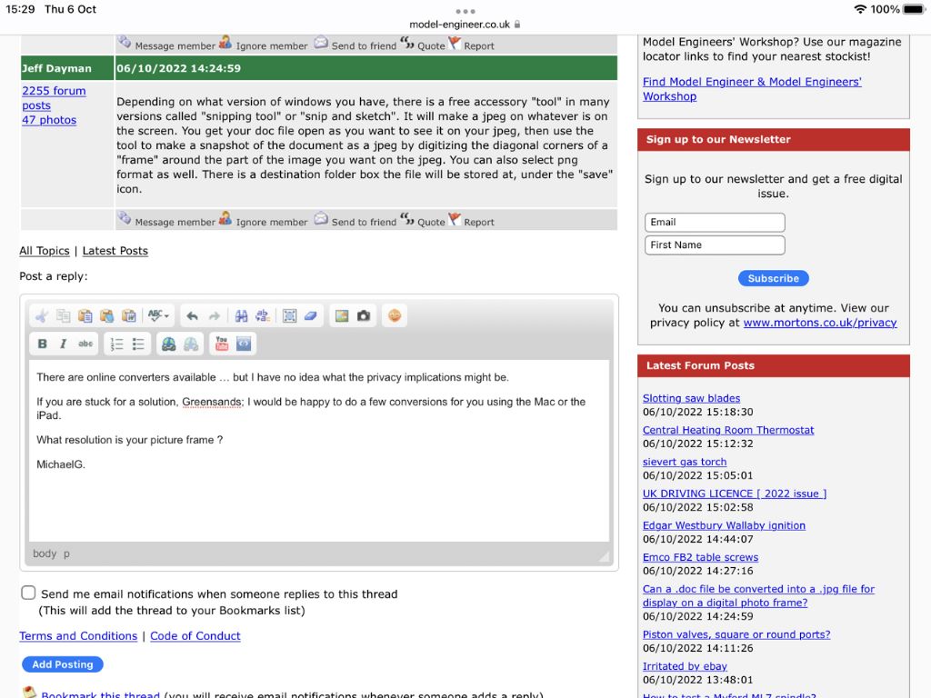

            Depending on what version of windows you have, there is a free accessory "tool" in many versions called "snipping tool" or "snip and sketch". It will make a jpeg on whatever is on the screen. You get your doc file open as you want to see it on your jpeg, then use the tool to make a snapshot of the document as a jpeg by digitizing the diagonal corners of a "frame" around the part of the image you want on the jpeg. You can also select png format as well. There is a destination folder box the file will be stored at, under the "save" icon.

              There are online converters available … but I have no idea what the privacy implications might be.
              If you are stuck for a solution, Greensands; I would be happy to do a few conversions for you using the Mac or the iPad.
              What resolution is your picture frame ?
              This jpg is 1280×960 … how does that look?

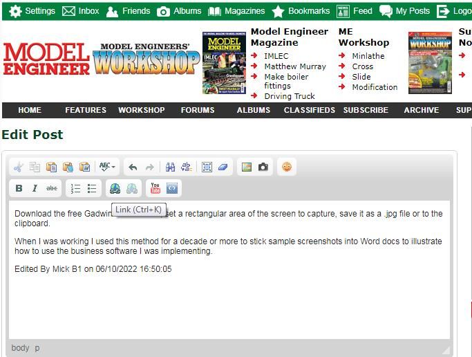

                      Download the free Gadwin Print Screen, set a rectangular area of the screen to capture, save it as a .jpg file or to the clipboard.
                      When I was working I used this method for a decade or more to stick sample screenshots into Word docs to illustrate how to use the business software I was implementing.

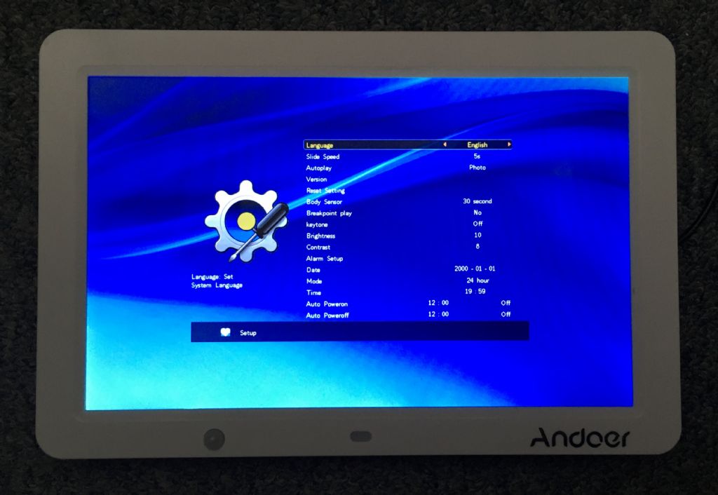

                                        Further to my PM, which I don’t think you have yet read
                                        I just remembered that I had this tucked away for a use similar to yours:
                                        It’s classed as a ‘Digital Photo Frame’ but it’s probably the best spec’d one I have seen.
                                        Not sure if they are still available, but you might try Amazon or ebay
                                        Edit: __ this appears to be their latest version, and even better !
                                        https://www.andoer.com/p-d3280b-eu.html
