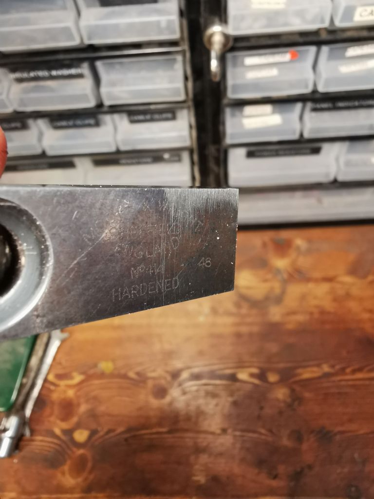

        So I have Moore and Wright Square which bellonged to my grandfather. Its an adjustable style one and it's model is 414. I'd quiet like to know its age. Next to the model no is the number 48 just on its own. Am I to assume this is 1948? The way its engraved makes me think it cant be that old. Looks like something which has been engraved on a computer. I may be wrong. I found another on ebay with no 52. Just curious if this is the date.
        Thanks,
        Simon

              #629408
              Simon Morrall
                @simonmorrall40901
                ​Thanks for all. The feedback! I've attached an image to this post.
                #629421
                Nicholas Farr
                  @nicholasfarr14254
                  Hi Simon, maybe it's just a quality control number of the person that checked it out.
                  Regards Nick.
