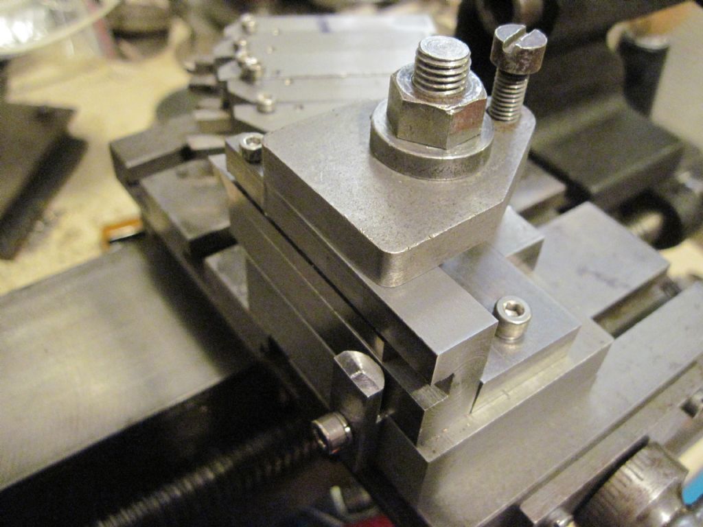

                                        Posted by IanT on 01/04/2016 09:03:22:
                                        So Dr Roses solution will (I think) suit my EW needs very well. They clearly would not suit everyone.
                                        Regards,
                                        IanT
                                        Always interesting to see your old posts pop up here.
                                        I still use 'Rose' blocks on my EW but the holding arrangements have changed very slightly over time. There is now a restraint on the rear of the tool holder to stop the tool block moving under cutting pressure (mainly happens if the block's base isn't flat). The top part of the tool holder can also be angled by removing the cap screw – but it normally holds the tool blocks at right angles to the lathe axis (or face – tools can be clamped in two positions). So very simple to make tool blocks and easy to use. Not for everyone perhaps but the original QCTH is now only used for a few tools that can't be fitted to the blocks.
                                        Regards,
                                        IanT
                                        PS Keep meaning to make a lever replacement for the large clamping nut but it never quite seems to get to the top of the round TUIT list….
                                        Rose Toolholder

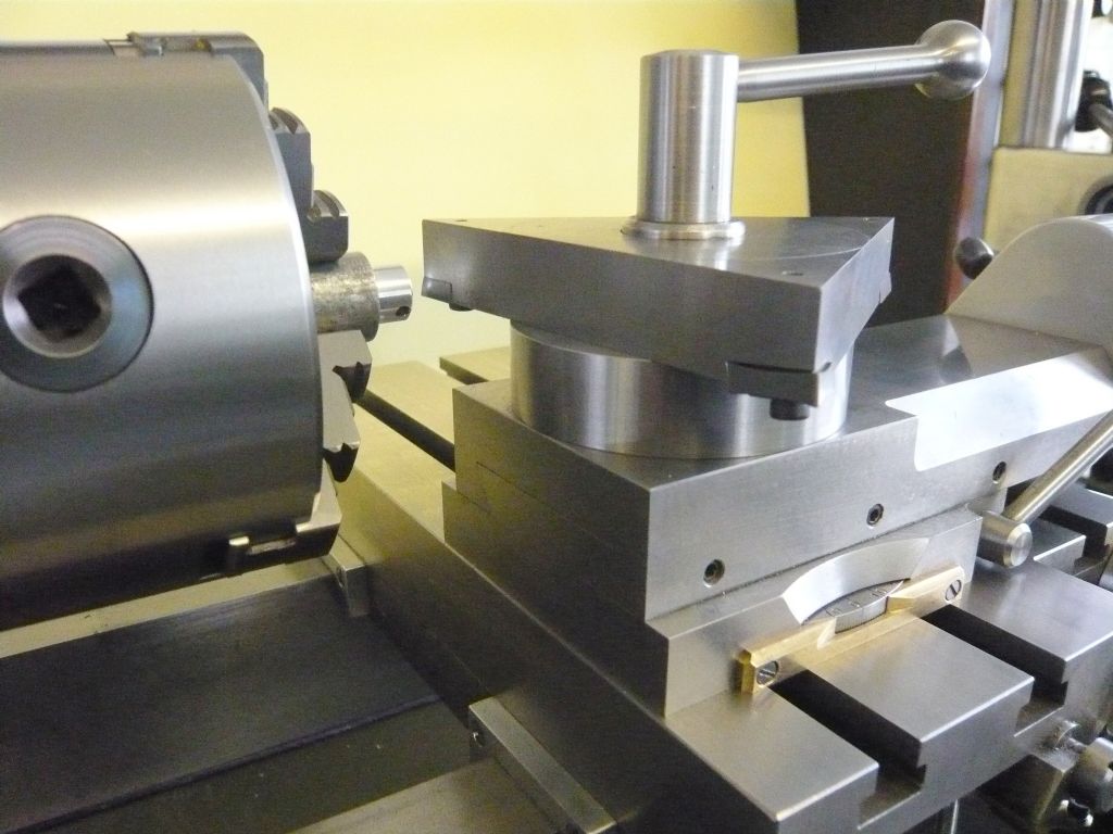

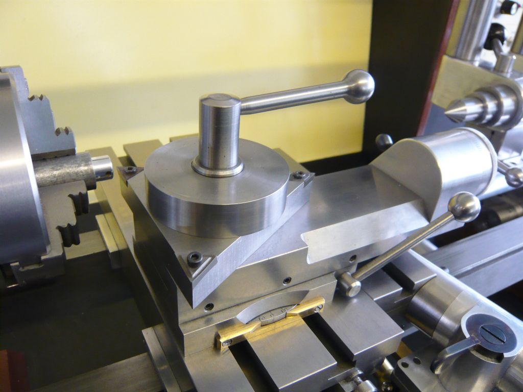

                                          I use this triangular toolpost, which can be also used by mounting the circular spacer block beneath the triangular toolholder and the spindle run in reverse (if it is safe for your lathe to cut this way) I think it gets a slightly better finish this way.
                                          Alan
