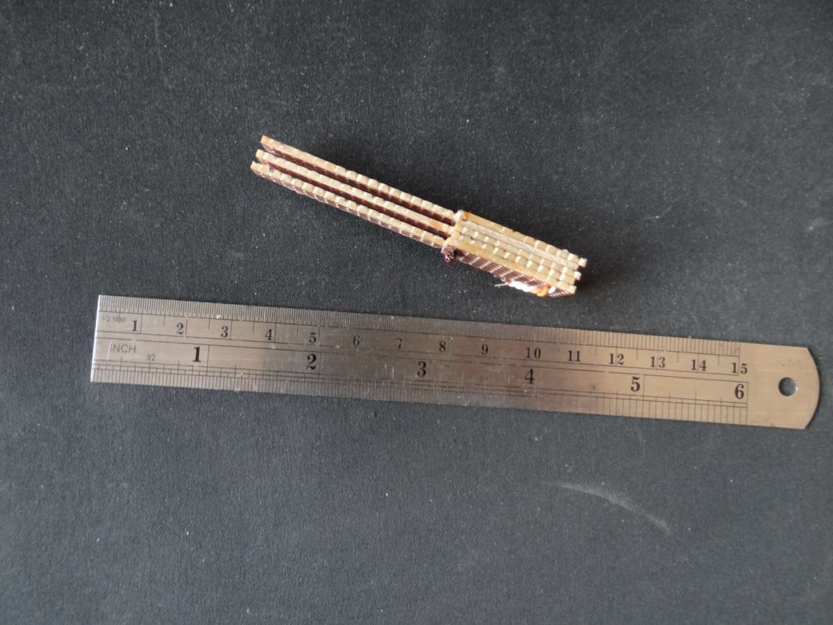

          A bitty day yesterday, but useful progress:
          Found a website with a good technical explanation of Enigma internals.  Including how the machine steps.  Quite interesting to see what I guessed correctly and what I got wrong!
          Mocked up a SPDT switch made of strip-board to see how springy it is.  Result over short travel is encouraging.  Needs to be tested over a realistic long travel though and it might fail after many operations.

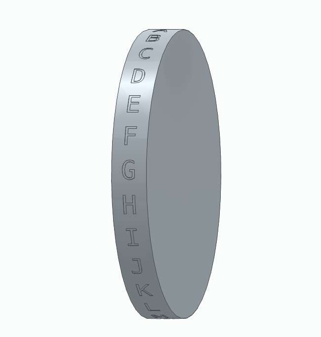

          Got a better understanding of what might be going wrong with wheel lettering.  Many failures!  Next picture shows success, SE just did it, no aggro:
          testwheel
          One cause of trouble is letter selection.  When hovering with the mouse, SE highlights snap opportunities hidden behind, and, if the part is in an assembly, it shows snap possibilities in other parts as well.  Chaos ensues if one of these is accidentally selected with the letters, and it can  break the model!  When letters are embossed correctly by Normal Protrusion, the operation can be undone.  However, if the emboss was incorrect, perhaps because of an accidental extra selection, then Normal Protrusion is damaged internally, and it may be necessary to delete everything.   Also discovered that letter height appears to be nominal – 6mm Ariel is not the same height as 6mm DejaVue.

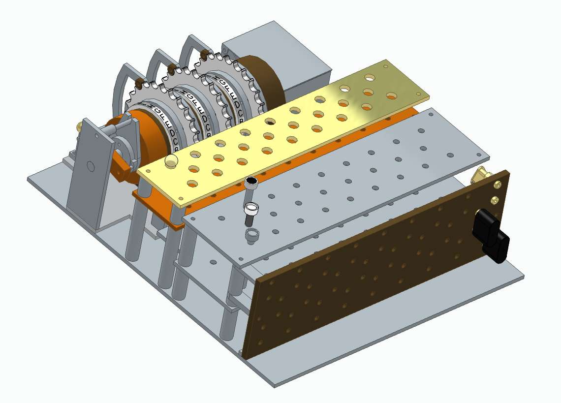

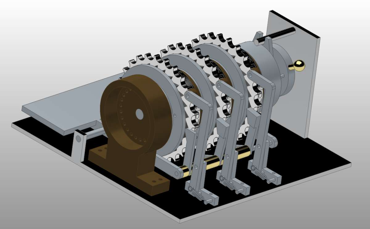

            I’ve started the Mk2 model, this one approximately full size, and benefiting from new information received.
            Turns out the rotors and rotor assembly are more complicated than I thought, and though closer, my latest attempt is still off target.   More work needed!
            enigmaFSfrontFeb5
            enigmaFSrearFeb5
            Long list of corrections to do!  For example, I’ve separated the odometer drive pawls along their axle with brass spacers, when the original uses coil springs.   The coil springs push the pawl into the ratchet as well as space the levers.  My rotors are too fat,  and the roller arms are tensioned the wrong way round.  I guessed extension springs, a close look at real pictures suggests compression springs.

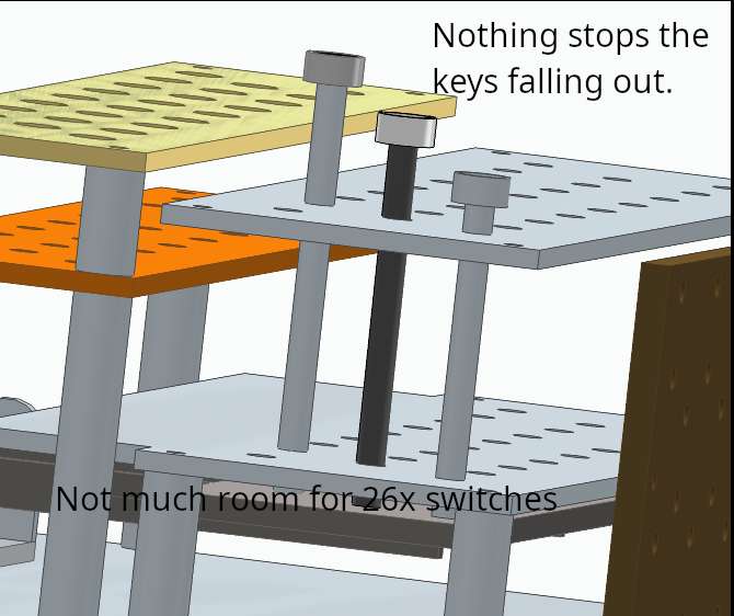

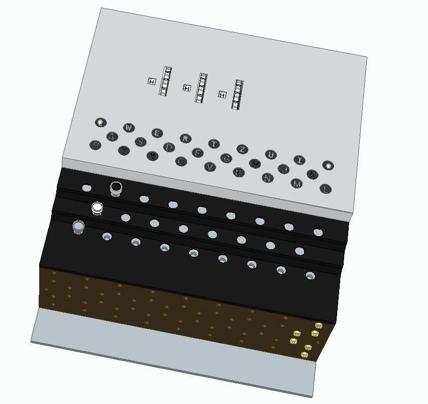

              WW2 continues in Castle Duffer with mixed progress on Project Enigma.  Added a battery box, plugs, key platform, lamp holders, and many tidy ups.   Keep finding new subtleties in the original machine and more Solid Edge feature.   Decided to follow Jason’s advice and CAD my own springs:  partly for the learning, and partly because searching catalogues is boring!   (Back to the catalogue if I ever build this for real, I will have to buy them!)
              The real machine is built on pillars, and I think my version is ugly:
              enigmakeys13f
              Also, unsolved problems with the keys and how on earth I will I squeeze 26 switches into the space available.  There must be 3 banks of switches in the photos and I can only see two.  Possibly one is double-banked in some way.
              enigma12febfs
              Still have to debug why the mechanism doesn’t animate properly, design the lid, add a rheostat, and surround the whole with a wooden box.  And I’m sure there’s plenty I’ve missed. In theory I could CAD the wiring loom.   Tempting after a tiring day to develop a closed box and claim there’s a finished Enigma inside that could be shown working except I’ve lost the key.  The beast needs beautifying too, the parts are all rather blocky – unfinished.
              If anyone thinks CAD is easy, this version contains 74 unique parts in 21 sub-assemblies, all mated together and sized in a geometry allowing the thing to animate correctly.  Fasteners not included.   This is not a drawing!
              Sadly for me Enigma can be emulated on a £4 Arduino and someone else has already written the code…

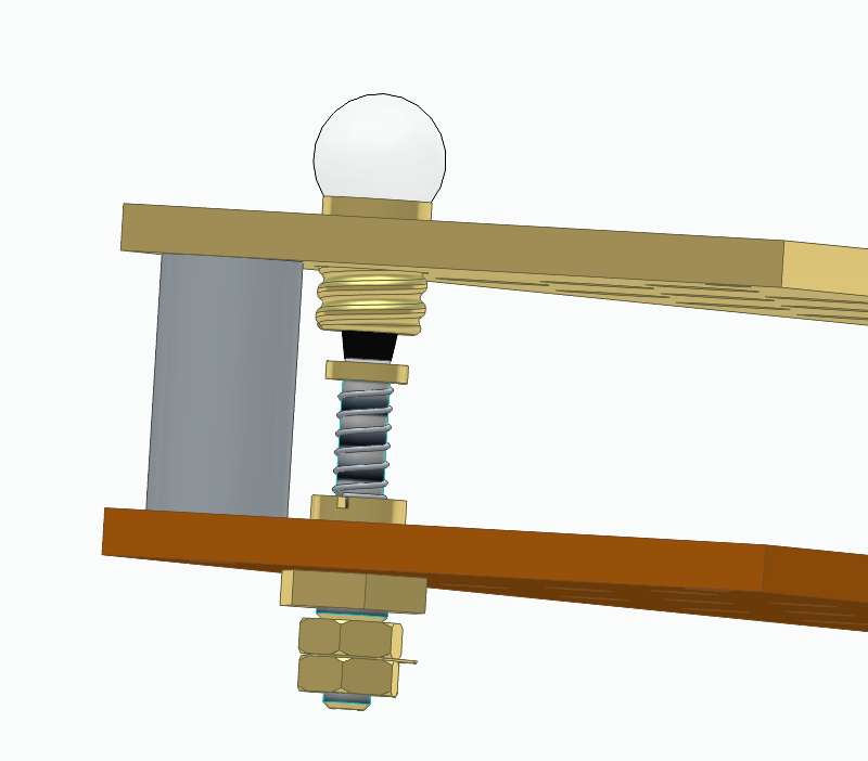

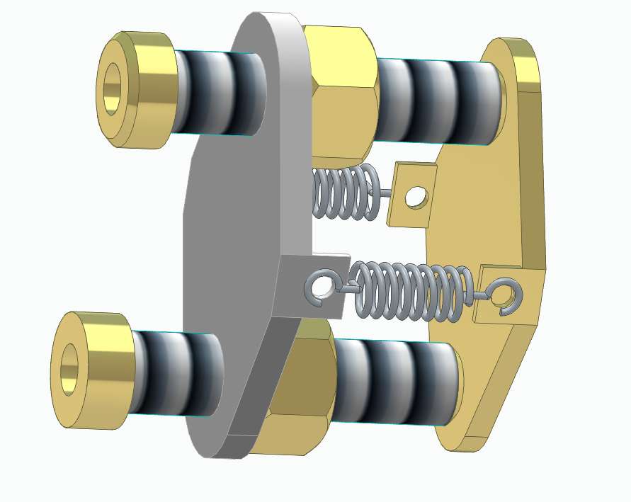

                  Using mono jacks is a good way of saving time, ditto lamp holders, or even LEDs.  The amount of work in replicating the original components is significant, here’s the equivalent of the mono-jack, actually a little more complicated than it appears because there are two insulated pushers inside the sockets:
                  enigmaSocketPair
                  And the German lamp holders are remarkably solid, perhaps intended to be Milspec shock-proof:
                  enigmaLamoAssy
                  Another possibility is the complexity is due to design starting in 1919 before standard lamp holders and such were available.  Though I thought telephone systems had them by then.  Right pain to make though, especially in a workshop not set up for production work.

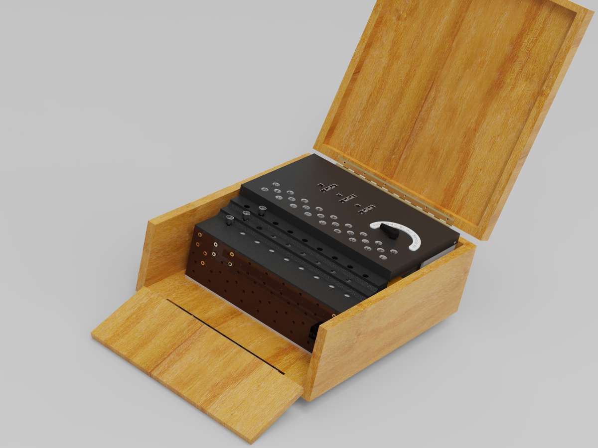

                    As predicted putting the covers on hides a multitude of sins!
                    enigmaLidded
                    Both covers took about 15 minutes before I was torpedoed.   The rotor assembly was too low, meaning an operator couldn’t set the spur wheels or read the rotor letters.   Led to another ramble in the rough working out how to lift it without breaking every moving part in the rotor assembly, scary!  Can’t just be jacked up because the rotors are linked to the thumb-wheel locks, and the odometer drive pawls, and they’re connected to the keyboard. Fixing that lot took a couple of hours.  Need to increase the diameter of the spur wheels and the rotor letter wheels, both fussy jobs.  Solid Edge doesn’t seem to allow objects modified around the circumference to be edited in the usual way, hmmm.
                    Also added the lamp letters, and struggled to paint them black.  Q and O aren’t in-filled properly even though other letters like A B & D took the paint correctly.   Possible software bug.
                    Next challenge is the plastic light shield.  Fits under the lid I guess to concentrate light under the working bulb and stop it confusing the operator by shining through adjacent windows.  Looks like 26 double curved bevels moulded in a plastic plate and I’m not sure how to model the curves.

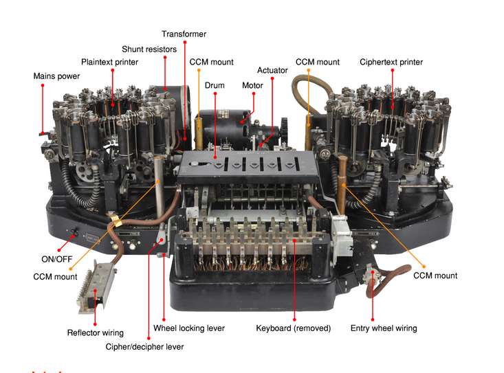

                        That page is for a Lorenz, a different machine, but the size is still uncertain.  I think the Lorenz was bigger and heavier than an Enigma.  These ladies give an idea:
                        lorenzescale
                        My book covers Lorenz up to a point.  Enigma was man portable, approx typewriter size, so could be used tactically and in ships and submarines.  Needed two men to operate, ideally 3, and the handwritten output was handed to a radio operator who sent it in morse code.  Clumsy!
                        Lorenz was a teleprinter system, sending 6 bit baudot code ideally over a landline connecting fixed headquarters.   One man operation, no morse, except it took a lorry to move one.  However, because landlines were often cut or not available, the Nazi’s were forced to use radio links.   A major communication centre in Konigsberg, then East Prussia, now Russian Kaliningrad, linked Berlin to Norway, Finland and the northern Russian Front by radio, all intercepted in the UK off the back of the aerial.  The Lorenz cypher, in theory stronger than Enigma but flawed, was also broken, again mostly due to operators breaking the rules.
                        Anyway, not found a source giving measured dimensions for any of these machines. Based on photos with people in them Enigma was about the size of a typewriter, so I’m only accurate to within a hands breadth!   If I was well I’d make contact via SMEE and drive to Bletchley with a camera and tape measure.

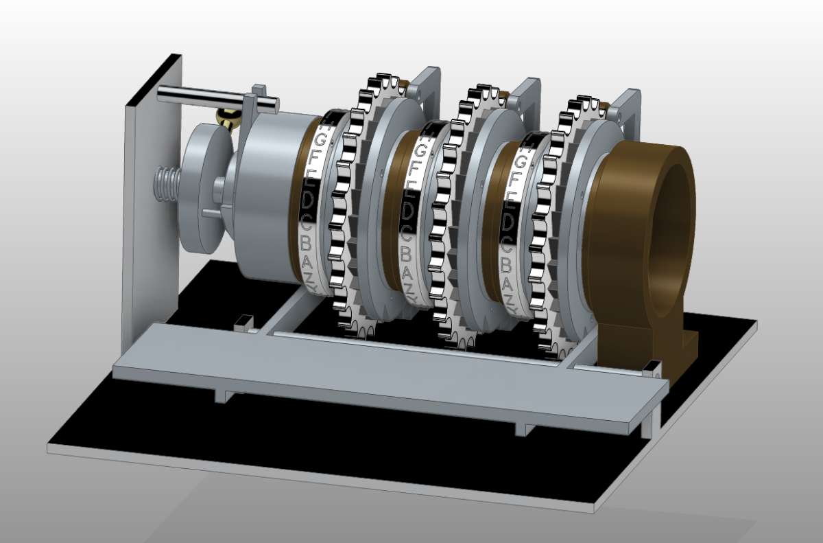

                                      Health permitting still plodding away at Enigma, 95 parts in 26 assemblies and rising.  Going well but finding many misunderstandings and missing details when carefully comparing my guesswork with the real McCoy.
                                      For example, I sussed that the rotor assembly is released by the operator turning a handle on a cam,  and designed this:
                                      enigmaCam
                                      The real cam, found in a photo, is like this, held by means unknown inside the reflector case:
                                      reflectorCAM2
