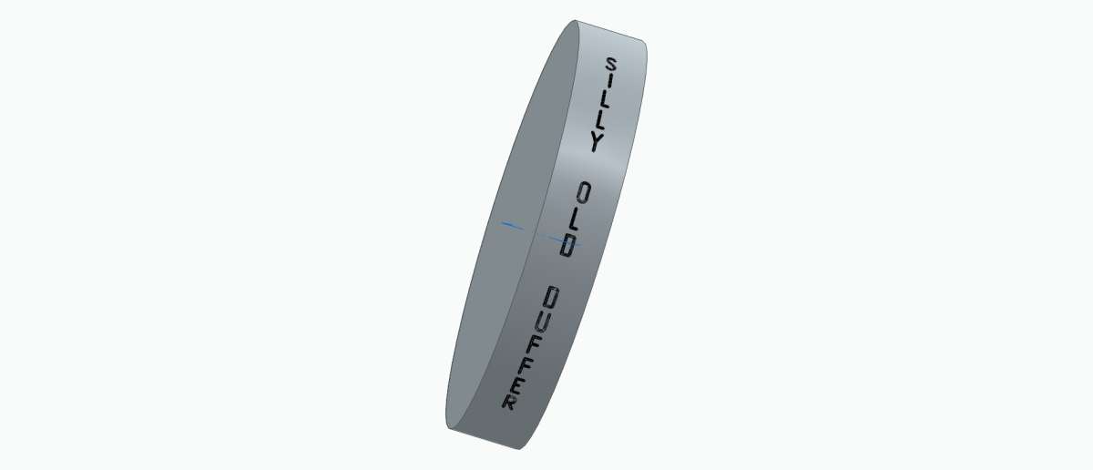

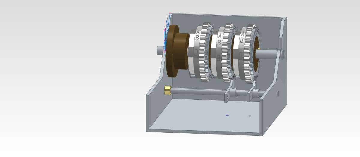

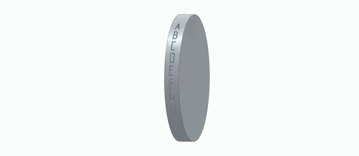

              As the letters problem isn’t a showstopper, I’ve moved the model forward somewhat.   In a real Enigma the operator had to change the rotor order, and had six to ten to choose from as per the daily key settings.
              Therefore I changed the frame to allow the reflector and 3 rotors to be lifted out and dropped back in.   Almost sure to be too simple: German engineering will have had a nice release catch and maybe bearings too.  The rightmost rotor has to connect to a feeder box, and how that was arranged isn’t obvious.
              Added two pawls to engage with the ratchets, and the axle needed to support them. The levers and frame are drilled to take coil springs, which I thought SE community edition provided in a library. Nope, I shall have to model them!
              enigmaAssy21Jan
              Back to the letter problem next, many thanks for the suggestions – much appreciated.

                      Let joy be unbounded!  I think I’ve cracked it.
                      Ian’s coincident plane advice didn’t work, but it got me somewhere.  Like other attempts Ian’s suggestion, which works for him, failed at my last stage – the Extrude.   I wondered if Extrude is the right tool for this, and it isn’t.   Hidden away in the Add subsection of the Solids toolbar, there’s another tool , it’s labelled ‘Normal Protrusion’ :
                      normalProtrusion
                      It allows all the text to be selected, and then does a cut or add that works, hurrah!
                      verticalOK
                      Taken several hours to break this problem, and the answer is simple.  But only when you know how.   I’ll explore further, but this feels like a breakthrough.
                      Thanks for suggestions, all very helpful even if not spot on – made me think out of my box.
                      Cheers,

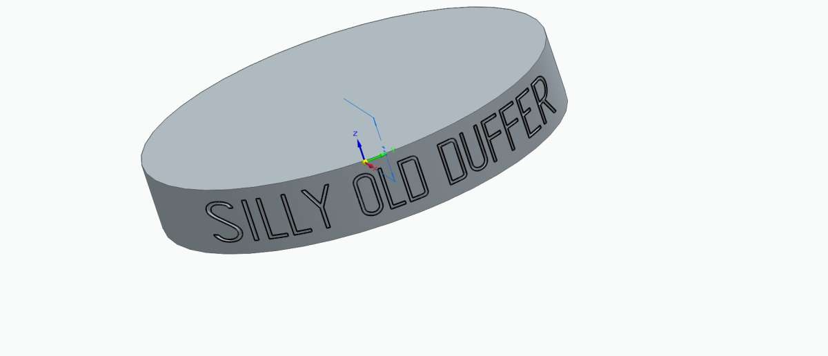

                            No, for this –  ‘Project’ distorts the beginning & end of the Text if you go too far around the cylinder face with a larger font- but ‘Wrap Sketch’ works just fine.
                            Hard to see the ‘Cut’ in the image below (as I probably set it too deep at 0.75mm) but it’s there….   🙂
                            Regards,
                            Ian

                              Depressing news from Nick! Thought the lettering problem was solved, and it’s not.   I shall have to have another go.
                              Which version of Solid Edge are you using Nick?
                              I’m Solid Edge Academic, Community Edition, Node Locked, version 2310 (build 224.00.00.101 x64)
                              Font selected in the Text Profile tool is the default: Solid Edge ISO,  script Western.
                              Ta,

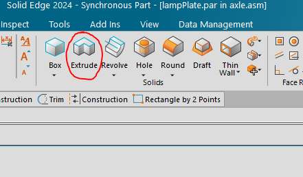

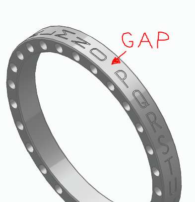

                                      Ah, the problem is what happens after the wrap.  I expected to grab the text outline with the extrude tool, and it malfunctions. Red ring below.
                                      seextrude
                                      Although Extrude fails, Cut Normal works, up to a point.
                                      SEnormalcut
                                      ‘Normal’ allows letters to be selected, and, provided the angle from the tangent plane to the surface isn’t acute, up to seven 3mm letters engrave correctly onto a segment of the 35mm ring.  More than 7 causes a ‘does not lie on face’ errors.
                                      Are you using the Extrude tool or Normal?  Or something else!

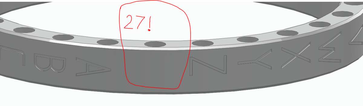

                                      I managed to letter the ring almost correctly.  The maths calculating the needed letter height is wrong, don’t know why – circumference of ring = 110mm, so I expected 4.23mm.  By eye 3.15mm is closer, but it still caused a gap:
                                      sewheelgap
                                      Spotted a nastier mistake. Appears the number of index holes wrong, which means the pins are bad too.  26 letters should align with 26 index holes, and there seem to be 27.
                                      SEwheel27
                                      Aargh!

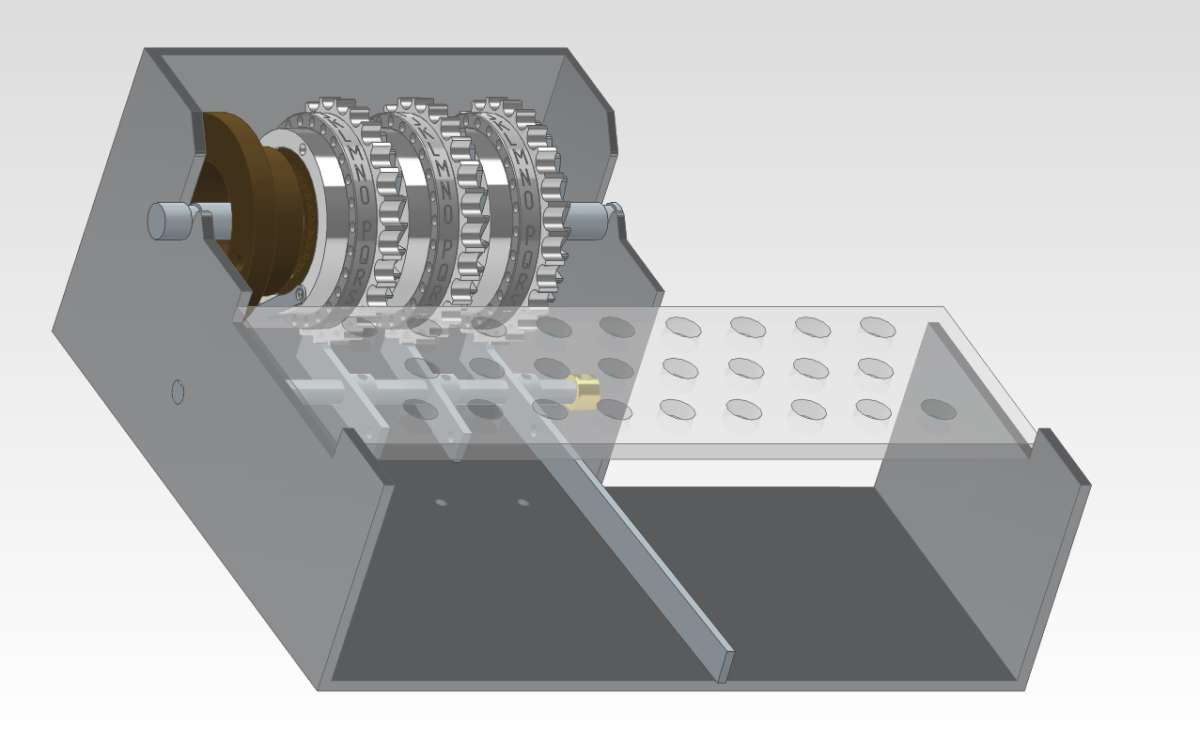

                                        Progress so far:
                                        • Updated the lettered ring, still wrong, but looks better!
                                        • Added the pawl and lever that rotates the rightmost rotor when keys are pressed.
                                        • Added the lamp bulb plate
                                        • Altered the frame to suit additions.
                                        seenigmaupdate
                                        Missing:
                                        • Some way of turning the rotors in succession like an odometer.  No idea how to do that.
                                        • How to fit the right hand connector box such that the rotor assembly can be lifted out and replaced withou breaking anything
                                        • How the electrical part of the keys will work
                                        • The plugboard.  (Which incorporates switches.)
                                        Way ahead fairly clear, maybe:
                                        • The key mechanics.
                                        Thoughts on production:
                                        • As mentioned much earlier, the electrical contact pins need to be sprung to ensure good contact.  Plan B was to buy some, but I think I can get enough spring from a simple arrangement of bent washers or squishy O-rings.  Means nothing needs to be bought in apart from the lamps and the battery.
                                        • Even if I double the size of the pins, they’re awkwardly small and 208 are needed.
                                        • At present the frame assumes it will be 3D-printed or cut from a solid block!   I think not!  Later, I’ll twaek the design so it can be made by bending sheet metal.
                                        • Though I’ve kept “how will I make this” in mind throughout, the design may have over-complicated details.
                                        • The idea is to 3D-print most of in plastic supported by metal.  More work…

                                        • The letter and pin miscount issue.  I’ve accidentally modelled 27, should be 26.

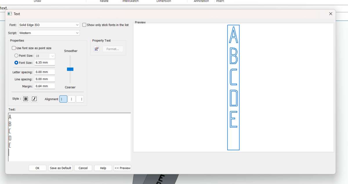

                                              Yes, I used ‘Cut, Normal’ Dave but I didn’t notice any problem.
                                              The ‘gap’ between the letters is (I suspect) most likely finger trouble when you were typing your letter stack (which is how I assume you got the vertical lettering?)
                                              Your ‘Text Sketch’ has to ‘Wrap’ to the cylinder circumference exactly, in order to get equally spaced letters around the rim (including the ends – the A to Z bit) – which I’ve not done & sounds tricky.  🙂
                                              Thus far I’ve only had to change the font & font size to meet my needs but there are other text parameters to play with of course. I suspect there’s an easier way to do this in SE (there usually is) but for now I can only suggest experimenting with the letter & line spacing to adjust the wrap sketch to size – I don’t think you’ll be able to just dimension it – though there are lot’s of things I couldn’t do with SE just a few years back that I can do now.
                                              Just a thought – are you using ‘Ordered’ ?

                                              #779284
                                                I was using the Extrude tool, not the ‘Cut Normal’ tool.  Seems ‘Cut Normal’ is needed for cutting into a curved surface, probably because it’s a special case.  One that SE’s Extrude doesn’t handle properly.   Note for beginners, beware terminology.  Extrude has a general meaning, but SE implements it with two different tools.  The Extrude tool is a specific thing, and ‘Cut Normal’ another.  Loosely they both extrude, but they aren’t interchangeable.
                                                Yes, not finger trouble though.  The Text Profile tool allows letter height and line spacing to be set.  I did the sums: circumference = 110mm.   110/26 = 4.23mm, therefore letter height=4mm and line space = 0.23mm.  Either I’ve got the maths wrong, or the logic, or SE doesn’t maintain letter height accurately when projected to a curve.  I’ll have to experiment!   At the moment, I’m assuming the mistake is me rather than SE!  Perhaps a ‘fence post error‘.
                                                Agreed.
                                                Now I’m used to it, I stay in Synchronous mode as much as possible, only going Ordered when synchronous gets confused, or I can’t get it to play, which is rare.  I experimented with this problem in Ordered mode, and found Ordered-Extrude doesn’t work properly with wrapped profiles either.   Different error messages.
                                                Regards,
                                                IanT
                                                Now I’ve got a workable answer I’m going to leave letters on the back burner for a while.  As it’s not bottomed out, I’ll have to come back to it.
                                                Thanks for help and advice – very helpful!
                                                Cheers
                                                #779303

                                                    David Jupp
                                                      @davidjupp51506
                                                      Dave,
                                                      I modelled a simple wheel with the wrapped 26 letters.
                                                      Your 4mm character height with 4.23mm line spacing gave a slightly enlarged gap between Z and A
                                                      If I did the sums to another decimal place 110/26 = (approx.) 4.231  than the result was near perfect.
                                                      NOTE: Alibre has a setting for if Height relates to Font Height or Character Extents – it does make a subtle difference in this case.
