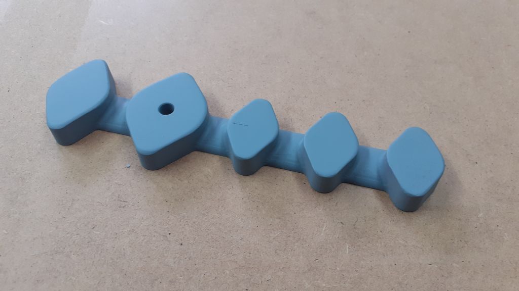

                  The CNC can do simple parts quite quickly but as I still like to do manual machining like many others I tend to keep it for items that are where it really comes into its own such as those curved in 2 or 3 dimensions.
                  Most of what I do it the CNC are one offs and the setup time is not that long, often just putting a block of metal into the vice and locating it just as you would any part on a manual machine. Take something like that stick of flanges I posted earlier, would have needed setting up 5 times on the rotary table to do the basic outlines and then either another 10 times to do the smaller curves or a lot of filing with buttons. Plus you can always be making something on the manual machines while the CNC is doing it's own thing.
                  Funny enough When asked if I could make the pattern I did say why bother as the average builder likely to me making the engine could make the flanges from bar stock on the rotary table so castings are really superflous
                  I know of a builder on another forum that has done away with most of his manual machines, just keeping a larger lathe as non CNC. He produces every part on his CNC mill and CNC lathe using wizards for simple parts and somewhat outdated software for much of the other which needs a lot more input on his part to produce the parts. These are not simple engines but multi cylinder aero and racing car engine in miniature.
                  Edited By JasonB on 05/04/2022 16:16:28

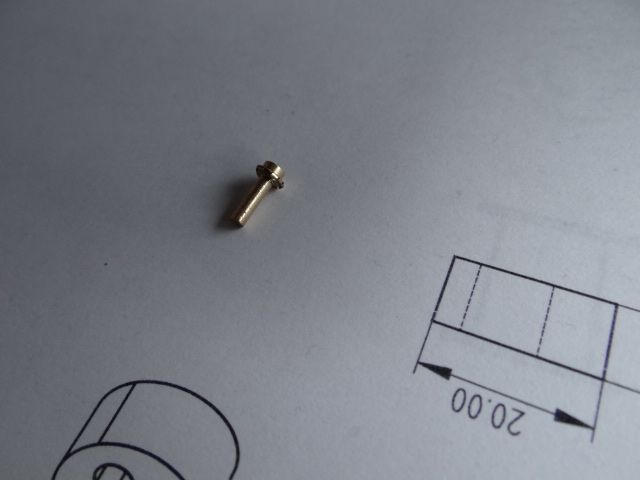

                                Fascinating, I bow to your superior understanding and experience.
                                I still imagine there's a minimum part where CNC isn't worth the effort, but now I don't know what it is! Last thing I made on my lathe was this ⌀2.5mm Brass Pin with Top Hat:
                                As only the diameter and shank length are critical, I made this in a couple of minutes by bunging a brass rod in the lathe.  I only measured the diameter accurately. Gut feel is CAD and CNC are over the top but maybe not – 3D modelling the pin and producing g-code is trivial too.
                                OMG, perhaps I need CNC after all…
                                smiley

                                  That is where a wizard would come into it's own. Simply enter nominal stock dia, diameter and length of the bit and set protrusion of stock. Machine will know from tool table where the end of t6eh cutter is so no measuring and no need to produce a CAD drawing then CAM.
                                  Have a look towards the bottom of this page for a shot of the Mach3 Turn Wizards that will do basic cuts
                                  Myself I'd still do it on the manual at that size but if it were say 50mm head dia and 29mm shank x 100mm long you could leave the machine to it as it took many passes.
                                  Edited By JasonB on 05/04/2022 18:21:16

                                      Last thing I made on my lathe was this ⌀2.5mm Brass Pin with Top Hat..
                                      I don't have a CNC lathe, so I'd have made the pin on a manual lathe, or the repetition lathe, depending on quantity. I chose my words carefully. I am making all of the studs and bolts, and most of the nuts, for my engines rather than buying them. They are mostly made on the repetition lathe – a sort of handraulic CNC. But I don't model the parts in CAD of any sort; just a quick paper sketch with key dimensions calculated.
                                      Andrew
