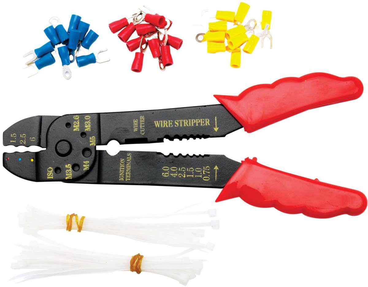

            Duncan,
            If you used this type I’m not surprised, if you used a proper ratchet one then the wire should be a snug fit in the terminal to start with for the crimp to work as Nigel above. wmr-1483_xl

                On Dave Halford Said:
                Duncan,
                If you used this type I’m not surprised…wmr-1483_xl
                Agreed, and some examples are worse than others – too cheap!  And even the best need the operator to have a strong grip.   The ratchet type are much better.
                The other cause of loose wires, blush, is that the pliers were used upside down.   Seemed obvious to me that the bumpy side of the pliers should be applied to the edges of the crimp, but I eventually noticed that this often folds the connector badly.  They fold better and crimp harder with the pliers the other way, so the rounded side supports the edges.  I’m pretty sure I was doing it wrong…

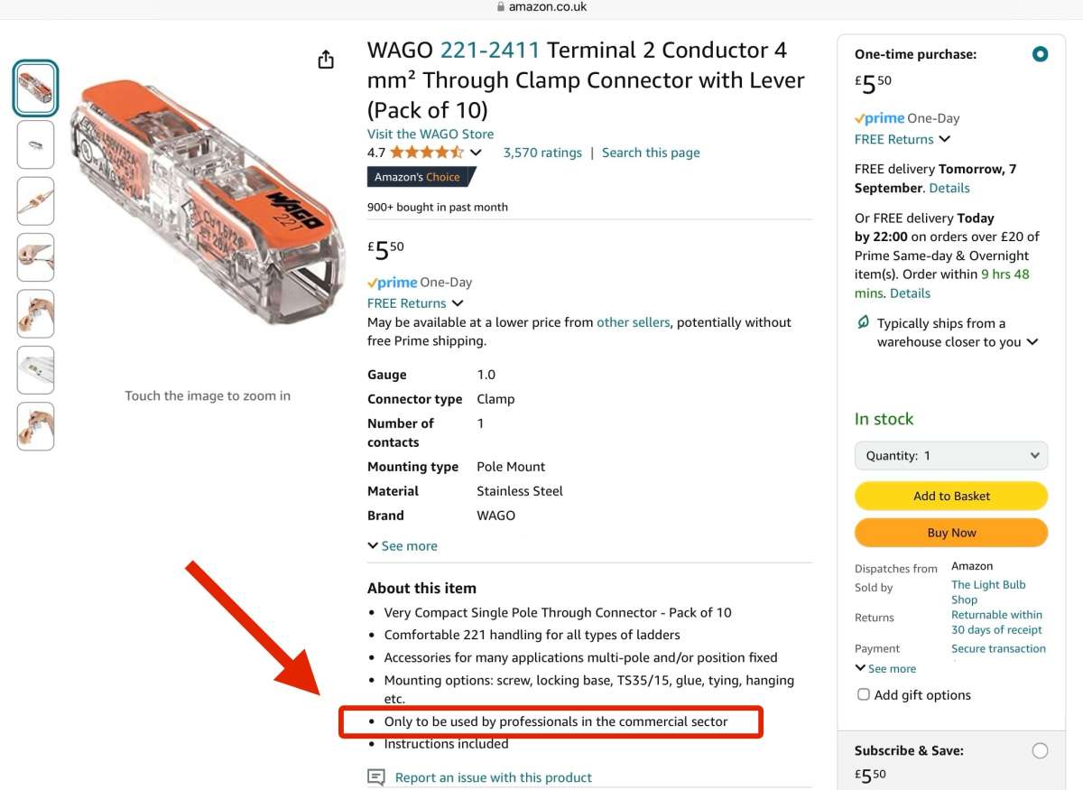

                      This is an interesting note in the description on Amazon.
                      IMG_1967

                        As the previous posts have said, use a better crimping tool and not the cheap one shown.
                        Video of how to crimp a terminal:  https://www.google.com/search?client=firefox-b-e&q=how+to+properly+crimp+a+wire#fpstate=ive&vld=cid:6e8f33fc,vid:WFvEeWHDt1E,st:188
                          Says more about Amazon than it does about Wago !!

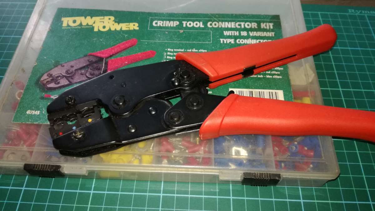

                            Hi, a decent crimp tool makes a good job, and I have a couple of the types shown by Dave Halford & SOD above, with mixed results, but I bought the one shown below many years ago, and has always made a good sound job. It wasn’t the cheapest of tools, but wasting a lot of failed crimp connectors isn’t cheap either.
                            IMG_20240906_071103#2
                            Regards Nick.
                                  If you buy items with a description like that it must trigger something in the system because I purchased some LED lamps on there described as not suitable for domestic use, shortly afterwards the emails started arriving asking if I wanted to open a commercial account.

                                    Those awful pressed steel “combi-tools” can – at a push – generate a satisfactory crimp if used properly.
                                    “Properly” in this case refers to making sure that sufficient closing pressure is applied and, to be fair to the tool manufacturer, they do have an indicator of when the correct pressure is applied. That is the two yellow arrows near the grips, whcih indicate surfaces that should touch when the the tool is closed onto a termianl. And note also that the tool has to be used twice on the terminal – once where the copper ferrule is inside the insulation near the connection end (eyelet, pin, Faston etc.) to make the electrical connection and secondly at the cable insulation side to close the plastic ferrule onto the insulation to form a strain relief.
                                    A ratcheting “full form” crimping tool does all the above in one operation – the tool won’t open untill it has been closed sufficiently to release the ratchet & the dies form the electrical connection and the insulation strain relief closure all at once.
