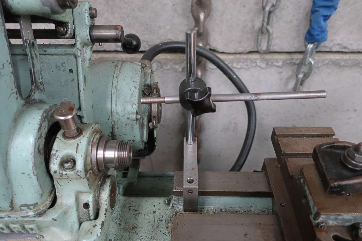

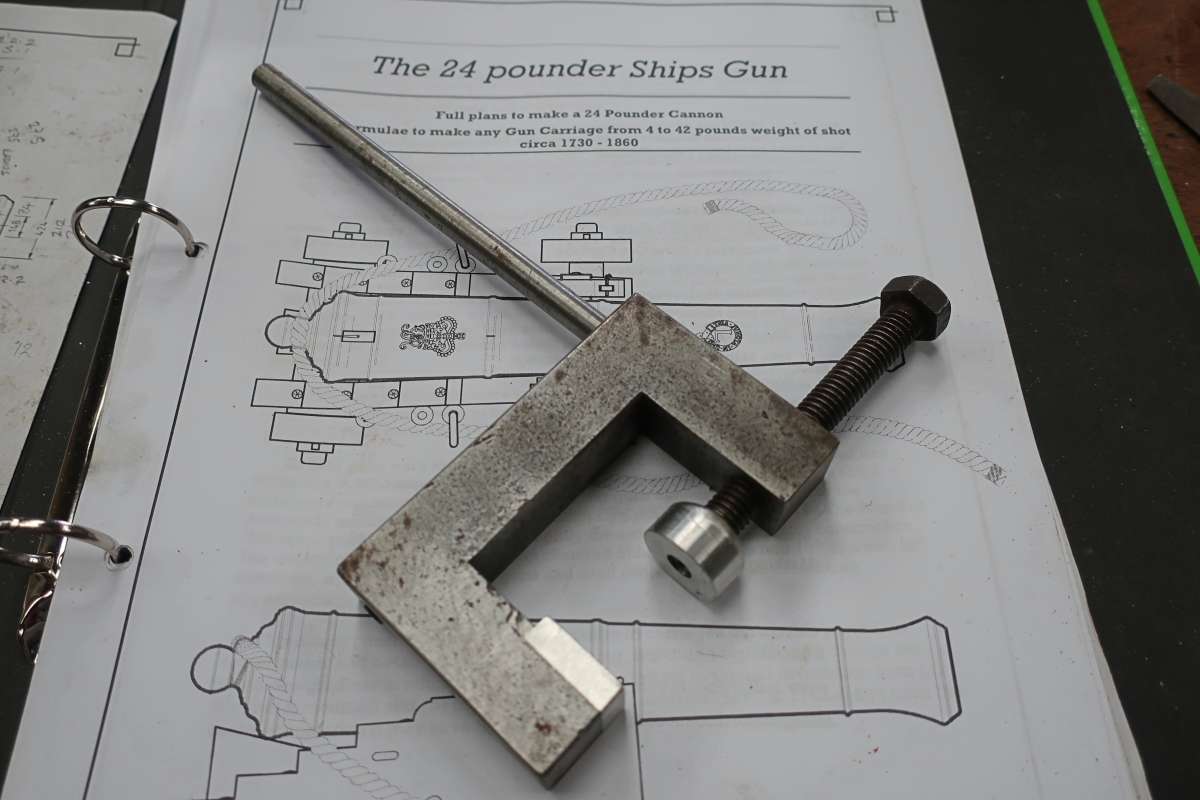

                              ..one of the most useful types of indicator holder for the ML is essentially a square-section ‘G’ clamp with holes on the sides and corners in which the ‘posts’ are held with set-screws….if I can’t find a picture online I’ll post one tomorrow..

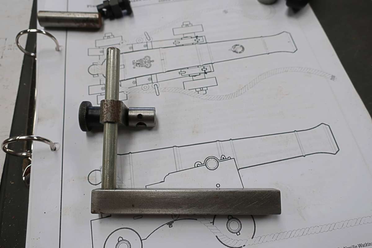

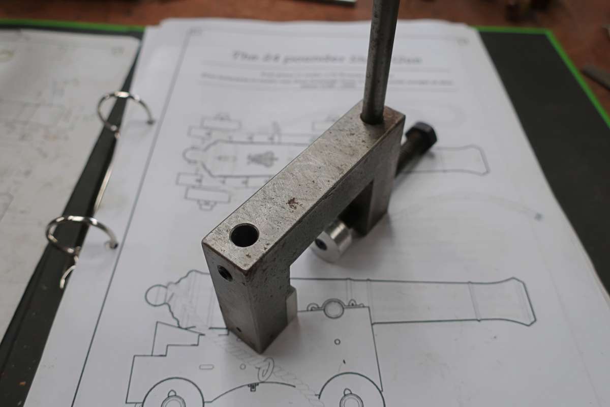

                                    A thing like this – if you can make it ‘square’ it makes it easier to drill extra holes should you need them in the future..
                                    IMG_2523IMG_2525
                                    This one gets quite a lot of use too..
                                    IMG_2526
                                    IMG_2528
