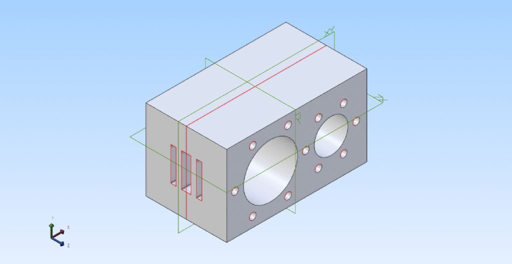

                                So I set out to draw my wagon's new cylinder block. I am not sure how much of Alibre Atom I've forgotten as I'd not touched the programme for at least six weeks; but I remembered I cannot grasp how to Assemble anything from two or more Parts if they are not already facing the right way and stay that way.
                                This 3D model is a single Part though.
                                All went well until one of the cylinder-cover stud holes fell off the edge.
                                Measuring the actual part-made block on the table next to the computer, I found I'd miscalculated the dimensions. So had to trim one end and stick some "metal" on the other, necessitating re-drawing the ports at that end.
                                It looks a bit of a mess, as the added bit, as an outwards extrusion, is not a true extension but turned out as a "glued-on" slice and slightly out-of-line. I'd also tried too hard with that mirror tool so created problems without saving time. The "long" way round where the experts would go the quick way, is the simpler and better one when you are not an expert.
                                I'll have to redraw this Alibre model from fresh if I want to produce working drawings from it. For I need make the block afresh as I'd "designed" all sort of strange traps in it, leading years later to it being too complicated with extra and too-narrow sealing-surfaces, stud-holes entering the passages, and the like.

                                      Then I spotted a plaintive little toolbar symbol gently flickering at me, and that revealed a system-change request that had not displayed fully. I chose "Yes" and we were away, with Alibre all replaced with new before the Ukrainian Freedom Orchestra had finished Beethoven's Ninth Symphony – complete with its Ode To Joy sung in their own language.
                                      So having carefully pencil-sketched with measurements the existing cylinder block, I could now draw a new version. I made a few odd slips and met a few difficulties, like trying to set the centres for the cover-stud holes, and that Symmetrical Constraint sometimes acting in ways I didn't want. Oh, and having to re-draw the ports completely when I realised I'd aligned both sets along instead of across the block!
                                      I am keen to make this area resemble the original as closely as I reasonably can, as the cylinders are so prominent. With the inverted-vertical engine between the seats, on full-size the cylinders were about level with the driver's chest.
                                      So with this established so far I can go on to work out the dispositions of the passages and the steam-chest studs, (I found the clue to solving their conflict, in one of Luker's locomotive drawings), the starting-valve, etc. I'm tempted to use WAD to help me work out the details. (W=wood!)
                                      So yer tiz:
