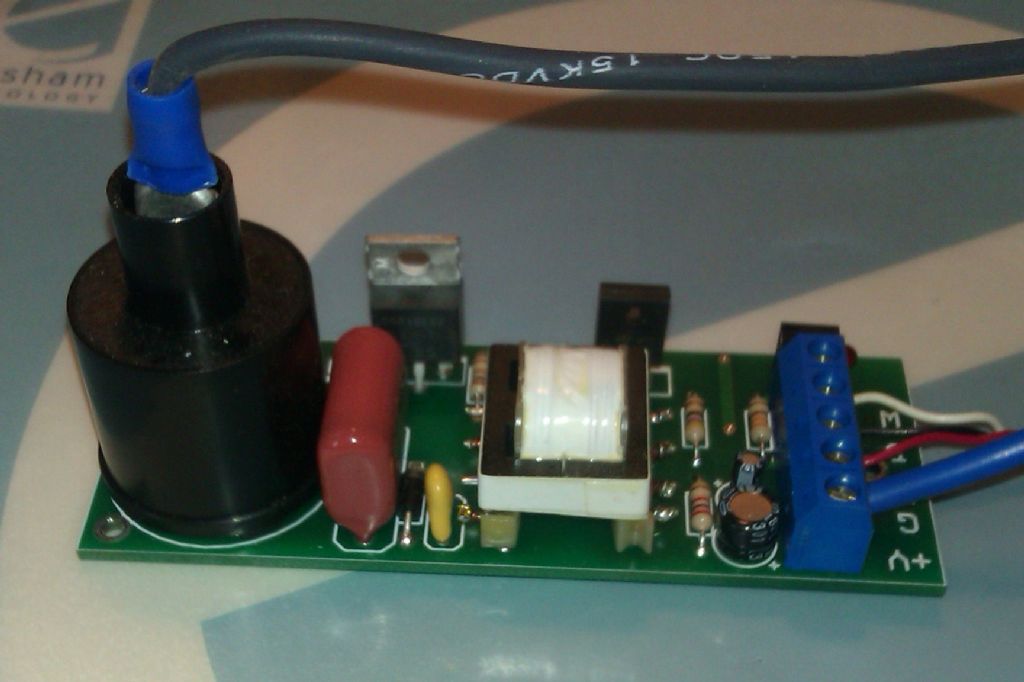

                                  The DCI units are quite common on model spark ignition engines, I have a couple of them that are triggered by a Hall Effect sensor though they can be made to work with points. There are also a lot of RC model 4 strokes that use them. These ones are quite good
                                  I didn't want to go down the CDI route with this engien as it has the scale timer & contacts plus adding a ring to take the magnet for teh hall effect would have spoilt the model.
                                  J

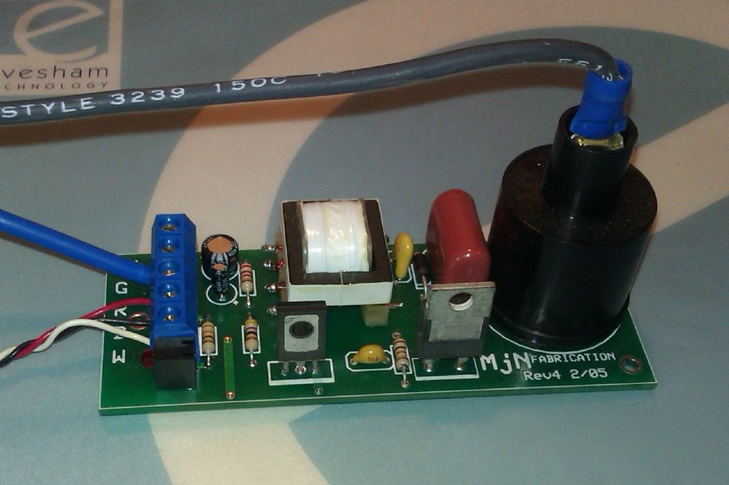

                                    #95216
                                      Andrew, here are a couple of photos of teh unit I got from MJN Fabrications in teh states, as its not in a case you can hopefully work out what does what. Black wire goes to plug, blue is ground and there is a positive terminal next to that for battery, the 3 small wires are the hall sensor. Click to get them bigger.
                                      J
                                      PS these units give a single spark unlike the buzz coil that gives a stream of sparks all the while that the timer is making the circuit so you get a much longer period of ignition.

                                      Anonymous
                                        Jason: Thanks for posting the pictures. As far as I can see the circuit is a pukka capacitor discharge ignition system. It's a pretty elegant piece of design; clearly done by somebody who knows his volts and amps.
                                        Here's an annotated copy of one of Jason's pictures, identifying the various parts:
                                        From the left, the input filter capacitors provide some filtering for the incoming DC supply. I assume that the LED indicates when firing occurs. One of the resistors marked 'Rs' is probably associated with the LED as a current limit. Together the transistor and transformer make what I assume is a blocking oscillator. This uses an auxilliary winding on the transformer to provide the positive feedback necessary to create an oscillator. One of the resistors 'Rs' will be to initially kick start the oscillator when power is applied. The transformer will have a third, step up, winding to provide a high voltage AC output. This is rectfied by the diode and feeds the high voltage capacitor with DC. I assume that the small yellow filter capacitor near the high voltage capacitor is to control RF emissions. The coil is obvious, and the SCR (silicon controlled rectifier) is triggered to complete the circuit, discharging the high voltage capacitor into the coil. I assume that the SCR is a logic level device, and can be driven direct from the hall effect sensor. The resistor and capacitor 'RC- gate' are to provide a pull down on the SCR gate to ensure no mis-triggering, or triggering on noise, of the SCR. All in all a pretty neat circuit.
                                        Here's an interesting link detailing the pros and cons of CDI. **LINK**

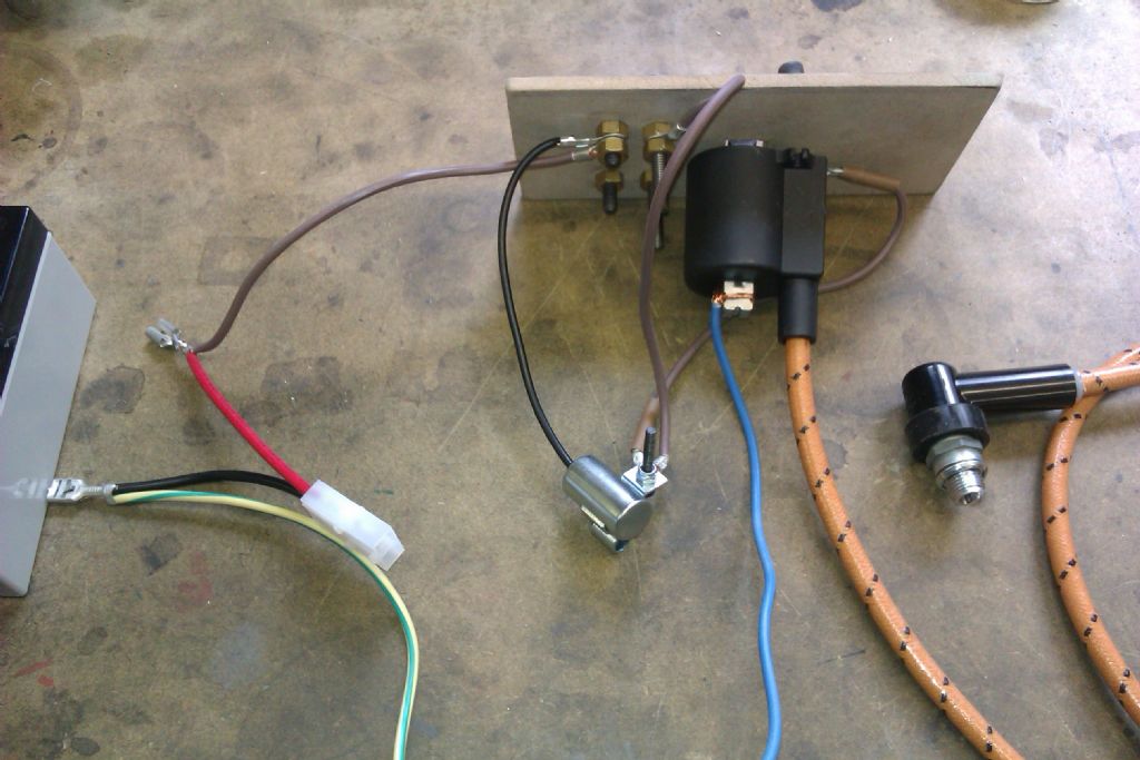

                                                    IT's BUZZZZZZINGnerd
                                                    Just did a rough and ready lash up to see if it worked and I'm just touching the negative battery terminal with teh wire to simulate the timer on the engine which is basically a switch on the geared down side shaft that drives the cam.
                                                    I'll post some pics later but that will have to wait until the F1 and ladies road race have finished
                                                    #95352

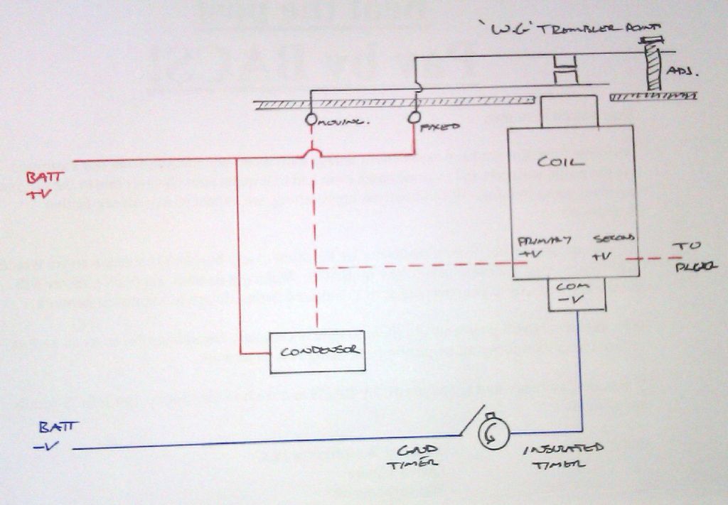

                                                      As promised this is how I made the plug spark, all a bit rough and ready but at least I know it works so can now condense it all down to fit into a nice little wooden box. Green goes to the grounded timer contact on the engine and blue to the insulated contact.
                                                      This is the scematic of what connects to what. I will also add a switch into the positive feed from the battery so it can easily be turned off and there is no risk of it starting to buzz unintensionally if the timer on the engine makes contact.
                                                      Parts used
                                                      6V sealed lead acid battery from e-bay inc charger and RC type socket
                                                      Condenser from Tecumseh mower again e-bay chose this as B&S didn't have the wire fitted
                                                      WG trembler coil points from Engineers Emporium ref TCP1
                                                      12V Mini HT coil again from Engineers Emporium but plenty on the net, just get one with the soft iron core through it.
                                                      Braided & lacquered HT cable and Plug Cap Green Sparkplug Co
                                                      If anybody knows a source for the braided and lacquered HT cable in sizes smaller than the standard 7mm please let me know, plenty of smaller PVC about but can't find braided.
                                                      J
                                                      Edited By JasonB on 29/07/2012 17:47:53
