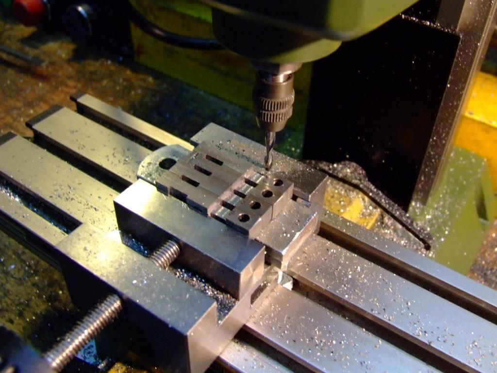

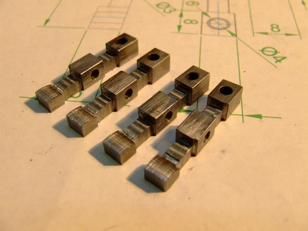

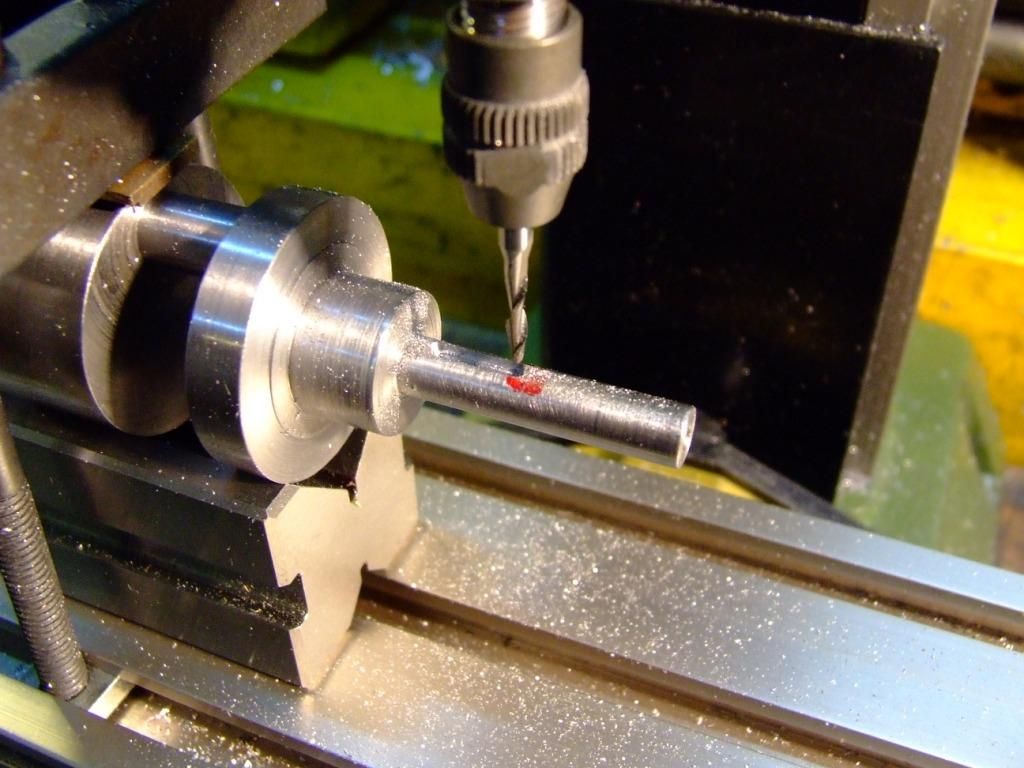

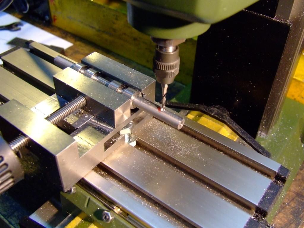

                                      Roger B
                                        @rogerb61624
                                        As ever show and tell. These rocker arms were milled from 6mm square silver steel with a Proxxon 3mm end mill. The 2mm keyseats in a medium carbon steel crankshaft (ST50 maybe similar to EN8) and a silver steel camshaft were cut with a Proxxon 2mm end mill.
                                        #543341
                                        Andy Carlson
                                          @andycarlson18141
                                          Nice work Roger.
                                          FWIW I've also cut a 1mm screwdriver slot in a broken high tensile bolt using the MF70. TBH I wasnt expecting this to succeed but I really needed to get the broken part out. Anyway… it worked and I got the bolt out.

                                                I was using the Proxxon cutters, the 2mm cutter for the keyways was probably run at around 10 000 rpm with the feed as fast as I could turn the handle. The 3mm cutter for the rocker arms was probably run at around 8 000rpm with a slightly more gentle feed. No lubricant was used.
