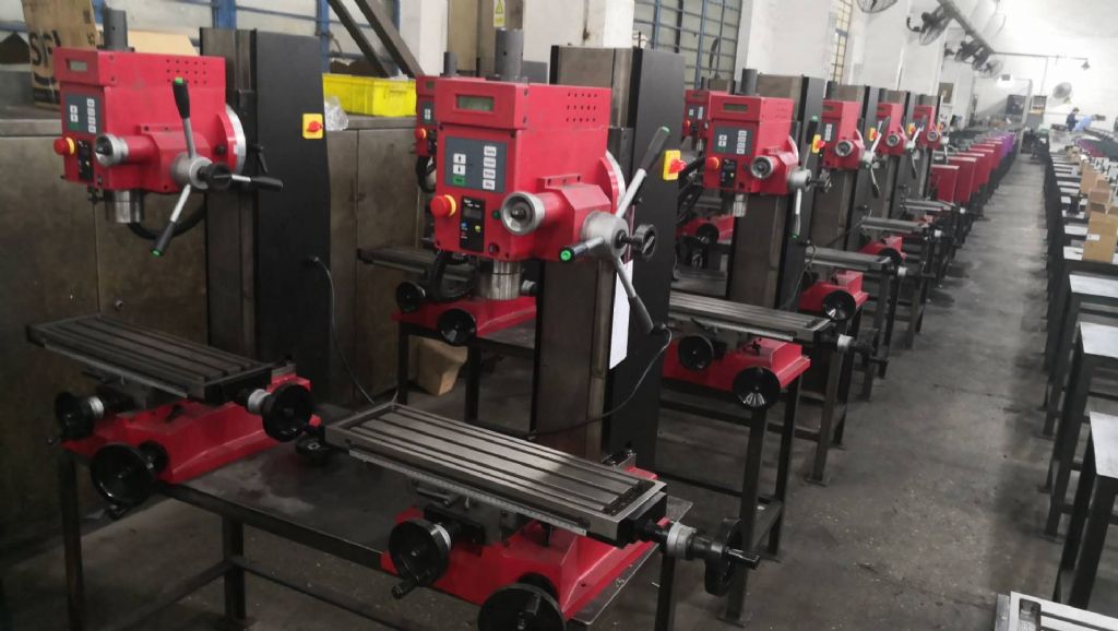

Todays virtual factory meeting was about delay in shipments and deliveries. This picture was provided to me a few hours ago to show that they can only send out 10 pcs of SX3.. which are expected to be ready for shipment by end of this month, as part of a larger order for various machines and accessories. Then we will be fighting for vessel space. Funny what they churned out since your last picture
The container with the next batch of SX3.5's finally left on vessel MSC MIA on 4th May, and expected to arrive Felixstowe on or around 2nd June 2020… hopefully… with a little prayer, a song and a dance.

Hi Steve,
In the U.K., SIEG sells to Axminster, ARC. There are different models in SIEGs range, all of which can be seen on SIEGs site: http://www.siegind.com
Axminster sells a bigger range of SIEG machines than ARC. Currently SX2P is exclusive to ARC, but Axminster has a variant, and at present SX3.5DZP is only sold by ARC in the U.K.. Axminster may or may not sell these or their variant in the future, which is up to them to decide.
Chester, Clarke/Machine Mart, Sealey/Draper sell some of the 'base level models' under their own brands.
Complaints will always be there – be it SIEG or any other make machines. SIEG is not necessarily a saint, and nor is ARC. ARC only sells SIEG machines because we only want to deal with one set of gremlins, and we have a close relationship with the factory. Just because something is made by SIEG doesn't mean that it is 'special'. Reasons for these complaints are variable:
