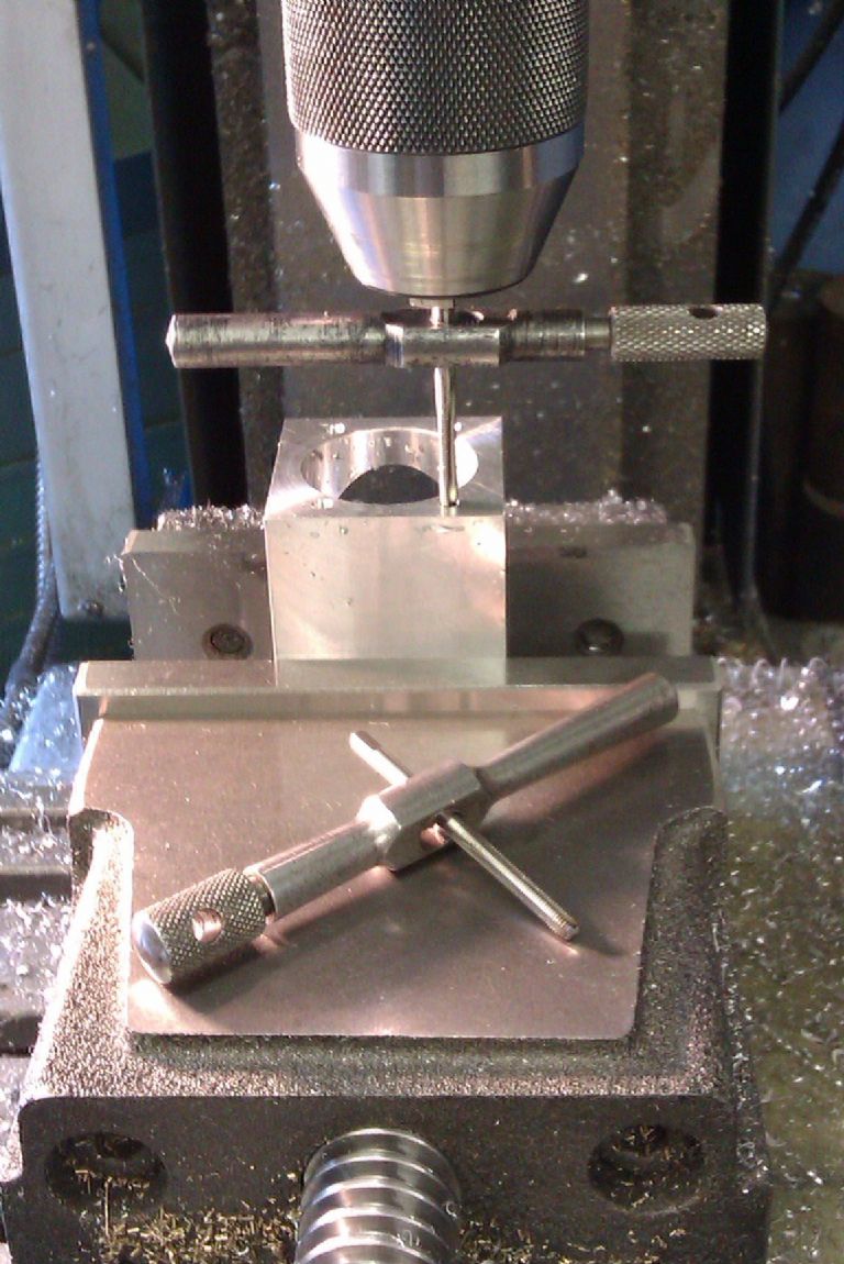

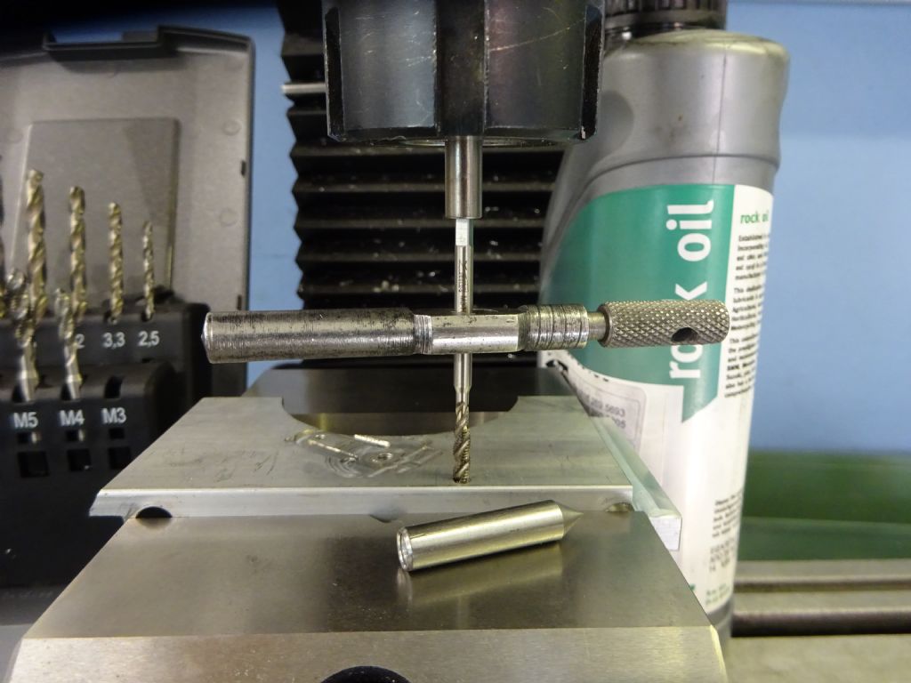

                                          My Mill/Drill has a round column, so the head is locked very firmly before doing any machining.
                                          The easiest way to break a tap is to bend it whilst in use. (OK, you do get the odd dud! )
                                          To my shame, I broke a M10 tap, and later a M3.5, both through sheer operator error!
                                          For tapping off machine, wherever possible, I use a tapping fixture (mine started life as the pillar for a pistol drill )
                                          Think G H Thomas pillar tool, or the tool offered by ARC.
                                          The tap is held in a 3/8 capacity drill chuck, and the handle, to limit torque, is a short length of 6mm x 2 mm injection pipe.
                                          The tap is presented square to the work, in a small vice, and is not subjected to bending.
                                          So inviting trouble; tap breakages are rare.
                                          But why ALWAYS in the last hole on the final operation?
                                          Newton's Fourth law, perhaps.
                                          Howard

                                                Posted by MC Black 2 on 06/05/2020 13:19:23:
                                                Will a Drill Chuck, with – I presume – three "jaws", grip a tap that has a square end? My gut feeling is that it will not.
                                                It can [and often does in my case] grip the round shank.
                                                Once the tap has been started nice & square, its a simple matter to transfer to the normal wrench.
                                                #469579
                                                  You grip by the remaining round shank, either tightly if using something like teh GHT or you can simply bring the chuck down around the tap and just nip up the jaws so they rub on the round shank of the tap and then drive the tap with the tap whench also around the round shank, this has the added advantage that teh tap wrench will often slip before you put too much force into the tap.
                                                  Firefly14
                                                  The latter method is best done straight after drilling the hole while the drill/mills spindle is directly above the hole which gives perfect allignment. Myself I tend to just use a short length of silver steel with a 60deg point turned on one end and a ctr drill hole in the other, this is held in teh drill or collet chuck and the end either goes into a ctr hole on th e end of teh tap if it has one or the chamfered square end of teh tap sits into the ctr drilled hole. To use just apply gentle pressure on teh quill lever easing off whenever you back off the tap which as above is driven by a tap wrench around the round shank
                                                  #469584
                                                  Howard Lewis
                                                    @howardlewis46836
                                                    MCB 2
                                                    My apologies.
                                                    I relied on my memory. The #10 catalogue showed such an item, but #11 does not seem to.
                                                    Such an tool can be made easily. What is needed is a base with a vertical pillar, and an arm that can slide up and down the pillar, and be locked to it. The outer end of the arm has a bearing / bush through which passes a spindle carrying a drill chuck on the lower end, and a handwheel on the upper end. The spindle is capable of sliding through the arm
                                                    The pillar should be "square" to the base, and the two holes through the arm should be parallel to each other.
                                                    The drill chuck, having three jaws, grips the round shank of the tap, not the square. This should keep the tap square to the job, and as the tap cuts into the work, the spindle slides through the arm. The handwheel, or short arms of the handle, limit the torque that can be applied. If the tap sticks for any reason, the probability is that it will slip in the chuck jaws, before reaching the point of breaking. being manual, you will have a feel for what is going on.
