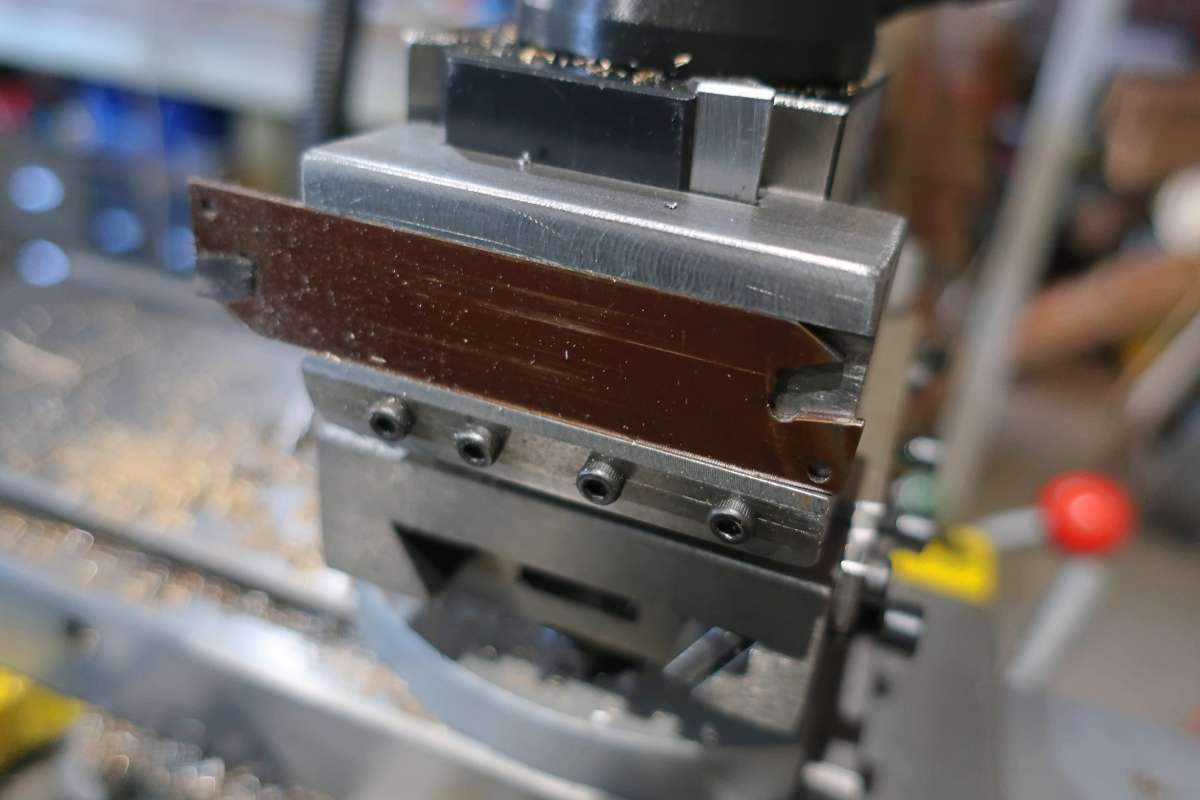

            I have an AXA copy with a couple of home-made p/off holders, I will post if I can find a picture.
            I part from the front on GH600, don’t really have any issues.

              GTN blade 100 Toolpost
              ..note special screw spacing, er, to avoid, um resonance issues.
