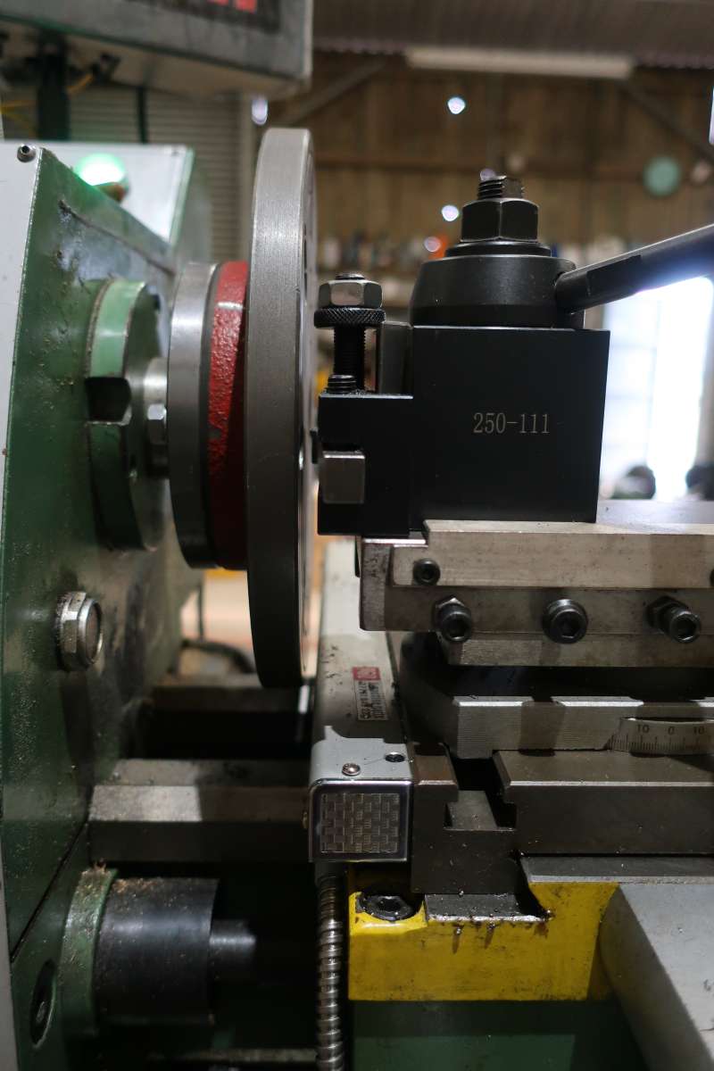

                        #758704
                        Volans
                          @volans
                          It’s a GH600 – a Chinese import sold by Warco. Generally I am fairly impressed with it, except I think that the backlash could be improved considering todays technology. Also the manual is appalling even for a Chinglish one, it even warns at the beginning that the instructions may be different to the variant supplied! & yes you have guessed correctly. 🙁 .
                          Not the machines fault, the long and cross travel handwheels are transposed to my old ML7 which after 20 years of use is causing a few minor mishaps I’ve removed the cross travel handle which has helped .
                          Right I will now purchase an AXA and, if I can remember, post the results.
                          Thanks all.
                          #758908
                          Diogenes
                            @diogenes
                            My lathe is a GH600; I use a ‘100’ / AXA toolpost, no problems. The centre height of mine is (er..) 24-ish mm over the top slide.

                            #758979
                            Diogenes
                              @diogenes
                              Filled with a vague sense of nagging doubt, I went over this afternoon, turned a piece of steel and checked the daylight between the bottom of that and the topslide by inserting parallels and shimstock.
                              Everything was mic’ed and sums done – centre height on mine seems somewhere between 23.010 and 23.020mm as discerned with the equipment I had to hand.
                              I also realised that some of my 12mm tools have been skimmed; I’d forgotten that I’d done this, think it was one Saturday morning ages ago when I discovered that some ’12mm’ Glanze tools were actually on 1/2″ shanks.
                              Most 12mm insert tooling is a bit ‘touch & go’ whether you will be on C/H or not; 1/2″ HSS is likely to sit too high..

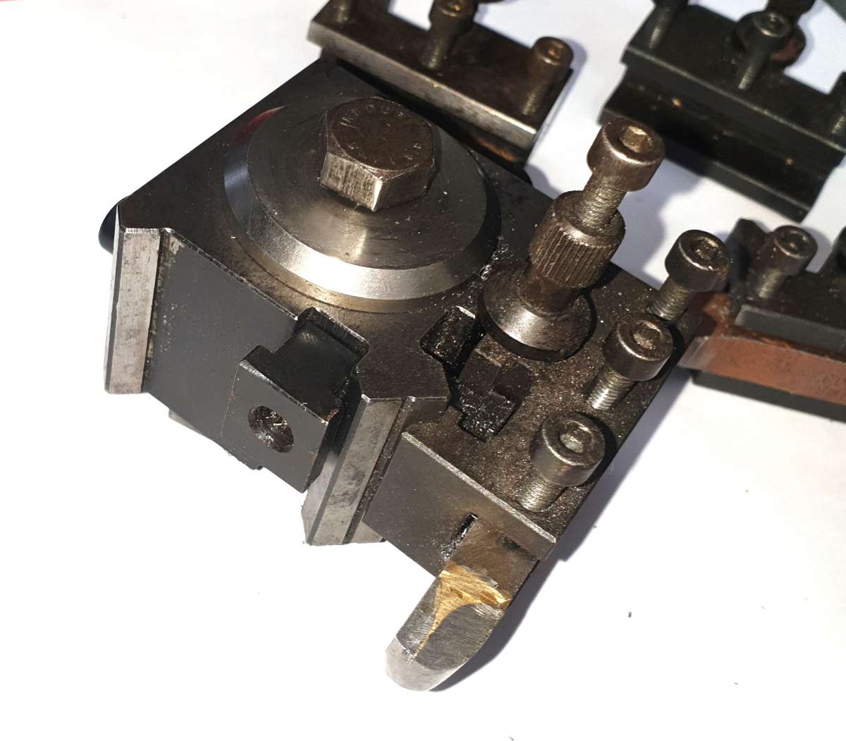

                                              mark smith 20
                                                @marksmith20
                                                Whats the general consensus on this type that came with my southbend 9A, its made by emco, i assume it had a proper lever handle on top originally but dont know. The mainblock is 55mm square x 40 high.

                                                Clive Foster
                                                  @clivefoster55965
                                                  Mark
                                                  On initial examination it looks to kinematically be a Dickson type but the offset T-nut style clamp spoils things. As the clamp is operated by a cap head screw rather than a cam device it should be able to go tighter theoretically improving security.
                                                  However the whole point of the Dickson double Vee kinematics is that it will always be able to find a stable line and point or two points and a line contact on oppositely distributed between the pair of Vees. Which isn’t how tis toolpost works.
                                                  Considering the Dickson first it should be noted that, country to popular opinion, the paired Vee system isn’t over constrained in practice. It simply takes up the first available dynamically stable point and line or two points and line contact. Over constraint requires impossible levels of manufacturing accuracy. The advantage of this design is that stable seating requires only that the pair of Vees on any component be parallel and of constant depth / height given reasonably accurate spacing. The big disadvantage of the true Dickson is that tolerances on the toolpost T-slot, locking T and locking cam need to be very tight if turning the cam is to produce sufficient holding force. Hard to hold the tolerances at affordable import prices.
                                                  The offset T-nut of the Enco system destroys the Dickson kinematic balance. For all practical purposes it exploits only the inner sides of the Vees on both tool holder and post. The clamping force pushes the two closest male and female inner Vee sides together whilst the remote inner Vee sides just stop things twisting out of control. All in all not vastly dissimilar to the the kinematics of a stationary tail wheel style aircraft sitting on the ground. Unless something is way out of tolerance the outer Vee faces are primarily guides to ensure its all goes together properly when the toolholder is put on.

                                                  #762868
                                                  mark smith 20
                                                    @marksmith20
                                                    Thanks Clive for your detailed explaination. In use its solid enough but no boring bar holder.(use boring bar  in a standard 4 way  Roebuck toolpost that came with it as well ,also for thicker tool bits.). Having to use allen keys to tighten the toolholders is a bit of a pain ,when the key goes missing.
                                                    I havent found much info on this toolpost anywhere ,emco seems to have changed design frequently but all seem to be based on other common models of QCTP. Did find this on Niels machines.com.  But dimensions appear bigger. But has what is the proper top locking handle clamp unlike mine that has a plain bolt and oversized t nut underneath..

                                                    #762903
                                                    Macolm
                                                      @macolm
                                                      I never quite understood the concept of “over constrained” with respect to the Dickson. Does it mean achieving two side contact on both Vs? This is clearly unachievable in practice for the Dickson design. Or does it mean that any one of two or more stable possibilities will happen at random once clamped? OK, but hardly a useful feature in comparison to designs with a unique, precise and repeatable clamped position. I always felt that the Dickson design would be improved if the “second” V had a degree of flex, for example using well-chosen slotting, to ensure contact of both Vs.
                                                      Another feature I dislike is the cam actuation (though not unique to this design). At first sight it seems an attractive low cost actuator, but the mechanical advantage varies with the build up of tolerances, and the angular travel (and hence actuation travel) needs to be limited to prevent loosened by vibration. It ends up providing poor consistency and quite frequent malfunctions unless tolerances are sufficiently tight. The emco screw clamps at least provide constant mechanical advantage at the expense of fiddly tool changes.
