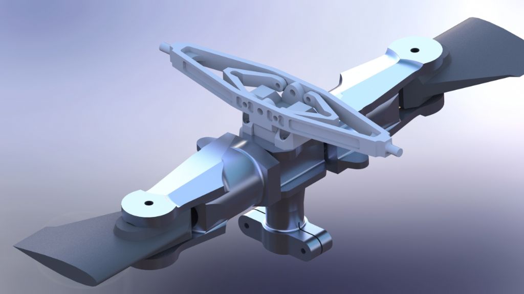

                          I didn't set a budget in stone but initially tried to keep the cost to below £1000. What I want to avoid is having to upgrade once I have progressed on to more advanced projects. I think trying to achieve good quality scale parts for RC helis may dictate a higher performing machine.
                          There has been some brands mentioned above that I have not yet looked in to so another evening of researching ahead!
                          First project would be prototyping my flybarless rotor head for a Vario Turbine Huey I`m building. Then quickly after that will be multirotor parts.
                          Huey Head
