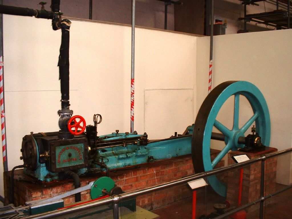

      Model loosely based on an engine at Abbey Pumping Station in Leicester:
      The base is milled from an alloy billet. Flywheel is 4 1/2″ for a sense of the size. I’m afraid the brickwork is a bit naff, in fact it’s all a bit rough –  many of the parts were rejects from my table engine, and as there was so nearly a complete engine there I thought why not?. Here’s the ‘prototype’:
